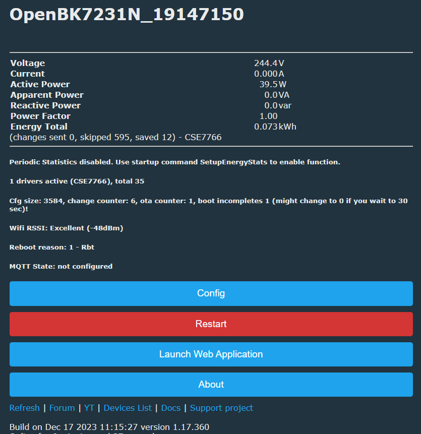

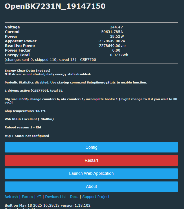

    hmm. not 100% sure of the current state of the CSE7766 driver. I have started with a Python simulator communicating with more-likely-to-work BK7231N.
    Using the logs here https://www.elektroda.com/rtvforum/topic4018338.html#20843887 to send an example 24 bytes from a real CSE we get the following displayed in latest OBK
    Screenshot of OpenBK web interface with energy readings for the CSE7766 driver.
    If you go back to December 2023 release with same simulation:
    OpenBK7231N control panel with energy readings, WiFi status, and configuration buttons.

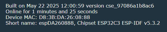

    yikes. a lot of artefacts now. worked though
    Display showing ESP32C3 device information: build date, online time, MAC address, name and ESP-IDF version.

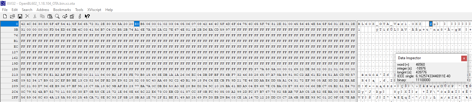

    Posts: 14756
    Rate: 12883
    I remember that I added OTA for BL602 to rest_interface.c some time ago. It's taking a header and a compressed stream.
    https://github.com/openshwprojects/OpenBK7231T_App/blob/main/src/httpserver/rest_interface.c
    Maybe ota_header_t struct could help? If it has uncompressed size... we could even settle for a soft check, on the Web App side.
    We would need to check is ota_header_t::len an uncompressed len or compressed? Let me open OpenBL602_1.18.104_OTA.bin.xz.ota in xvi32...
    Screenshot of the XVI32 hex editor with an open binary file and Data Inspector panel.
    Well it looks like compressed size to me. Maybe we could attempt decompress at web app level and check uncompressed size that way?
    Or maybe.. it's a xz format? Maybe it has some kind of header?

Why did PROTA match an OpenESP32C2 binary for an ESP32 device, and what was the substring bug that caused it?
PROTA matched the wrong image because its code used a substring search with Contains. That made names like ESP32S2 or ESP32C2 match a generic ESP32 target first, so an ESP32 device could receive OpenESP32C2_cse_97086a1b8ac6.img. The maintainer later confirmed the bug and added a fix for that substring behavior. [#21557206]
How can you simulate a CSE7759B/CSE7766 UART data stream with Python to test the OpenBeken driver on a dev board?
Send a known 24-byte packet from a real CSE log through a USB-UART adapter into a dev board. The tester built a Python simulator, targeted BK7231N first, and reused bytes captured from an earlier real-device log to compare current and December 2023 OpenBeken behavior. This isolates driver parsing from mains hardware and makes UART debugging repeatable. [#21556046]
CSE7759B vs CSE7761: what are the protocol and driver differences when testing Sonoff power-monitoring plugs?
The key difference is protocol compatibility. The thread states that the other Sonoff plug uses CSE7761, which has a different UART protocol from CSE7759B. That means a driver path or test method that works for one chip cannot be assumed to work for the other, especially while ESP32 UART receive support is still unstable. [#21556944]

What's the safest way to dump the original 4 MB flash from a Sonoff S60TPG before flashing OpenESP32C3 with esp-flasher or esptool?
Dump the full flash first with esptool and save the binary before any test image. Use this sequence:
  1. Enter download mode by grounding IO9.
  2. Verify security is off with get_security_info.
  3. Run read_flash 0x000000 0x400000 flash_dump.bin at 921600 baud. That captures the original 4 MB image, which gives you a clean rollback path if OTA or serial flashing fails. [#21555140]
