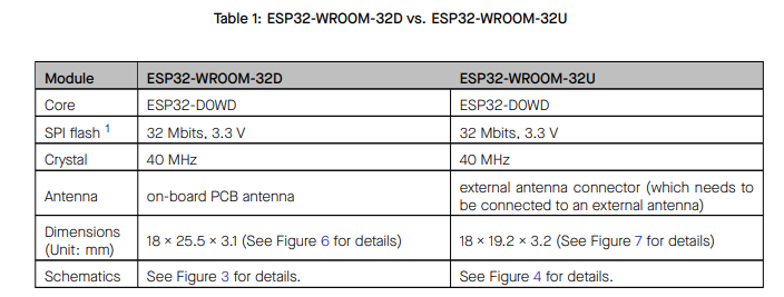

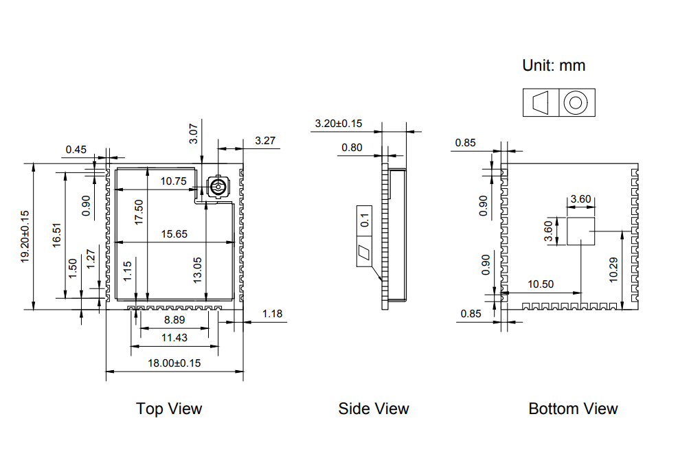

First, let's consider the case of the module itself - compare the ESP32-WROOM-32U and the ESP32-WROOM-32D.
Here the issue is simple. One module has a built-in antenna (on the PCB), it is intended for an external antenna - we simply have a connector, plug it in and we are done.

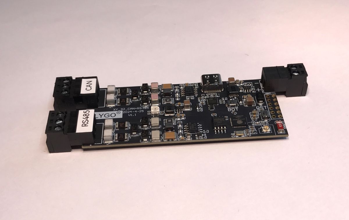

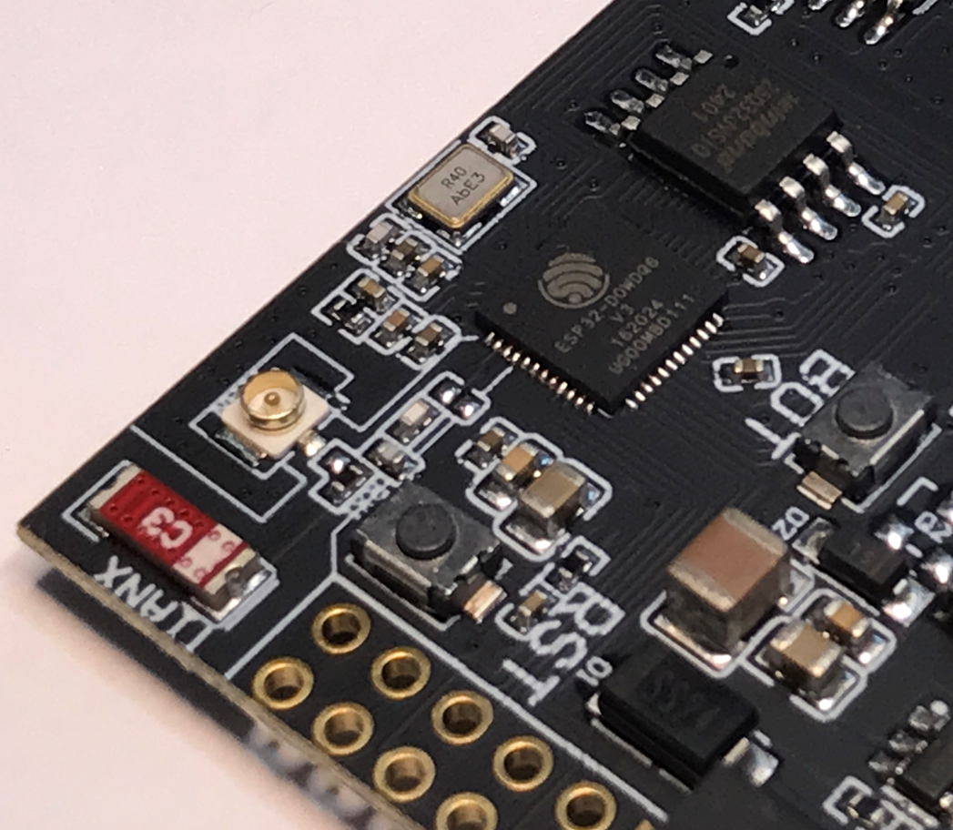

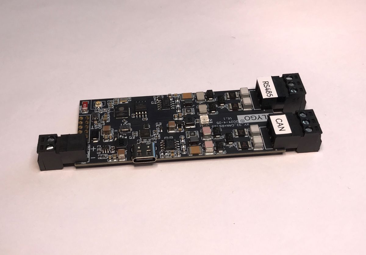

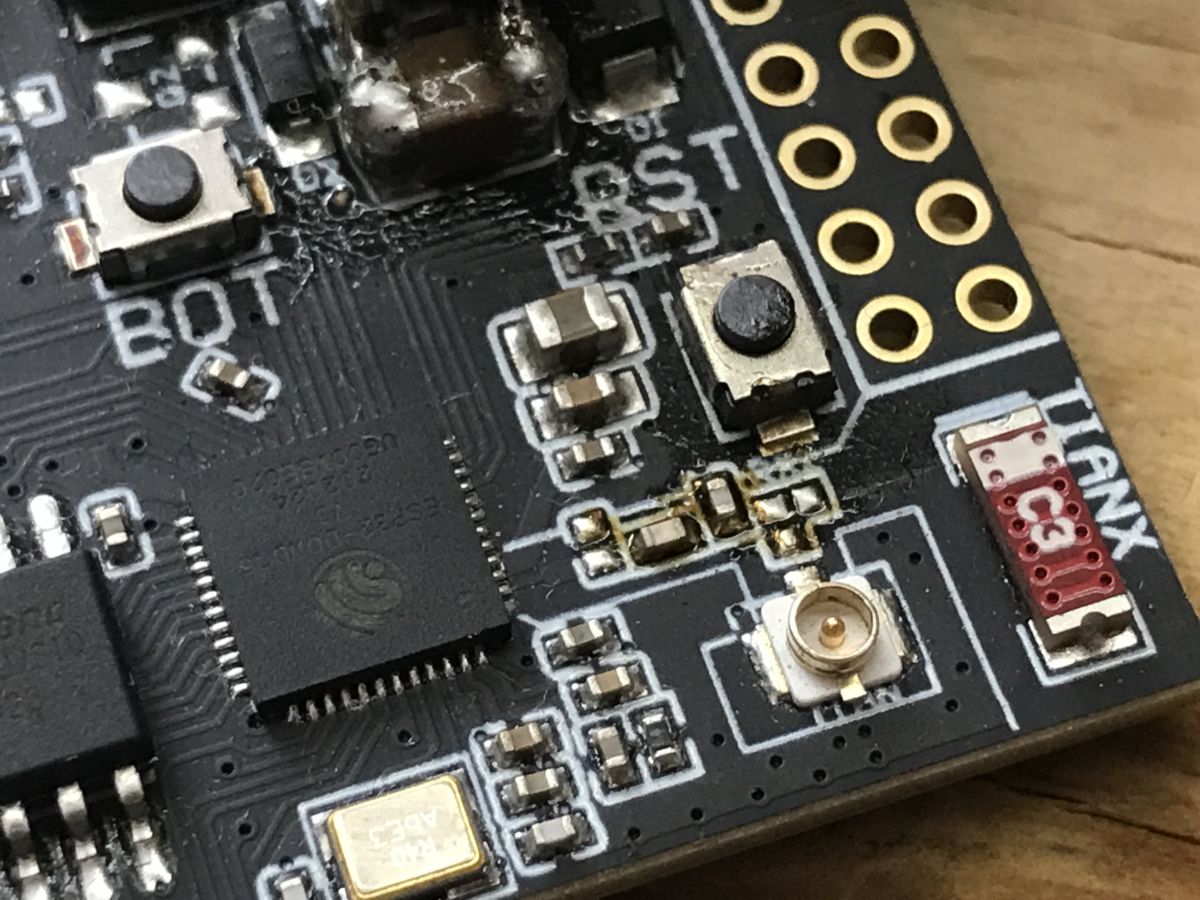

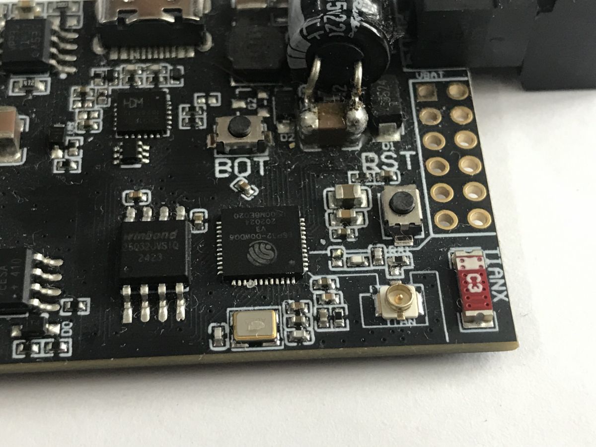

The matter becomes more complicated when it comes to boards that support two types of antenna. For example, the LilyGO T-CAN485.
Here we have the antenna located on the PCB and additionally, optionally, the IPEX connector:

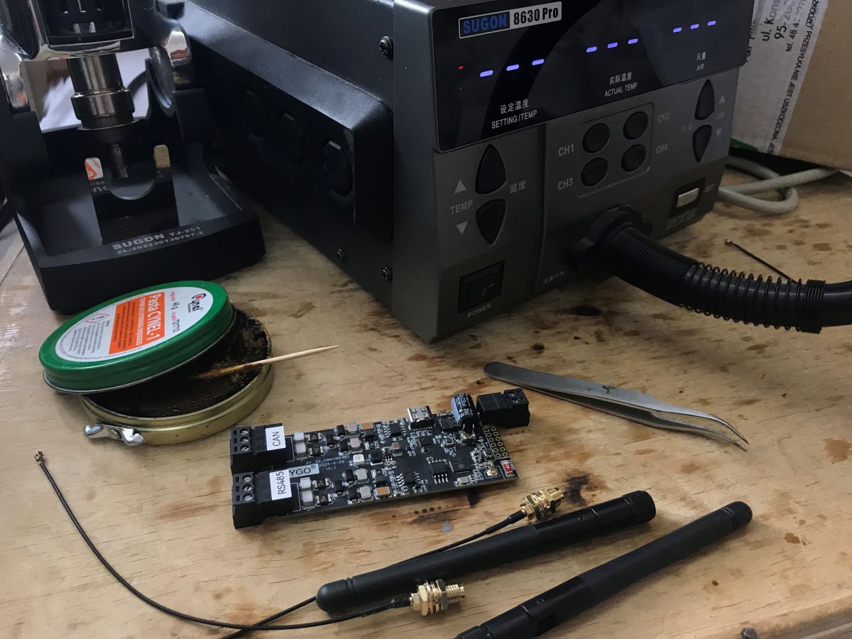

The active antenna is selected using a jumper - a resistor with negligible resistance.

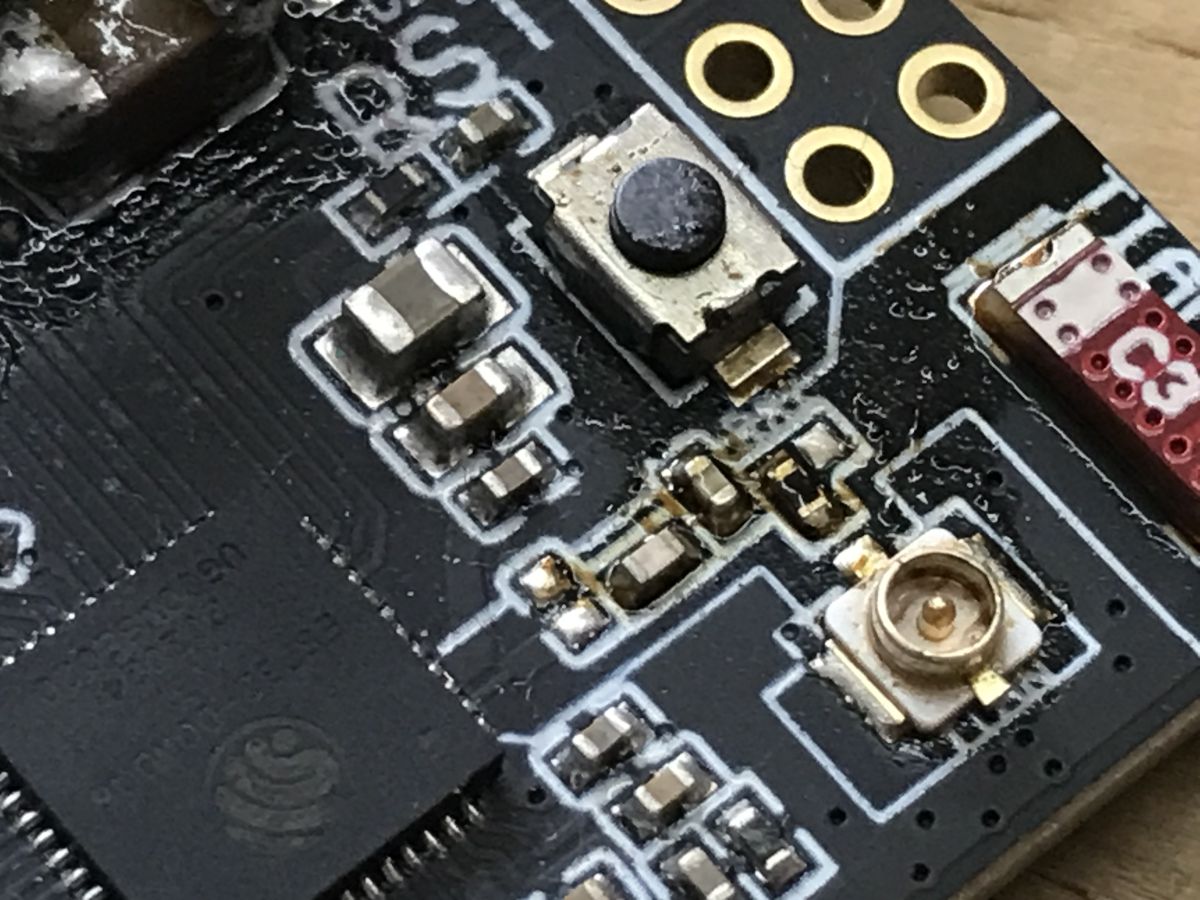

The easiest way to do this is using hot air, although a suitable soldering iron tip will also do the job. My method is to apply a little flux, choose a low blow and a relatively low temperature and heat the board, while gently trying to remove the resistor with tweezers.
Caution - such a resistor is easy to lose as well as to blow off, I recommend trying on the electrical junk beforehand. Only once you have become proficient can you operate on the board with the ESP.
Resistor removed:

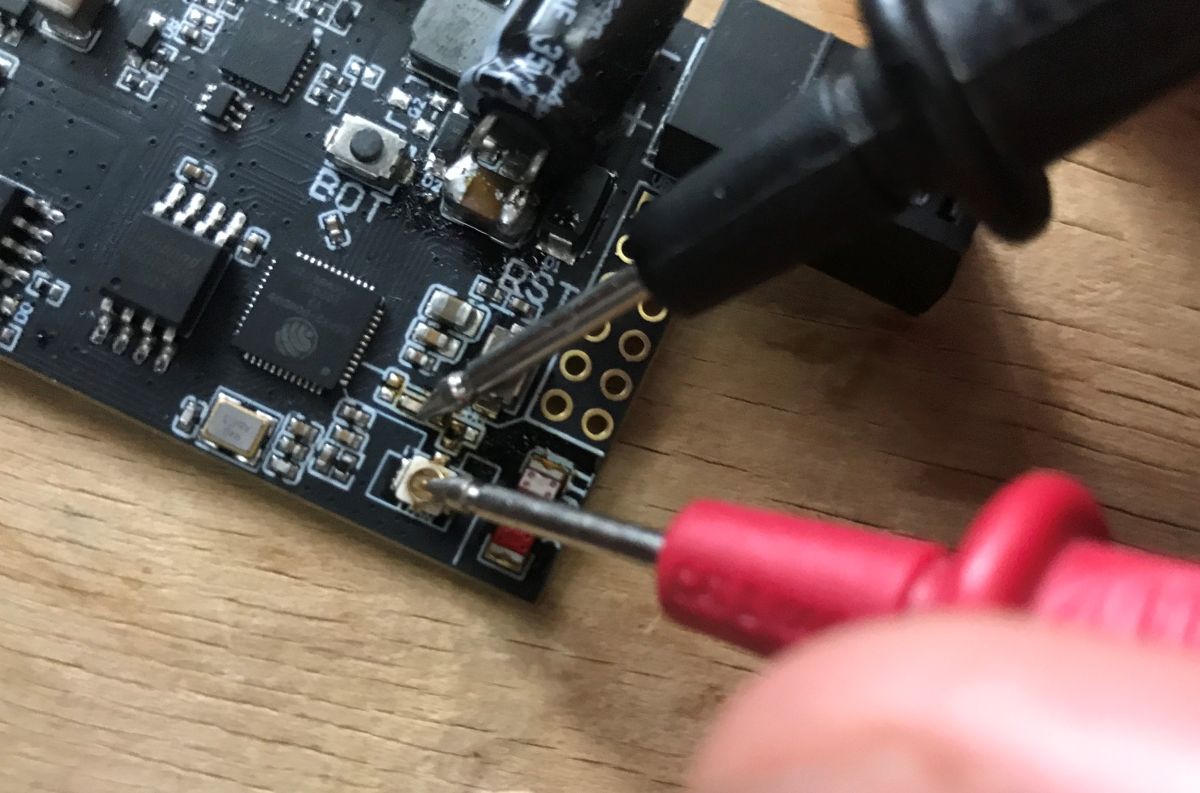

I also place the resistor in its new place using hot air. I only add flux, sometimes I also whiten the pads, although here it wasn't even necessary. I didn't even change the binder to lead.
Then a short test with a multimeter:

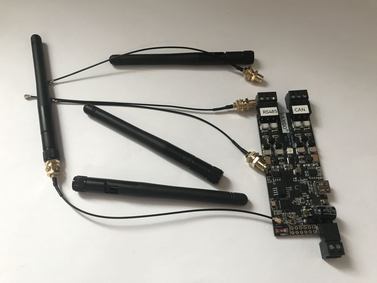

Then there's the question of what kind of antenna - in fact, something from an old router might even fit, but I bought a 2.4GHz WiFi antenna with 3 dBi gain offering an SMA connector with a U.FL connector adapter in the form of a cable. Less than PLN10 a piece.
Of course, the choice of antenna is quite a separate matter, it depends on the conditions and the intended use, we also have directional antennas available, among other things, but this I may try to explore in a separate topic.

Without an antenna, the results are abysmal, so if you solder something wrong, you will find out quickly. With a built-in antenna it's not too bad, but an external one is able to find more networks, and also provides a slightly better signal for those nearby networks too. Surprisingly a piece of wire also picks up quite well, I have also seen similar experiments on the web.

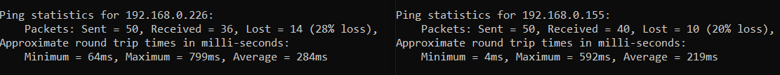

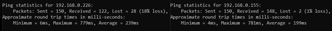

Ok, but that's just network visibility. What about the ping?
I've set up two Lilygo's at the other end of the flat - it's behind three walls to be exact (against the fourth wall). I tested a similar configuration before (without an external antenna) and for both ESPs I still saw lost pings, will anything change now?
Antenna placed on the table:
Antenna vertical:
It wasn't a big revelation in my case, but it did indeed help with package loss. The page loads a bit faster and there aren't those annoying 'hangs' as much as before, although the results still spontaneously change over time.
In summary , the range of the ESP32 can potentially be easily increased by adding an external antenna, but with many boards, however, you have to solder this resistor, which can be a problem for beginners. It may be better to pick up an antenna-ready board straight away without soldering, but this is not always an option.... in addition, the fun showed that maybe the DIY version of the antenna also makes sense, still as if the length was properly chosen, but that's for another time.
