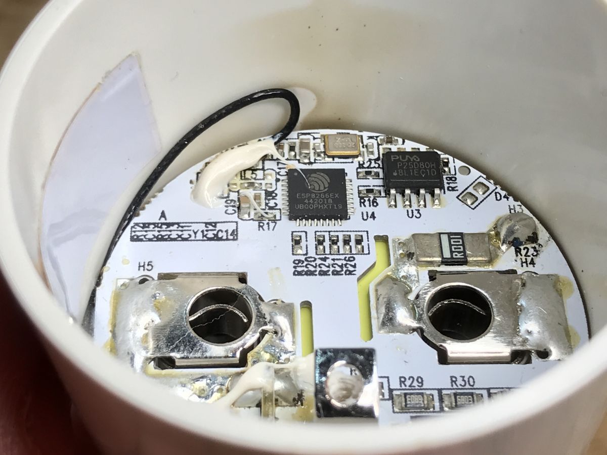

    I wonder what the difference in signal quality is between a socket with a WiFi module, such:
    Disassembled power socket with WiFi module and antenna on a wooden surface. .
    Source: Electrical socket with LSPA9 energy measurement - we program our own firmware

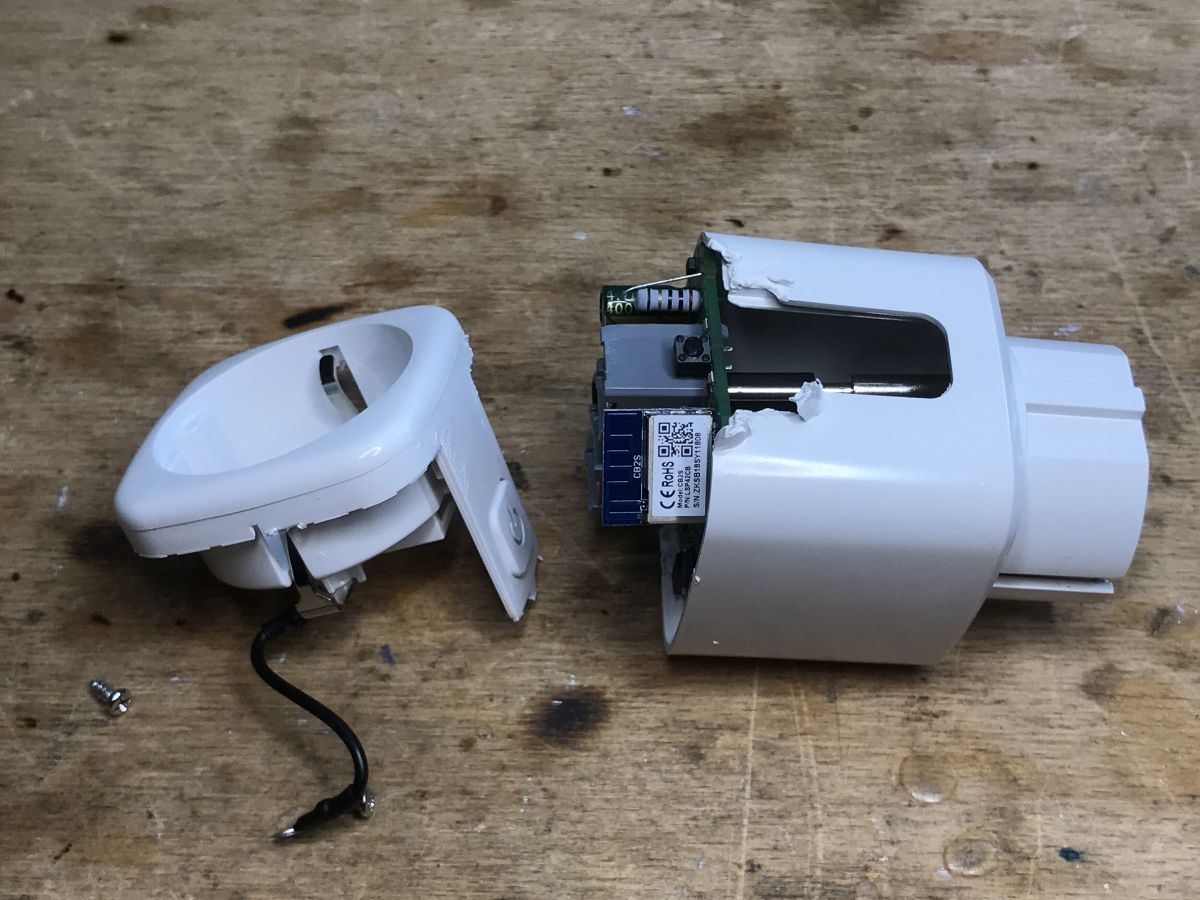

    and such (small external antenna):
    Close-up of a WiFi socket's interior showing a circuit board with a wire antenna and electronic components. .
    source: [ESP8266+BL0937] Old Neo Power Plug 16A, 2018, Tasmota, difficult access to pads .

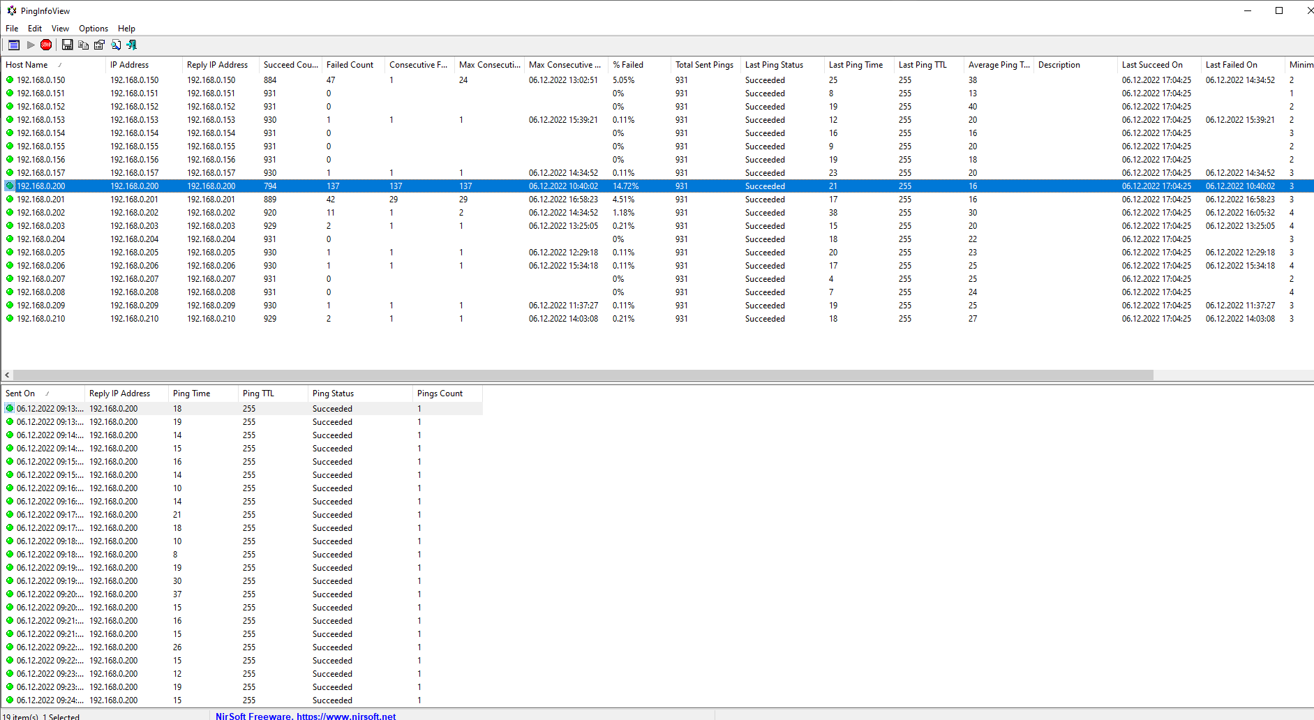

    By the way, once when I was changing to an Archer router I made an attempt to do a test on how much it increased my WiFi network efficiency, but in the end I didn't upload it to Elektroda. Here is a screenshot of PingInfoView, a potentially useful program:
    Screenshot of the PingInfoView program showing ping test results for several IP addresses on a local network. .

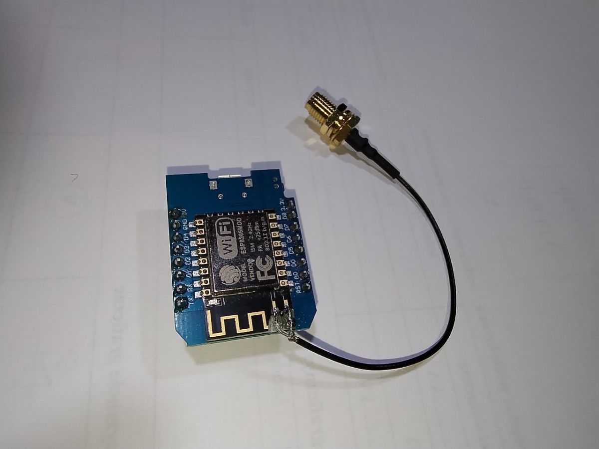

    I have seen people scrape off the soldermask, cut the antenna on the PCB and solder their own.
    Exactly right - I recommend this solution:
    ESP8266 module with a soldered antenna cable and SMA connector. .
    Just cut the antenna paths and solder in with a cable bought with the antenna for less than 3pln....
    Useful not only for increased range but also for mounting in a metal enclosure.
