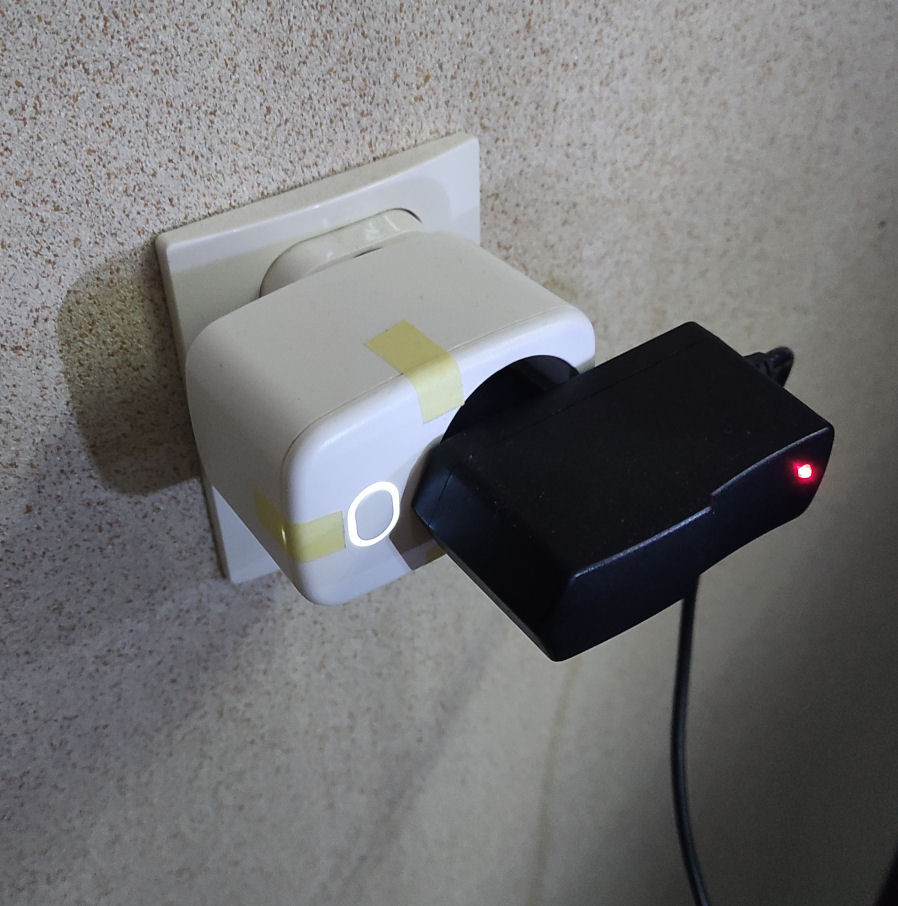

Only... you need a case for such an ESP, you need to power it, and besides, it could do more than just receive a telegram from the counter every now and then. So I came up with the idea of packing it all into a so-called smart socket.
It's off to work...
I once bought sockets in a different housing, larger than the popular ones from Ali: https://pl.aliexpress.com/item/1005006117762417.html
Inside it's the same, just a button and LEDs on the wires, so there's plenty of room.
The first thing I did after opening the case was to replace the capacitor on the low voltage side 470uF/10V, because the one that was because of the dimensions and increased current consumption after my modifications would not last long. HERE EXAMPLE .
I managed to stuff a slightly larger and more importantly polymeric one in there, soldered from some motherboard.
The second thing was to solder out the original module based on the Beken chip and replace it with an ESP8266. Although there are ready-made modules with ESP-02s, with the same output layout. However, their number was insufficient. The socket itself uses 6 pins (3x BL0937 chip, one each relay, button, led), to which the CC1101 module is another 6 pins. Not enough.
This left the use of the ESP-12F module, which I originally wanted to use to build this receiver. To start with, I programmed it with a basic version of ESPHome, so that I would be able to update it via OTA.
Then, using a kynar (a real one! with Teflon insulation!), I soldered it to the socket board. It has basically enough outputs. I write basically because they are quite cumbersome to use. You only have to look at the datasheet to see that this pin has to be in the low state during start-up, that one high, another one can't be used because the internal memory uses it. However, I managed to get the order right so that everything fit.
The only thing left to do was to look for some configuration of such a socket under ESPHome, fortunately there is plenty of it: https://devices.esphome.io/type/plug. After setting the right pins and uploading the software, the socket immediately started working correctly, only the calibration of the BL0937 voltage and current monitoring chip was required.
I then added the CC1101 to the ESP-12F. Here, I already used the same pin order as when trying with the Wemos D1 Mini. And after tacking one code to the other, I had both the socket operation in the program, along with the energy indication and the received values from the water meter.

I glued both additional boards to the casing with double-sided tape and the whole thing looks like this (ultimately the antenna is soldered in front of it though):
ESPHome integrates seamlessly over its own protocol with Home Assistant, so when I added such a creation I had the relevant entities straight away:
The page itself which ESPHome provides, on the other hand, looks like this:
The socket has now been alive for about three weeks. So far it has only been glued together with tape. Everything seems to be working properly. The only thing I have done in the meantime is to make small adjustments to the programme. The only drawback so far is the weak signal at the point of use, which means that not every counter telegram is received.
