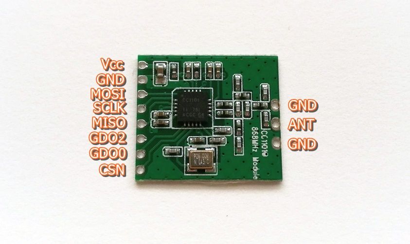

    So I looked for other solutions. I found the CC1101 module, which is also suitable for this purpose. Initially, I wanted to connect it to the Raspberry Pi Zero, which lives on in my house and, in fact, gets bored after switching to HA. However, I couldn't find any ready-made solutions, and I didn't really have the desire or skills to figure out how to get it working.
    For what it's worth, there are plenty of readymades for using such a module with ESPHome software and ESP series chips. Both the popular ESP8266 and the newer ESP32. Although ESP32 is recommended for this purpose because of its higher performance, I have had several ESP-12F modules based on this older ESP8266.
    The recessed socket, or the water meter receiver in a smart socket The recessed socket, or the water meter receiver in a smart socket .
    To start with, I soldered together the CC1101 module with the Wemos D1 Mini, which, because of its built-in TTL converter and USB port, is easy to program and therefore to test the code.

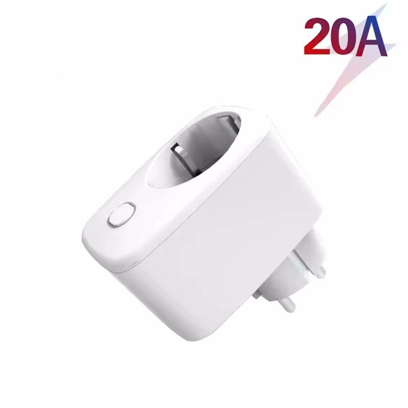

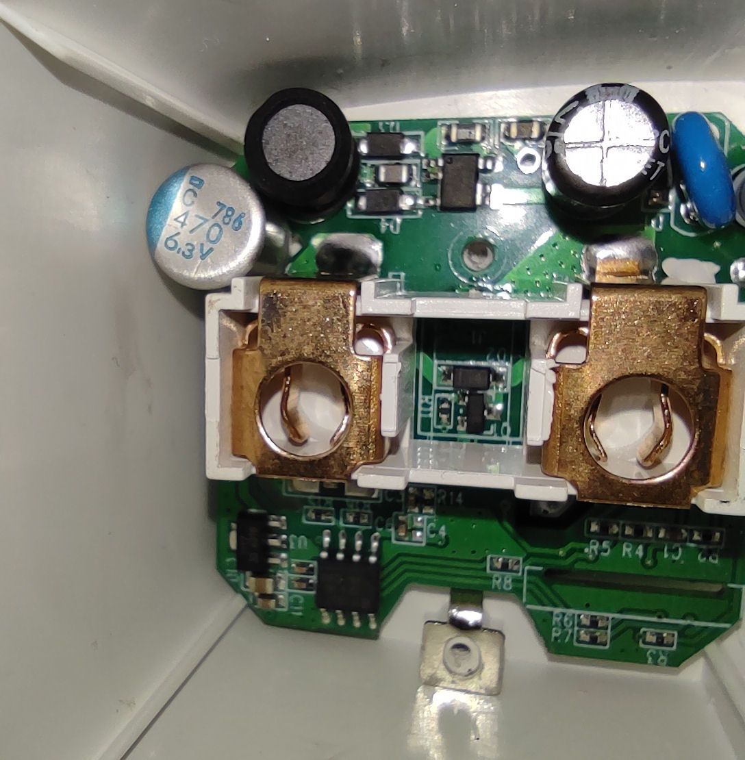

    I once bought sockets in a different housing, larger than the popular ones from Ali: https://pl.aliexpress.com/item/1005006117762417.html
    Inside it's the same, just a button and LEDs on the wires, so there's plenty of room.
    The first thing I did after opening the case was to replace the capacitor on the low voltage side 470uF/10V, because the one that was because of the dimensions and increased current consumption after my modifications would not last long. HERE EXAMPLE .
    I managed to stuff a slightly larger and more importantly polymeric one in there, soldered from some motherboard.

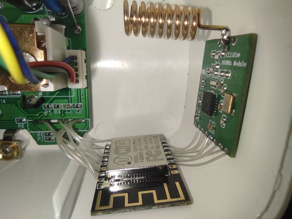

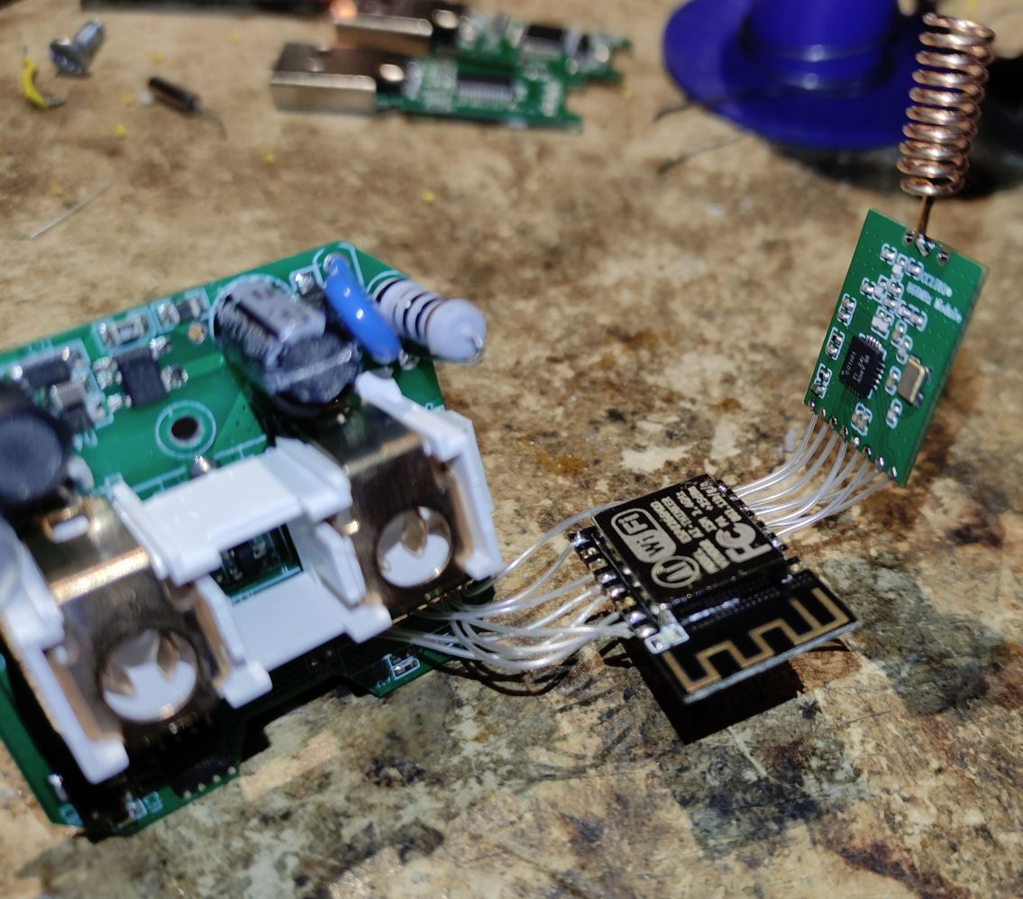

    The second thing was to solder out the original module based on the Beken chip and replace it with an ESP8266. Although there are ready-made modules with ESP-02s, with the same output layout. However, their number was insufficient. The socket itself uses 6 pins (3x BL0937 chip, one each relay, button, led), to which the CC1101 module is another 6 pins. Not enough.

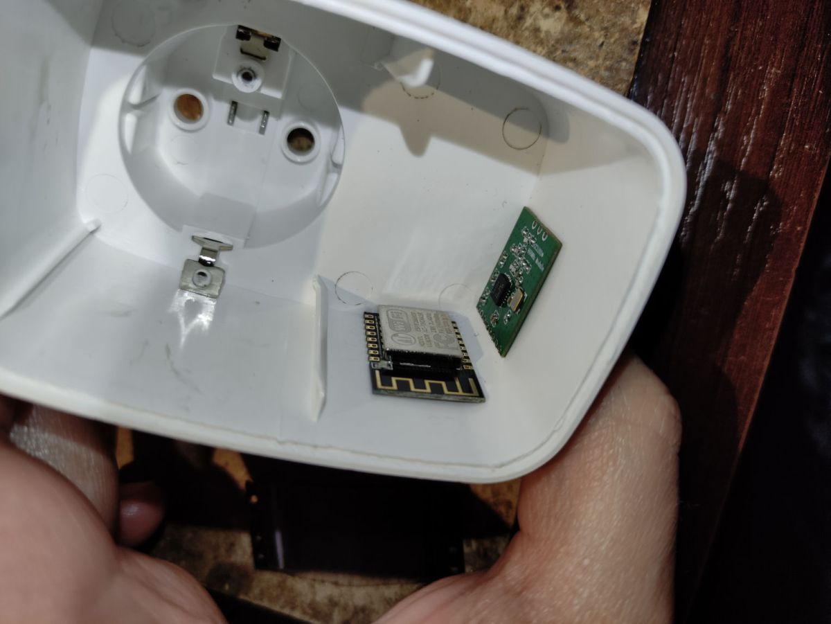

    This left the use of the ESP-12F module, which I originally wanted to use to build this receiver. To start with, I programmed it with a basic version of ESPHome, so that I would be able to update it via OTA.
    Then, using a kynar (a real one! with Teflon insulation!), I soldered it to the socket board. It has basically enough outputs. I write basically because they are quite cumbersome to use. You only have to look at the datasheet to see that this pin has to be in the low state during start-up, that one high, another one can't be used because the internal memory uses it. However, I managed to get the order right so that everything fit.

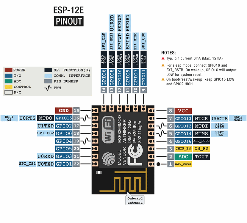

    The only thing left to do was to look for some configuration of such a socket under ESPHome, fortunately there is plenty of it: https://devices.esphome.io/type/plug. After setting the right pins and uploading the software, the socket immediately started working correctly, only the calibration of the BL0937 voltage and current monitoring chip was required.
    I then added the CC1101 to the ESP-12F. Here, I already used the same pin order as when trying with the Wemos D1 Mini. And after tacking one code to the other, I had both the socket operation in the program, along with the energy indication and the received values from the water meter.
    The order of pins used is therefore:
    GPIO13 - CC1101 mosi_pin
    GPIO12 - CC1101 miso_pin
    GPIO14 - CC1101 clk_pin
    GPIO15 - CC1101 cs_pin
    GPIO16 - CC1101 gdo2_pin
    GPIO10 - CC1101 gdo0_pin
    GPIO05 - BL0937 cf_pin
    GPIO03 - BL0937 cf1_pin
    GPIO00 - BL0937 sel_pin
    GPIO01 - przycisk
    GPIO04 - przekaźnik
    GPIO02 - status led
    I glued both additional boards to the casing with double-sided tape and the whole thing looks like this (ultimately the antenna is soldered in front of it though):

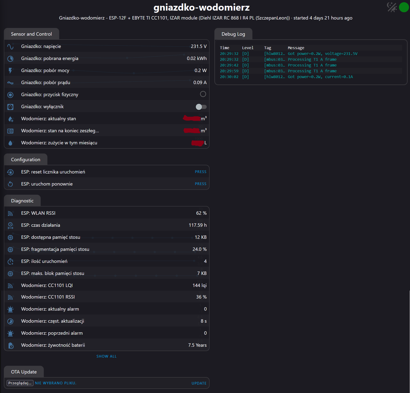

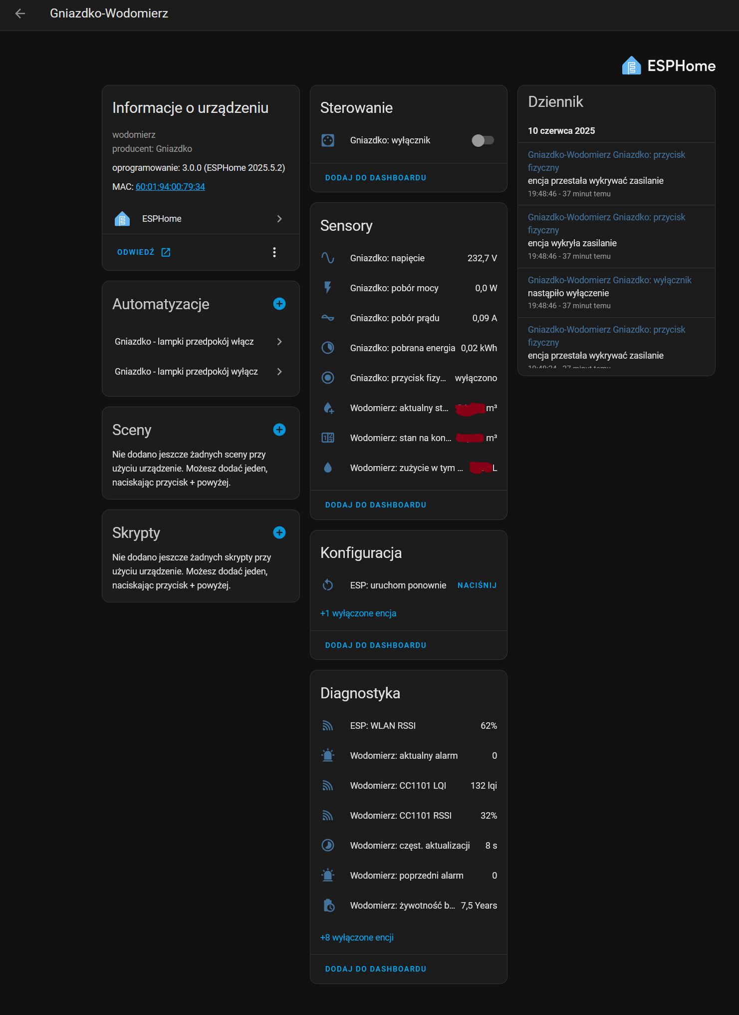

    ESPHome integrates seamlessly over its own protocol with Home Assistant, so when I added such a creation I had the relevant entities straight away:
    The page itself which ESPHome provides, on the other hand, looks like this:

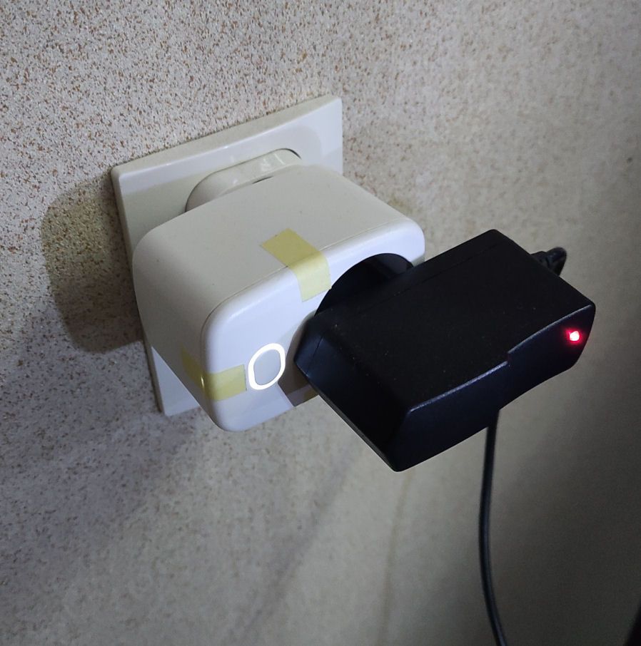

    The socket has now been alive for about three weeks. So far it has only been glued together with tape. Everything seems to be working properly. The only thing I have done in the meantime is to make small adjustments to the programme. The only drawback so far is the weak signal at the point of use, which means that not every counter telegram is received.

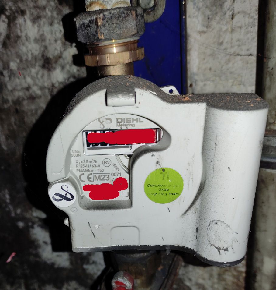

    It wouldn't necessarily be impossible, for example Tauron encrypts wMBus communications however through their e-counter service you can obtain the key. They have it described at: https://www.tauron-dystrybucja.pl/liczniki-zdalnego-odczytu/usluga-han
    Only as I wrote, you need a wMBus-enabled meter, not everyone with remote reading has this. Mine on the other hand has an RS485 port.... But under seal, so I won't connect to it.
    I understand your question is about how the tuner receives telegrams?
    Well then you have to have an RTL-SDR compatible tuner, I once bought a DVB-T2 tuner on a Realtek chip without even knowing it was compatible. So if someone wants such a receiver, it's better to look for a tuner on an equivalent chip rather than a dedicated SDR receiver, as these are much more expensive.
    Then you need to install the rtl-sdr and rtl-wmbus software. I used Linux for this, but it is also doable under Windows. Here more about it: https://github.com/xaelsouth/rtl-wmbus
    Then fire up the appropriate command in the terminal, also on the page above, and the tuner should start receiving telegrams. These can then still be redirected to wmbusmeters in order to automatically decode the required values, but I did not do this anymore.
    Here you can see what such a telegram looks like: https://github.com/zibous/ha-watermeter/blob/master/docs/build-rtl-wmbus.md
    "T1;0;0;2021-06-02 08:13:00.000;83;102;FF410778;0x1944a511780741ff4418a2011800133e230256aedd5ffc73ffff<0A>"
    It consists of the type, date, meter signal, meter serial no. and the actual information that just needs to be decoded.
    And decoded:
    telegram=|1944A511780741FF4418A2_011800133E230256AEDD5FFC73FFFF|
