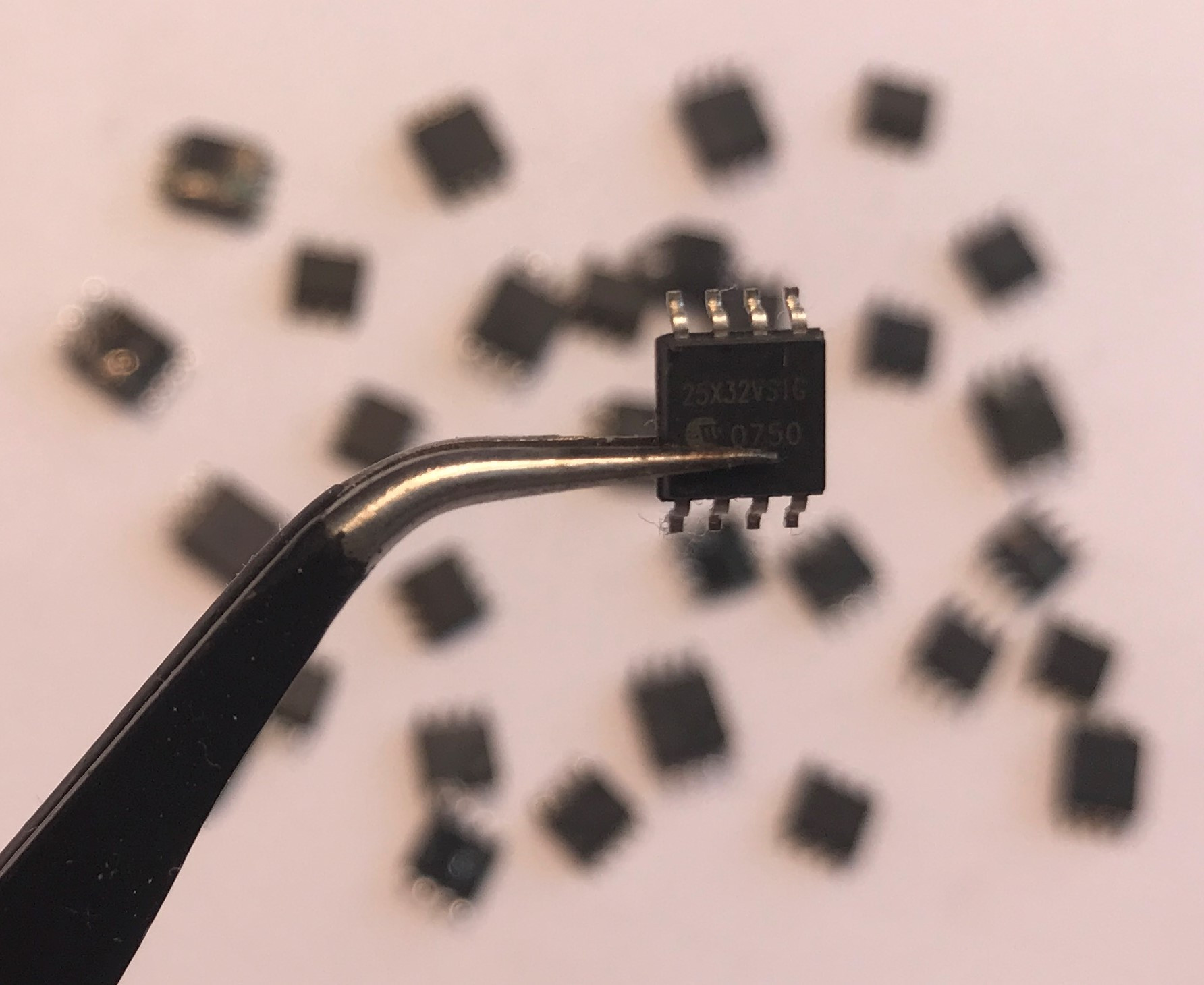

Here I will show how to easily run an external Flash memory with any microcontroller based on software SPI. I will discuss here the operation and meaning of the different operations (read, write, erase) and implement them in code.
The topic of using such memories seems interesting to me, to say the least, because it is very easy to get some such dice for free. They are available in many devices, I find them in old monitors, televisions, satellite TV receivers and even in computers or there laptops (it's that famous BIOS bone). It usually stores the program for the microcontroller, but I want to use it in general to record measurements and more.
Flash memory is non-volatile memory, so the data stored in it is not lost when power is removed, so you can store configurations, historical measurements and even files there.
The memories presented can most often be found in sizes of 1 Mb to 8 Mb, for example the W25Q80 or W25Q64. Note the difference between 1 Mb (megabit) and 1 MB (megabyte), where 1 MB = 8 Mb. This means that memory labelled as 8 Mb has a capacity of 1 MB.
I will make the presentation based on OBK , but that should not matter here.
Basically we will implement what the CH341 based programmer does:
And we will implement this on any MCU through basic operations on the digital GPIO.
Let's consider an example memory recovered from electro-waste - the 25Q32CSIG. The name itself tells us a bit about it, as "25" stands for the SPI interface, "Q" suggests support for Quad SPI mode, "32" is its capacity - 32 megabits, or 4 megabytes, and "CSIG" is the manufacturer's and case type designations. Such a memory has 8 leads and communicates fully via SPI, making it a good candidate for our experiments.
Let's review the highlights from the datasheet note. Operating voltage - up to 3.6V here, but that's not a problem as I want to run it with the MCU running at 3.3V. In addition, here we have information about the speed and endurance of the memory - a minimum of 100,000 Program/Erase cycles, I will explain this later. The data will last typically 20 years (!) and the manufacturer also gives the expected programming operation times and more. It is worth noting the information about pages and sectors, about that too in a moment.
However, let's start with what can be seen at first glance. Outputs.
Such a memory has only eight legs, and we will actually only be connecting four to the MCU. Here we have:

That is, we ultimately only need four lines to operate: CS, SCLK, SI and SO. The rest can be left on fixed logic states (Vcc or GND, according to the datasheet).
As for the physical connection - you can use SMD to THT converter boards or solder something yourself -> SMD to drilled prototyping board - what to do when there is no adapter at hand

My test bench - the memory is soldered to the DIP size converter board:
Test results:
The ID reading works - we received EF 40 16. This can now be interpreted.
- EF - Winbond Electronics (manufacturer)
- 40 - chip family (here means standard SPI NOR Flash series)
- 16 - chip capacity, in this case 0x16, which corresponds to 32 Mbit, or 4 MB
This result confirms that we are dealing with a W25Q32 chip - as I wrote. This means that the connections are correct, the SPI is working properly and the chip is responding to commands.
