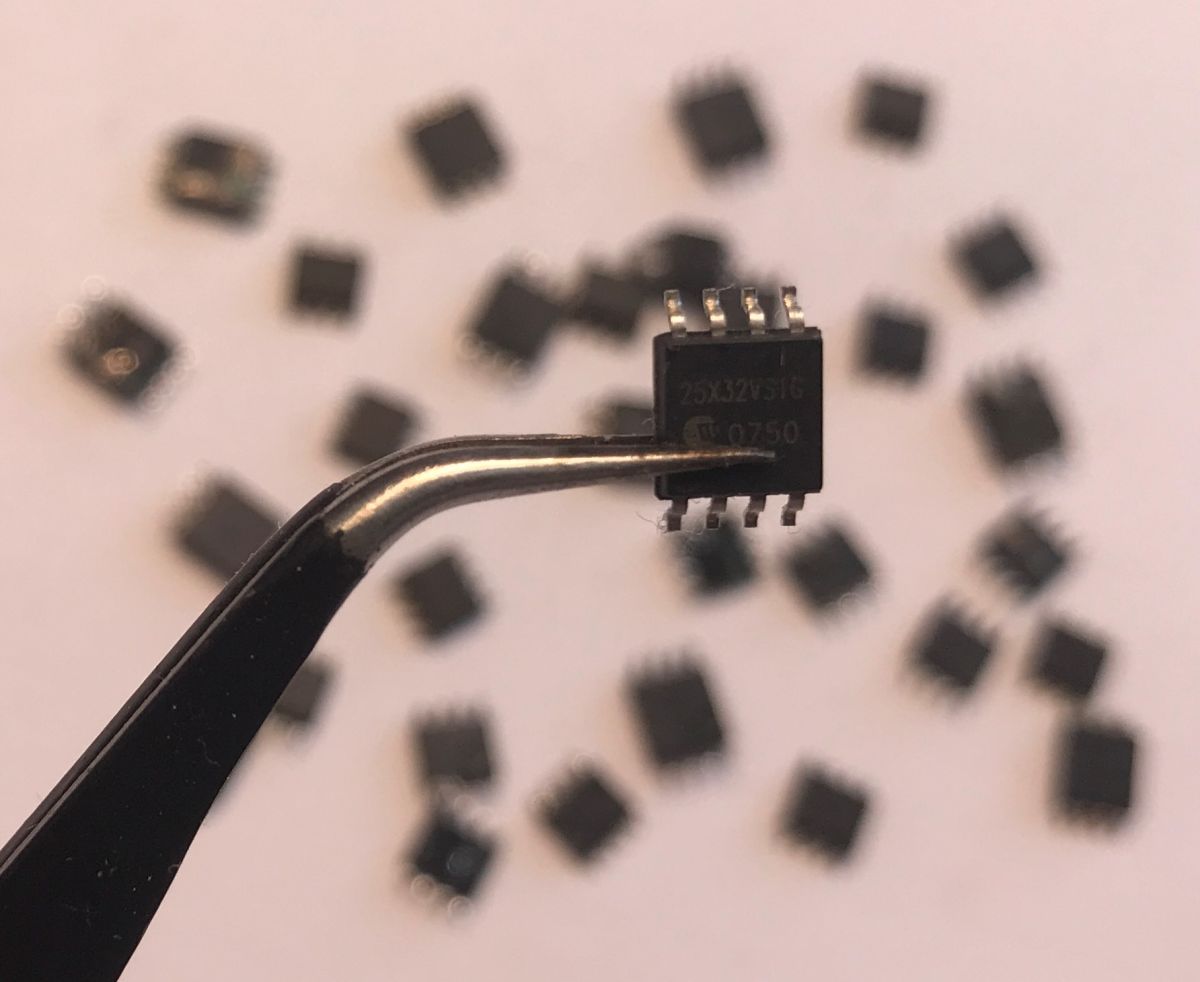

    Let's consider an example memory recovered from electro-waste - the 25Q32CSIG. The name itself tells us a bit about it, as "25" stands for the SPI interface, "Q" suggests support for Quad SPI mode, "32" is its capacity - 32 megabits, or 4 megabytes, and "CSIG" is the manufacturer's and case type designations. Such a memory has 8 leads and communicates fully via SPI, making it a good candidate for our experiments.

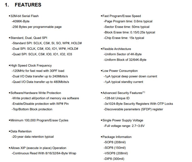

    Let's review the highlights from the datasheet note. Operating voltage - up to 3.6V here, but that's not a problem as I want to run it with the MCU running at 3.3V. In addition, here we have information about the speed and endurance of the memory - a minimum of 100,000 Program/Erase cycles, I will explain this later. The data will last typically 20 years (!) and the manufacturer also gives the expected programming operation times and more. It is worth noting the information about pages and sectors, about that too in a moment.

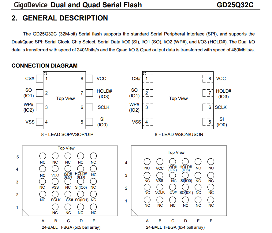

    However, let's start with what can be seen at first glance. Outputs.
    Additional flash memory for measurements for free? Communication protocol, writing, reading, deletin .
    Such a memory has only eight legs, and we will actually only be connecting four to the MCU. Here we have:
    - power and ground - you know, it's just worth checking the operating voltage
    - SO - Serial Out (data output)
    - SI - Serial In (data input)
    - SCLK - clock
    - CS - chip select, allows to select one of many devices on the common SPI bus (common SO, SI, SCLK)
    - WP - write protect, write protection. For simplicity we will pull up a high state there, thus disabling protection and allowing writing to memory.
    - HOLD - stop transmission, when we set this pin low, the memory "freezes" the SPI transmission without losing synchronisation.
    That is, we ultimately only need four lines to operate: CS, SCLK, SI and SO. The rest can be left on fixed logic states (Vcc or GND, according to the datasheet).

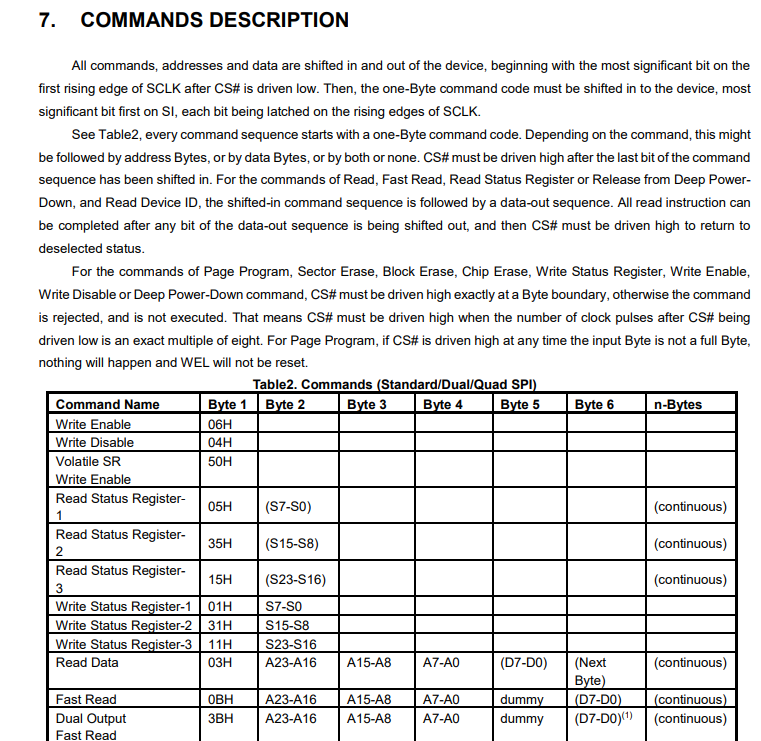

    Equipped with this knowledge, we can look at the command table. These are the commands that we send through the SPI. We will only need some of them:
    However, the commands are a bit much, so I have prepared for you a selection of the bare minimum that I think is needed for operations on such memory.

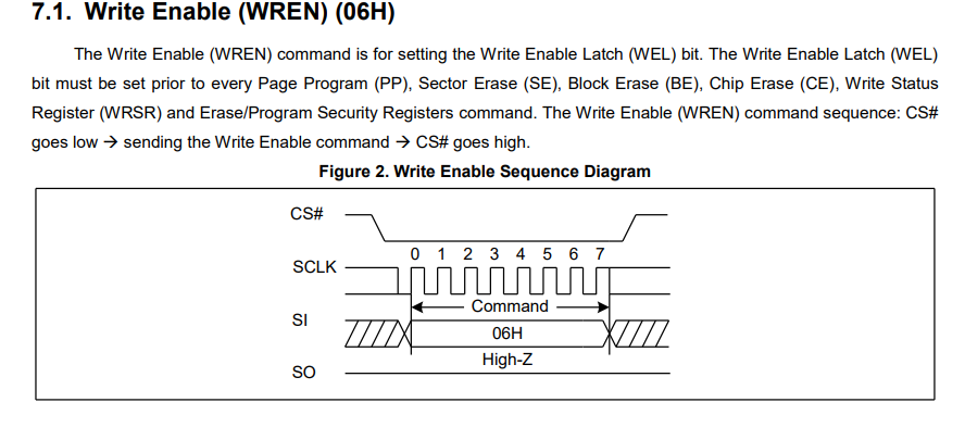

    1. setting the Write Enable bit (0x06, write enable):
    Setting the Write Enable Latch (WEL) bit is necessary before any page programming operation and before erase operations.

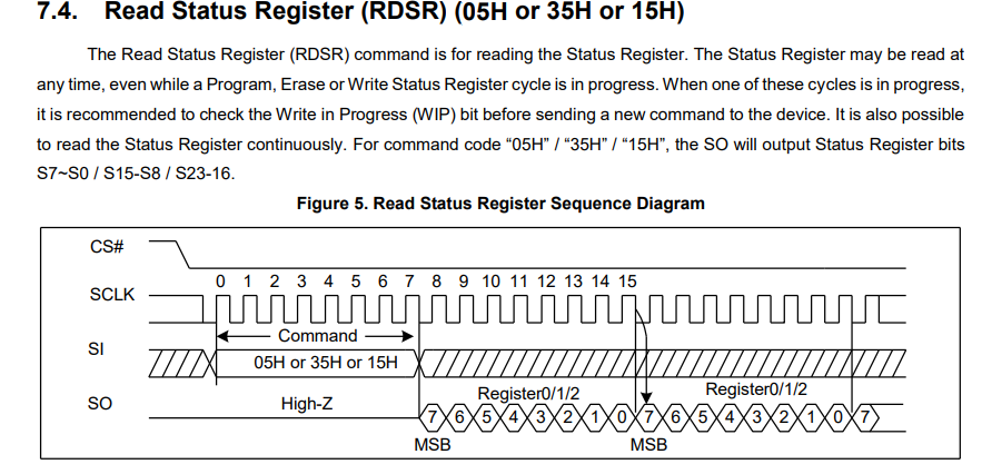

    3. read the Status register (0x05):
    This is the Status register check mentioned above.

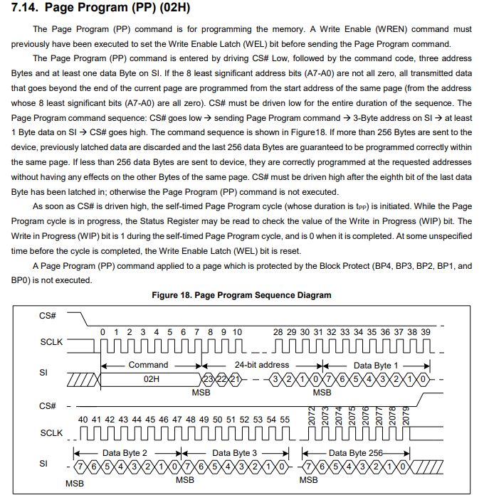

    4. page programming (0x02):
    Page programming allows bits to be extinguished within a page, although the address itself can point anywhere in the page. You only need to divide the Program commands so that they apply to one side, no 'crossing' the boundary to the other side is supported . This programming is not able to "light" the bits, only can "extinguish" them, which is why it is usually preceded by an erase cycle.

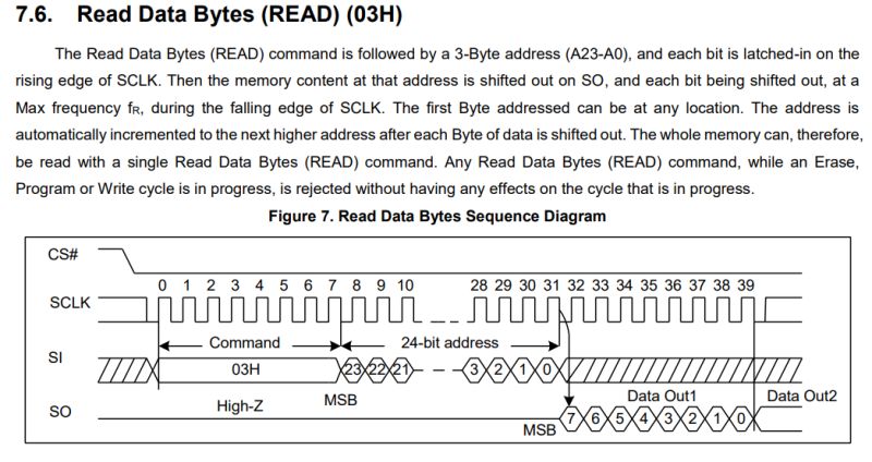

    5 Read (0x03):
    Read is the simplest command. The entire memory can be read in with one read, it does not need to be split.

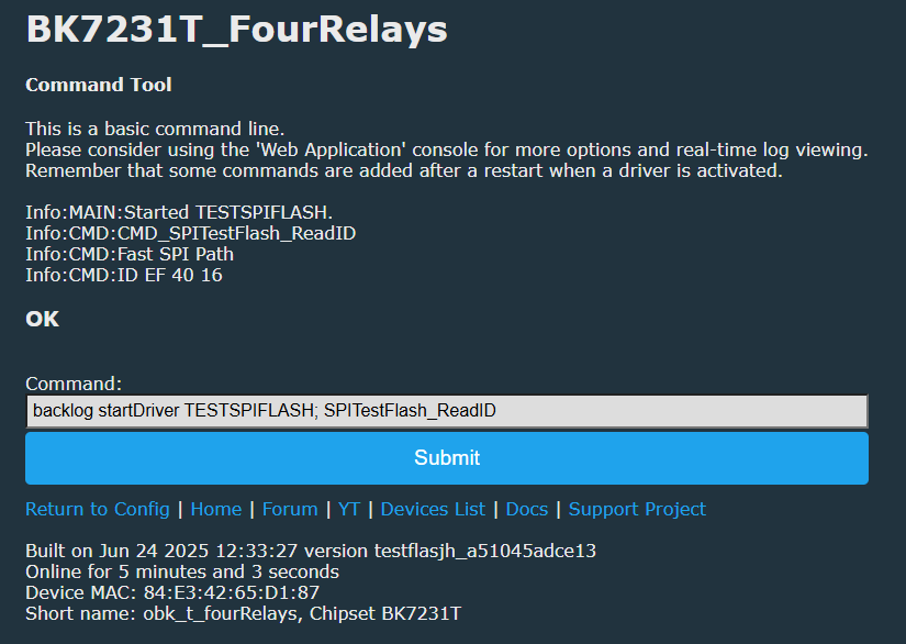

    This is what we will do in the next step - read the JEDEC ID (command 0x9F), which allows us to confirm that the chip is working, that the lines are well connected, and that SPI communication is running correctly. This also makes it easy to detect errors in connections or GPIO configuration.
    We already have the SPI functions defined and we already have the communication flow shown in the figure from the datasheet note. All we need to do is put this into the code:
    Code: C / C++
    In my case it worked out as above. I still added a command to call this from the control panel:

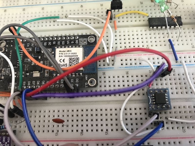

    My test bench - the memory is soldered to the DIP size converter board:
    Test results:
    The ID reading works - we received EF 40 16. This can now be interpreted.
    - EF - Winbond Electronics (manufacturer)
    - 40 - chip family (here means standard SPI NOR Flash series)
    - 16 - chip capacity, in this case 0x16, which corresponds to 32 Mbit, or 4 MB
    This result confirms that we are dealing with a W25Q32 chip - as I wrote. This means that the connections are correct, the SPI is working properly and the chip is responding to commands.

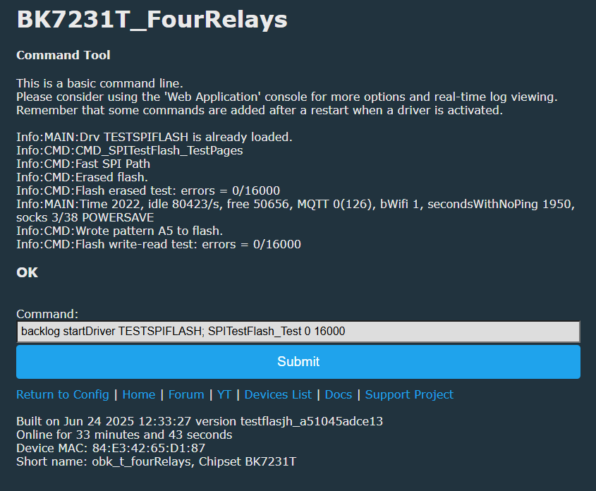

    Based on these functions, I have prepared a short method to test the memory in a selected range:
    Code: C / C++
    The method takes as argument the address, the number of bytes and the reference byte. At first, the required number of pages is deleted, then the deletion is verified, and then the memory is programmed with the specified byte. Finally, the readout verifies what we have programmed.
    Such method makes it possible to fully check the correctness of the communication, including the division of the record into pages.

How do page boundaries work in the Page Program 0x02 command, and why can't a single write cross from one page into the next?
Page Program 0x02 works only within one 256-byte page at a time. If your buffer reaches the page end, firmware must split the transfer and start a new program command on the next page. The thread states that no crossing into the other page is supported in one write. Its sample code calculates the page offset and fragments long writes so each chunk stays inside one page. [#21598146]
