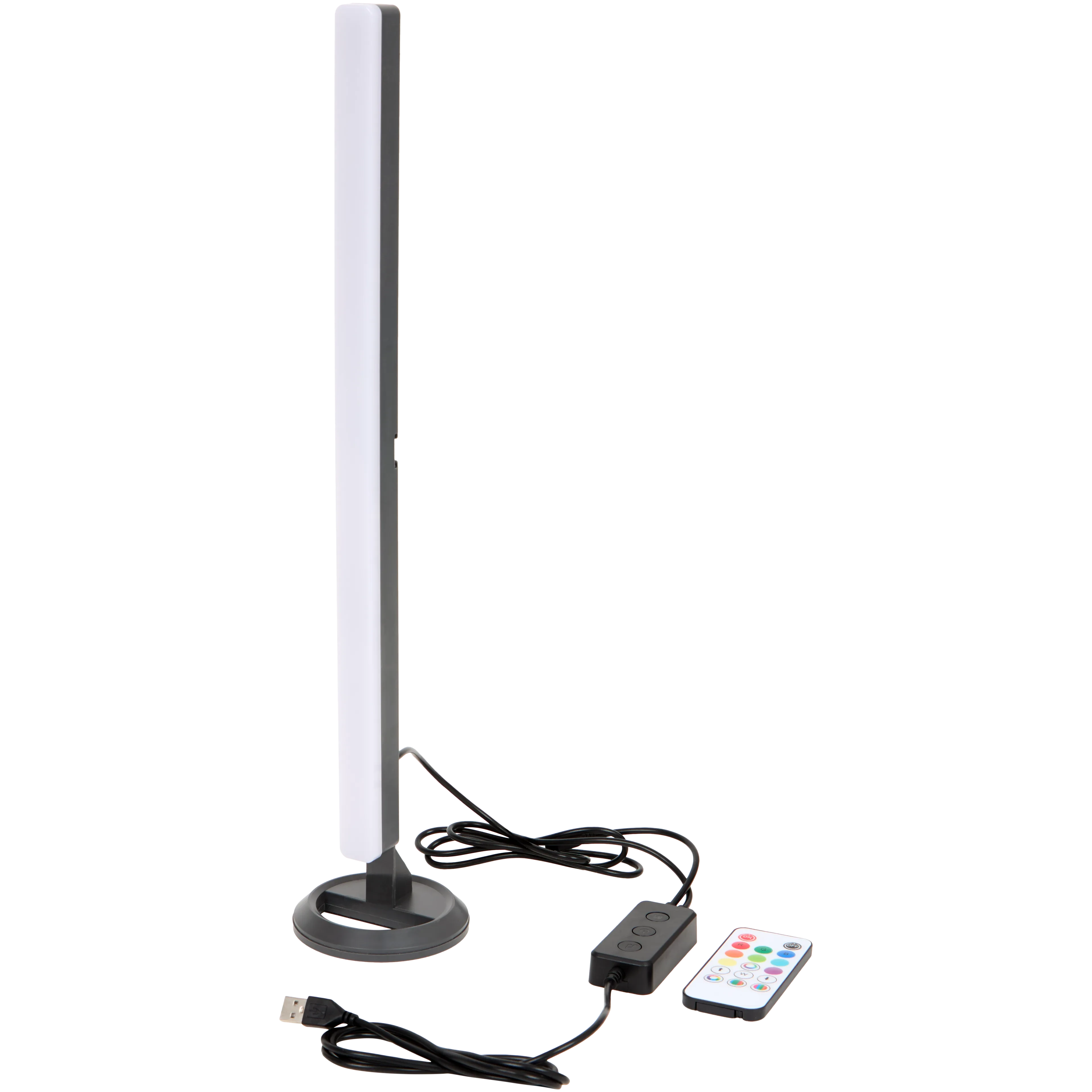

  • OpenBeken runs on the Sky-Lighting RGB Light Bar AM-RGB-LB-5, a 40 cm RGBIC light bar sold under brands like Battletron and Sailsco.
  • The bar uses a BK7231N Wi‑Fi MCU and 33 individually addressable WS2812B LEDs; Tuya cloud firmware had to be replaced through serial flashing.

The RGB Light Bar (AM-RGB-LB-5) by Sky-Lighting has been available under various brand names since around July 2024, for example at Action DE and Amazon.de. It is usually integrated into the smart home using the LSC Smart Connect or Smart Life app.
ManufacturerSky-Lighting
Model nameRGB Light Bar
Model numberAM-RGB-LB-5
PCB namePBL6231N-5523CD1
Products
Brand nameBattletronSailsco
Product nameLED Light BarLight Bar 40cm RGBIC
Product number6232000900X00239890H
GTIN-13 (EAN-13)8712879162735

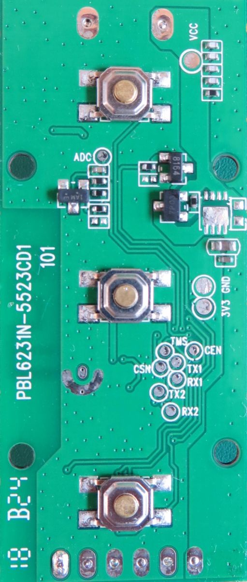

Power is supplied via a standard USB Standard-A connector, but a power supply unit (5 V, 1 A) is not included with the product. A microcontroller BK7231N by Beken is used directly on the circuit board, which connects to the Tuya cloud via Wi-Fi and controls the 40 cm long light strip. The 33 individually addressable RGBIC LEDs (WS2812B) can be operated either by the IR remote control, app, or music via microphone.
Firmware flashing
Although the light bar can only be operated locally via remote control and in music mode, it is not possible to disconnect from the Tuya cloud using CloudCutter. The pre-installed firmware version 1.1.16 with class oem_bk7231n_slide_strip_ty has already been patched against the known vulnerability.
Therefore, OpenBeken must be flashed via the serial interface (GND, 3V3, TX1, RX1).
Close-up of PBL6231N-5523CD1 PCB with three buttons and labeled pin headers

• BK7231N Wi-Fi SoC patched against CloudCutter exploit [Elektroda, emarck, post #21616737] • 33 × WS2812B LEDs, 40 cm bar length [Elektroda, emarck, post #21616737] • USB-A, 5 V, 0.9 A max (≈4.5 W) [Elektroda, emarck, post #21616737] • Street price €14–€20, July 2025 EU listings [Action DE, 2025] • Stock firmware 1.1.16 blocks OTA root [Elektroda, emarck, post #21616737]
How do I flash OpenBeken onto the Sky-Lighting Light Bar?
  1. Solder wires to GND, 3V3, TX1, RX1 on the PCB [Elektroda, emarck, post #21616737]
  2. Connect a 3.3 V USB-to-TTL adapter and run OpenBeken flasher.
  3. Power-cycle while holding BOOT to enter UART mode. Flash completes in under two minutes. "Always verify the checksum before rebooting" [Elektroda, emarck, post #21616737]
Which serial pins are which on board PBL6231N-5523CD1?
Silkscreen labels: P8 = 3V3, P9 = GND, P18 = RX1, P19 = TX1 [Elektroda, emarck, post #21616737] Keep leads short to avoid noise.
