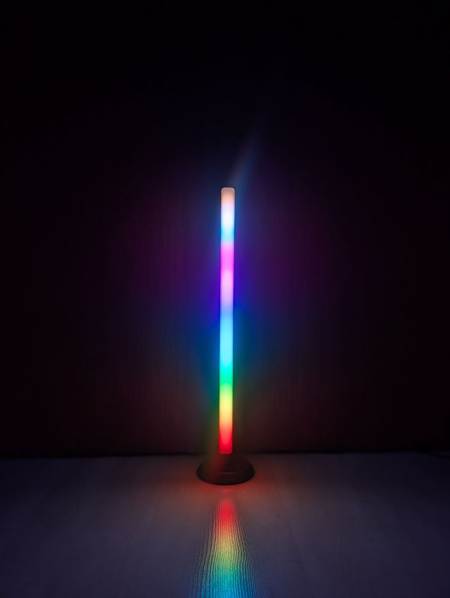

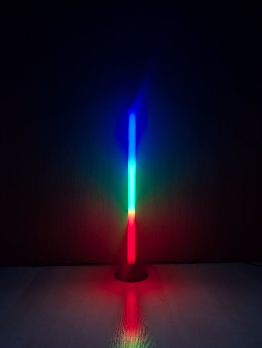

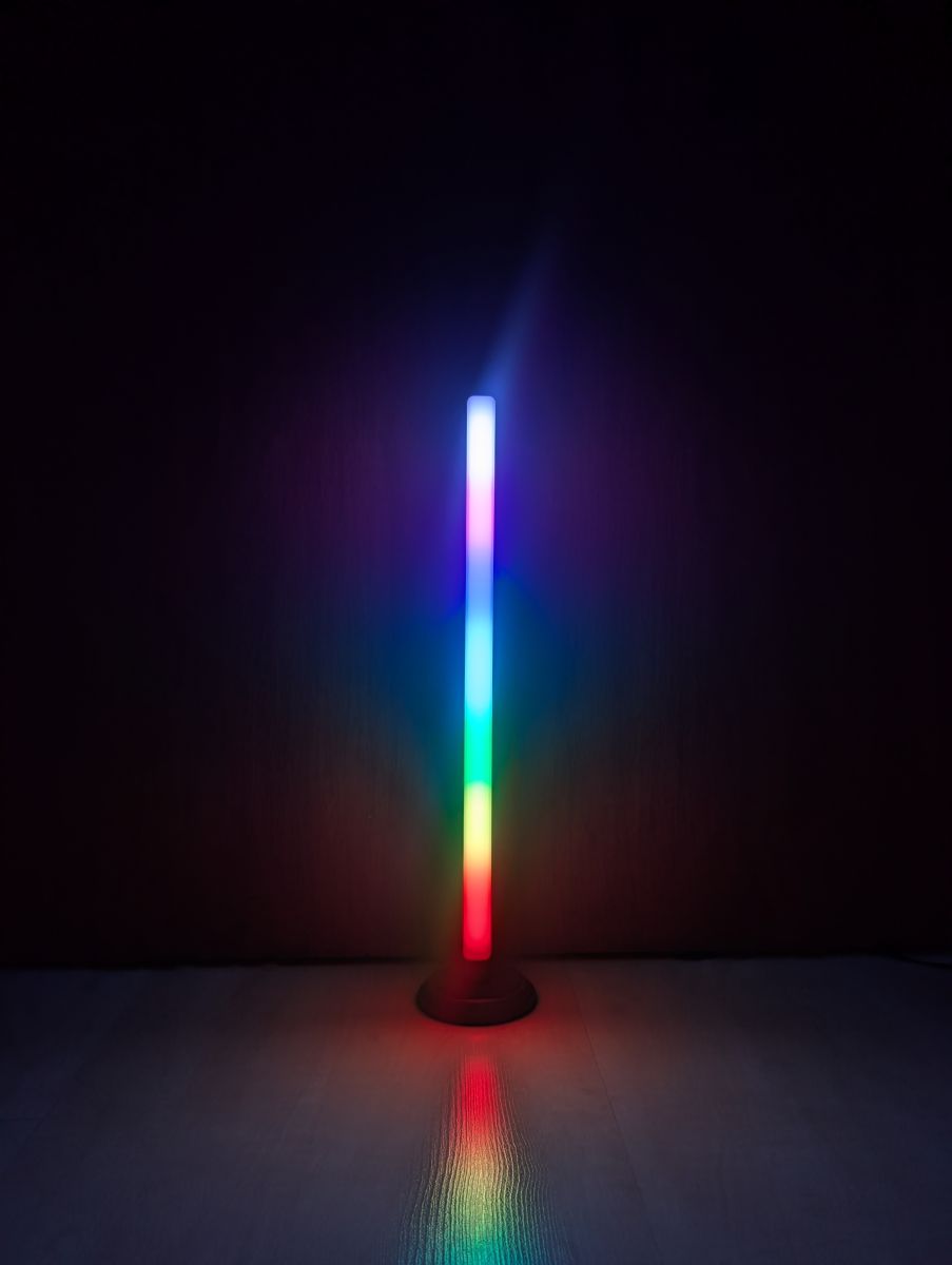

    Demonstrations
    First pattern:
    Vertical RGBIC LED light bar glowing in the dark
    Second pattern:
    Colorful vertical RGB light bar glowing red, green, and blue on dark background
    Third pattern:
    Colorful RGB light bar standing vertically, glowing in a dark room

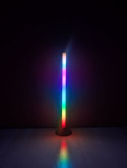

    Rainbow Cycle animation:
    Fire animation:
    Red Shooting Star animation:
    Green Shooting Star animation:
    Blue Shooting Star animation:
    The animations run at maximum speed by default and can be slowed down if necessary. The Shooting Star animation automatically uses the last color set. The videos show examples of this for the three primary colors.

    I added photos for the patterns and videos for the animations to my initial post. Does this meet all the requirements for inclusion in the list of supported devices?
    It would be great if the PixelAnim library could feature even more animations in the future.
