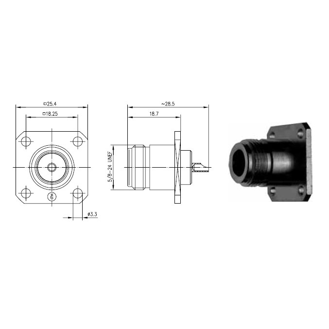

    Thanks for answering if I get a plug and a C50 socket on the cable, can I finish it with a socket and a bnc plug (typical) crimped on a cable, eg H-155 or are there any specific lengths of these wires? as far as the whole plugs are concerned, I found something like this. Manufacturer: Telegärtner NF PANEL CONNECTOR collar 25.4mm typical or these dimensions will be ok

    If you have this reflectometer on hand, unscrew one of the original sockets from the measuring head. See how it is made and compare with this sketch what you have posted. The conclusions will be the same whether it will fit.

    Yes, I only do not want to interfere in the head for the time being, do these sockets in the head are pressed or soldered to the other side of the head?
    Added after 3 [hours] 18 [minutes]:
    Already everything is clear, the sockets are in very good condition, I do not know if I will get such nests anywhere

    Unfortunately, EUREKA for the needs of the reflectometers of this series produced its own sockets, differing in dimensions from the standard. A colleague solved this problem by using a puck made of aluminum plate with a thickness of about 2-3 mm. He fastened the socket on short screws to this plate, and then he screwed the plate tight with screws screwed into the holes in the original slot. For the "hot" solder contact in the socket he added something very similar to the shape of this element as in the original slot. He sawed it with a needle from a piece of brass rod. A bit of precision work with it, but it came out elegantly.
