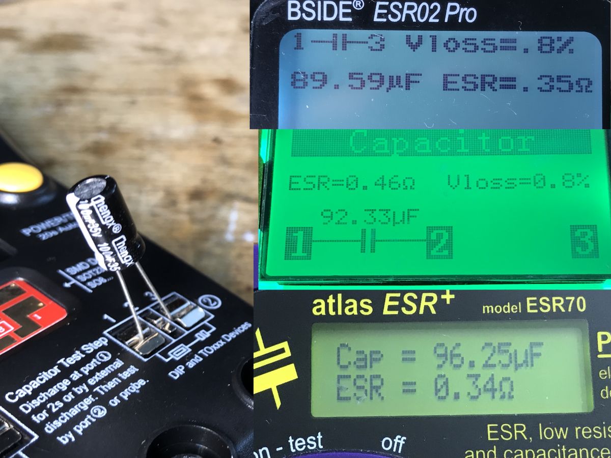

    I invite you to a short comparison (gallery) of the BSIDE ESR02 Pro component tester. I will compare its results here to the classical ones LCR-T4 , known from the elektroda shop, to the previously described ESR70 , and in some cases to the results shown by the Brymen BM857S multimeter.

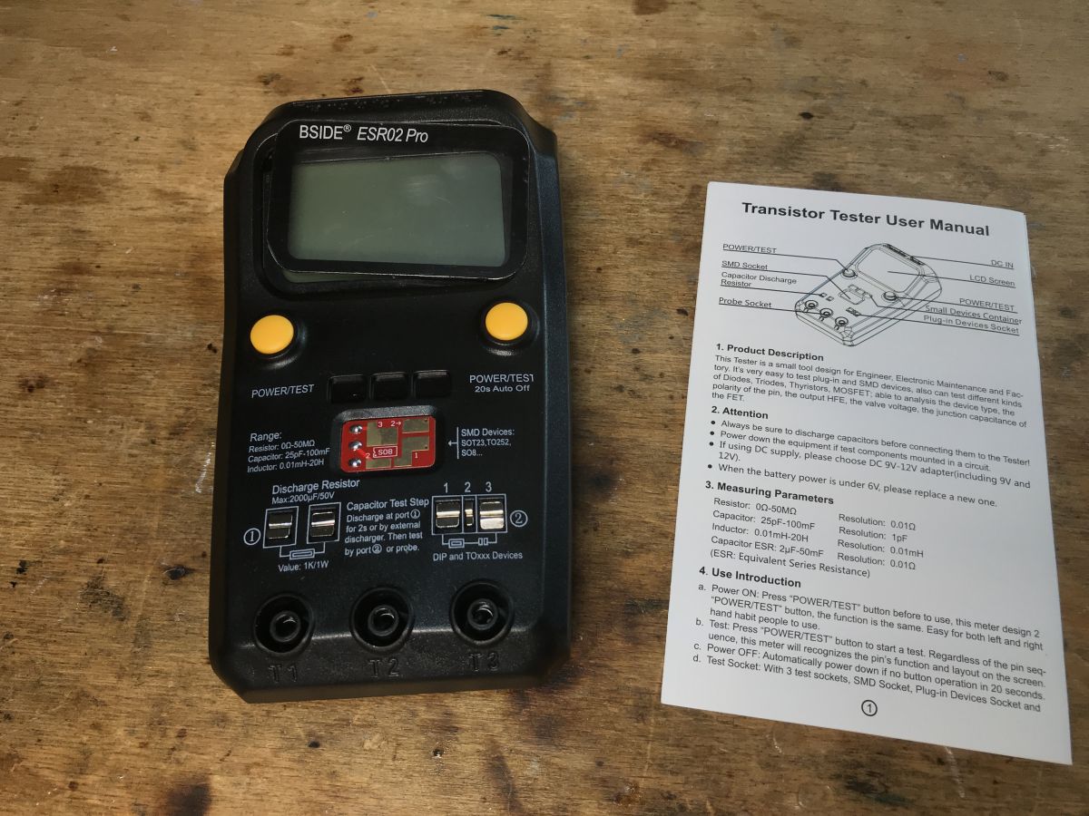

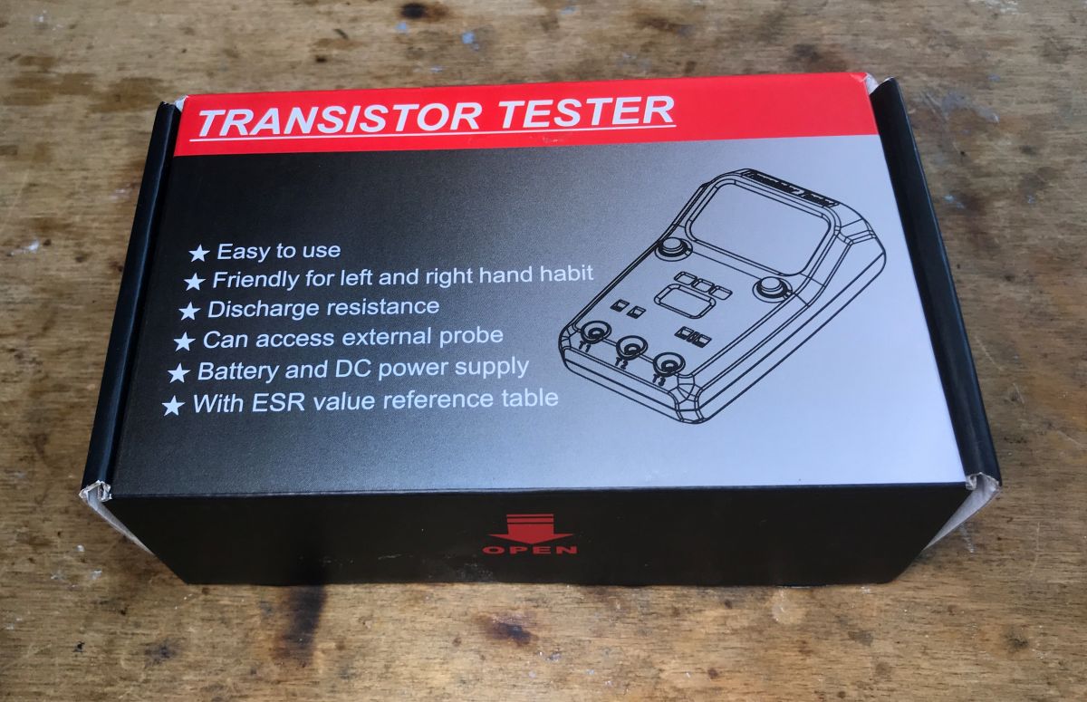

    The tester comes in a box:
    Box of the BSIDE ESR02 Pro component tester with product description. Box of BSIDE ESR02 Pro transistor tester. Box of the BSIDE ESR02 Pro transistor tester on a wooden table.
    There is also an instruction manual with the procedure calibration : :
    Transistor tester user manual.

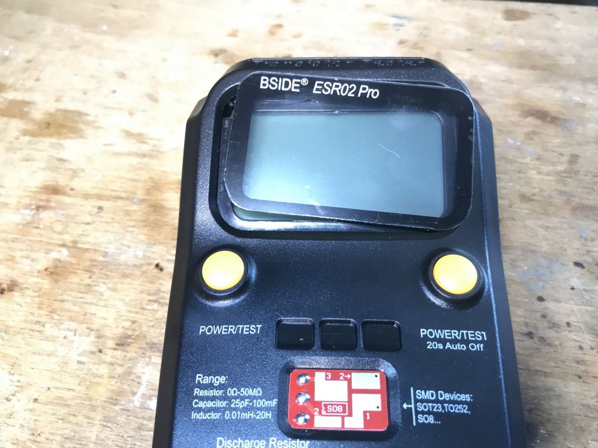

    I don`t know why the tester arrived in such a condition:
    BSIDE ESR02 Pro component tester on a wooden table. BSIDE ESR02 Pro component tester with user manual.

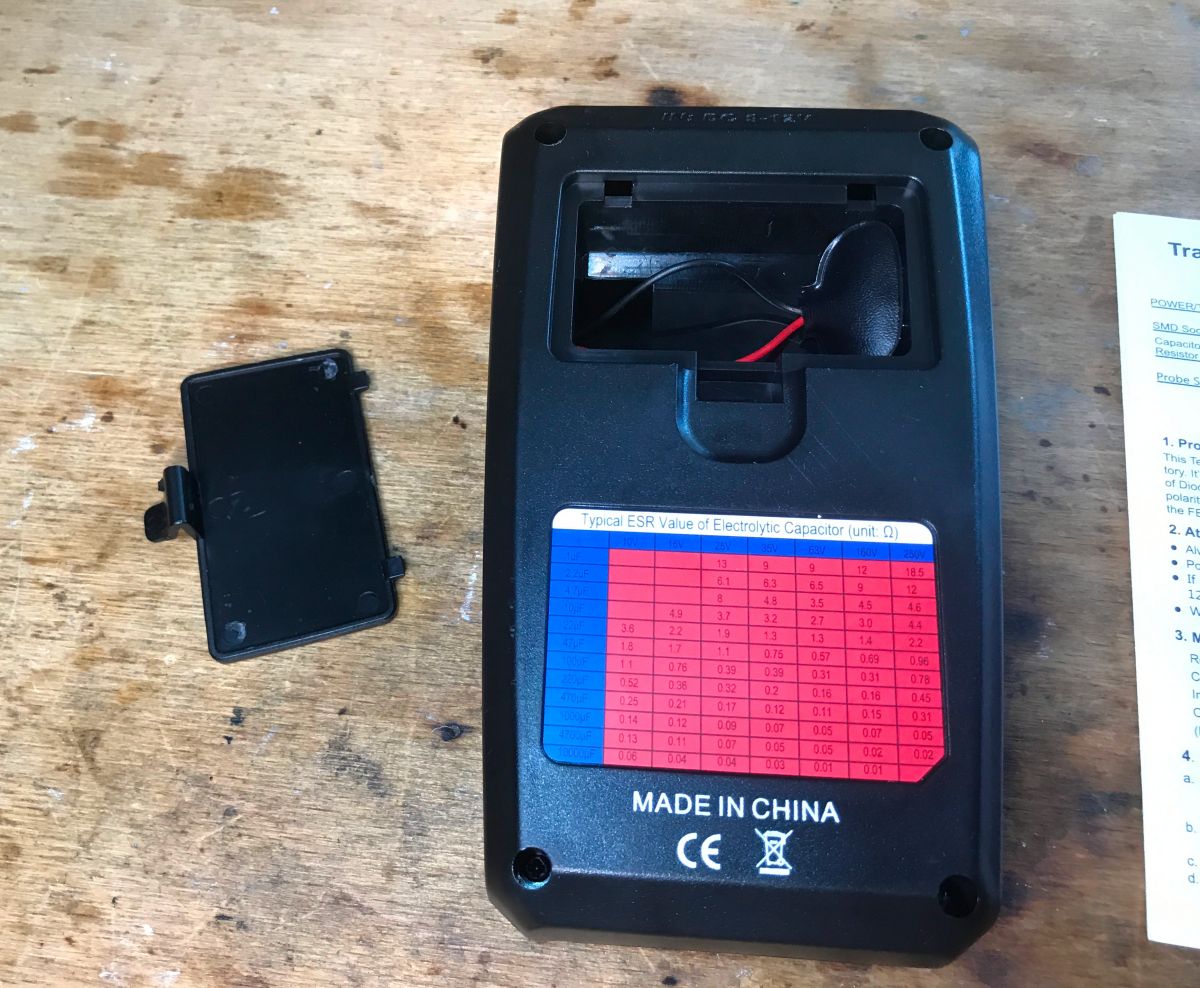

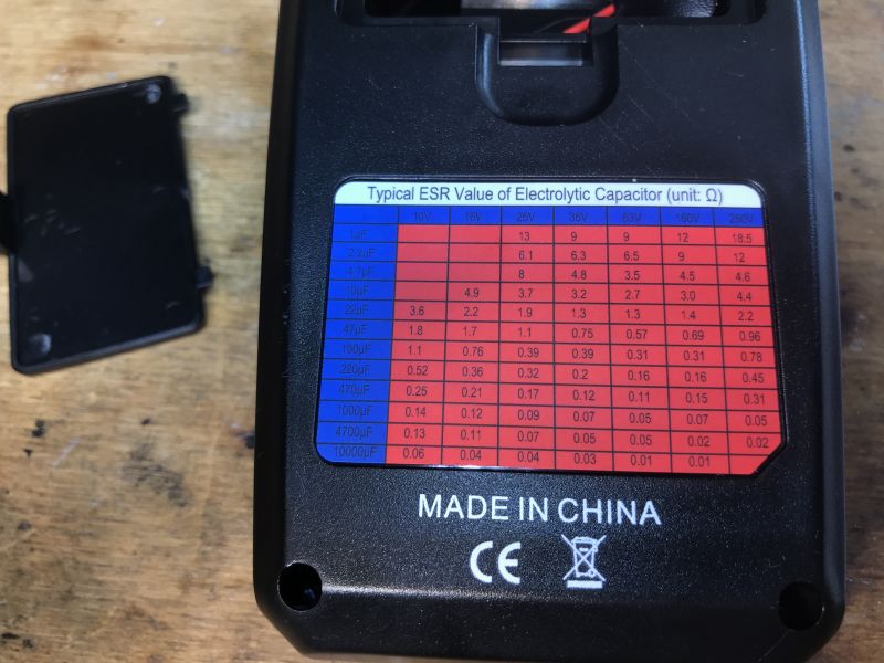

    The battery is not included, there is an ESR table on the back:
    Back of BSIDE ESR02 Pro tester case with ESR value chart. Back of the BSIDE ESR02 Pro component tester with an open battery compartment.

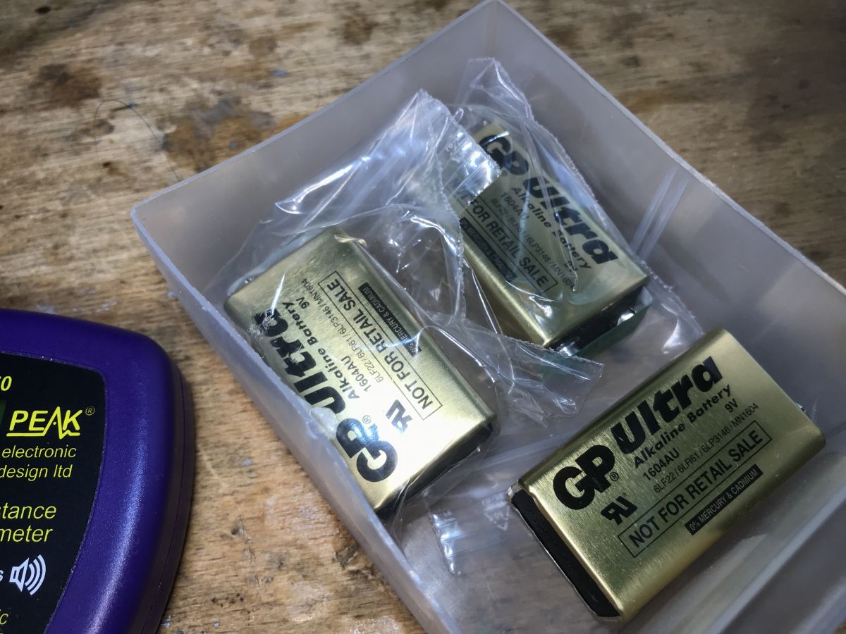

    You need to give it a good battery, otherwise it may not turn on:
    Fortunately, I have a stock of them:
    GP Ultra 9V batteries in a plastic box next to a measuring device.

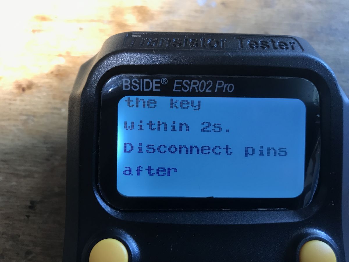

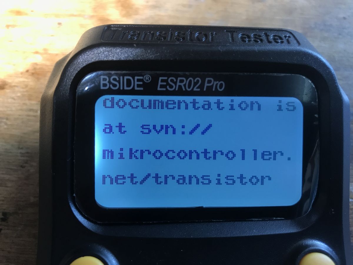

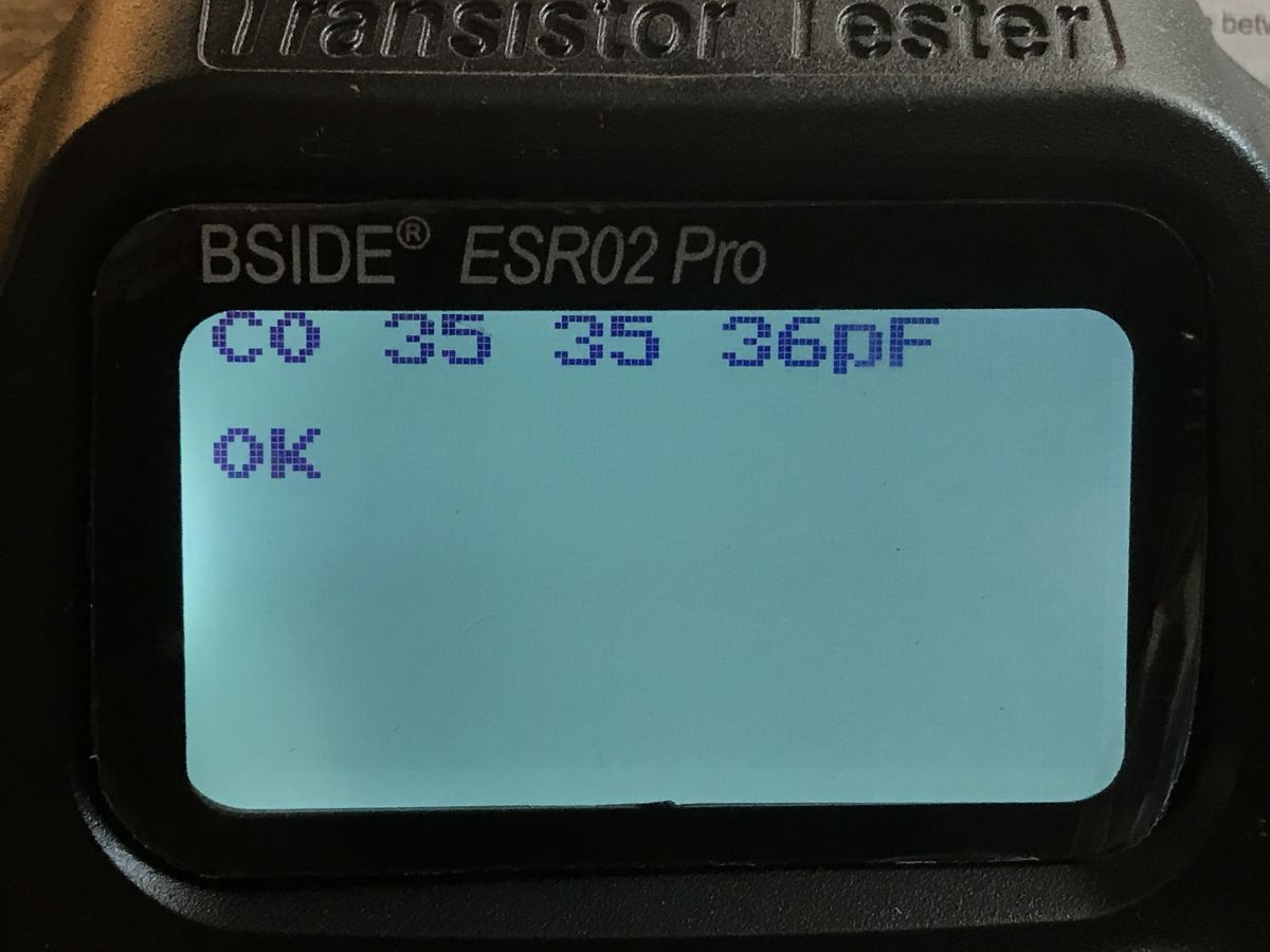

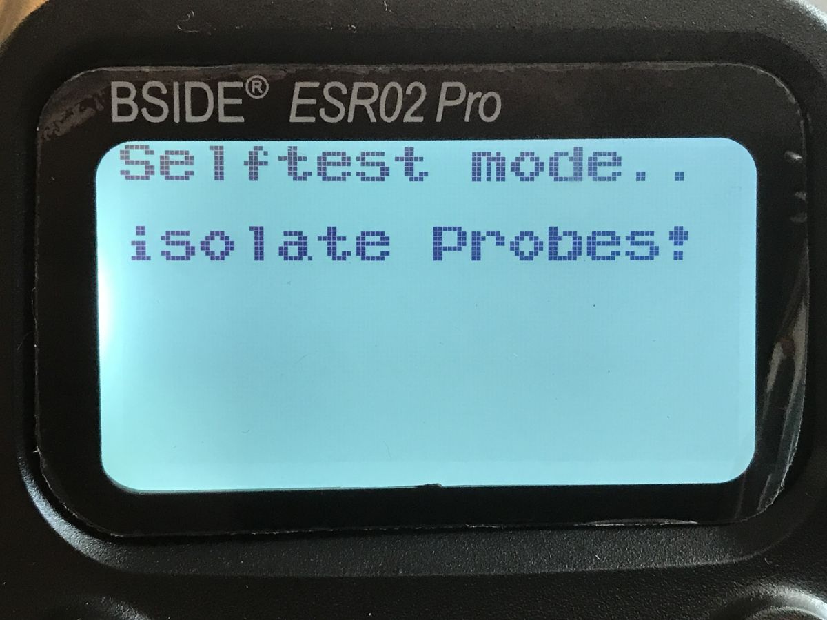

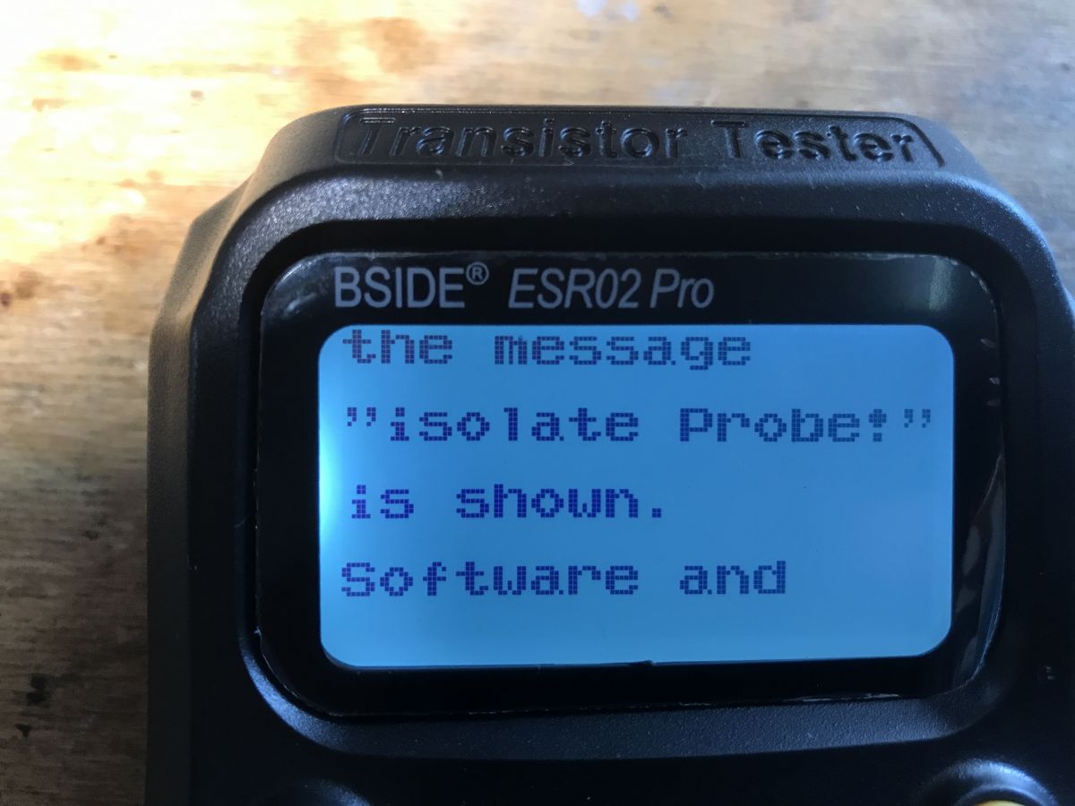

    I also performed calibration:
    Display of the BSIDE ESR02 Pro component tester with a calibration message. Display of BSIDE ESR02 Pro tester with a calibration message. BSIDE ESR02 Pro component tester with text displayed. BSIDE ESR02 Pro display in self-test mode. View of the BSIDE ESR02 Pro tester screen displaying capacitance measurements.

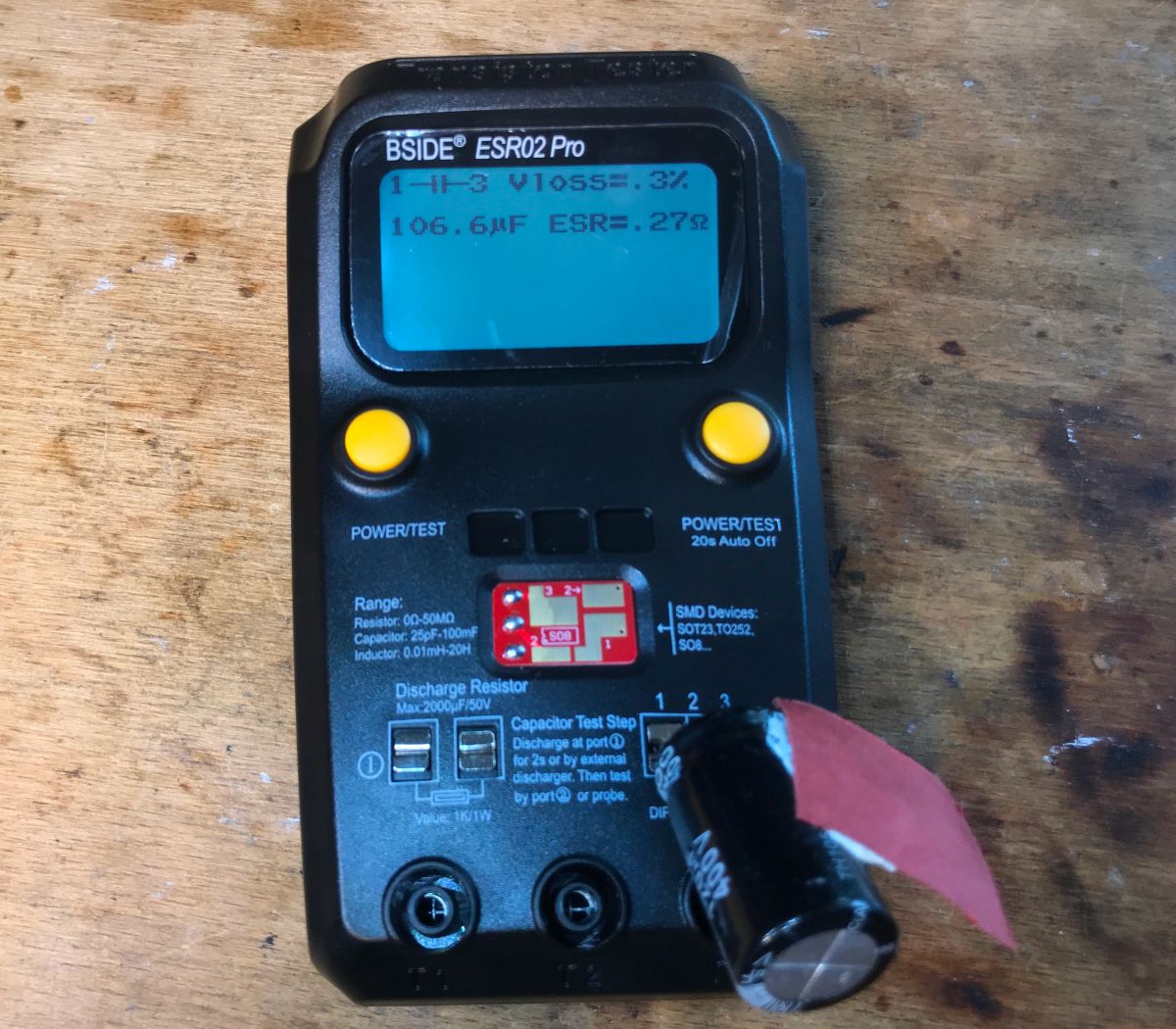

    After calibration, we start testing:
    BSIDE ESR02 Pro tester on a wooden table with a display showing capacitor measurements.

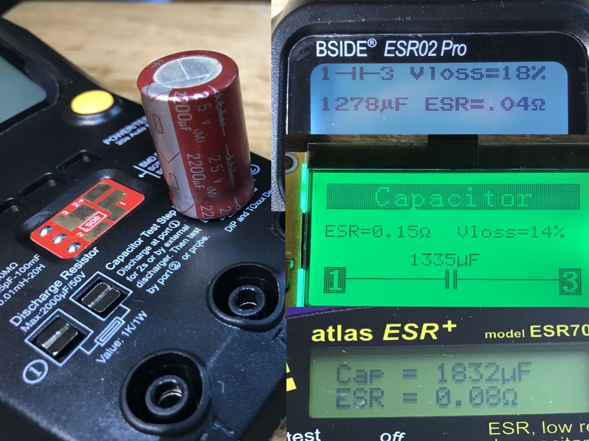

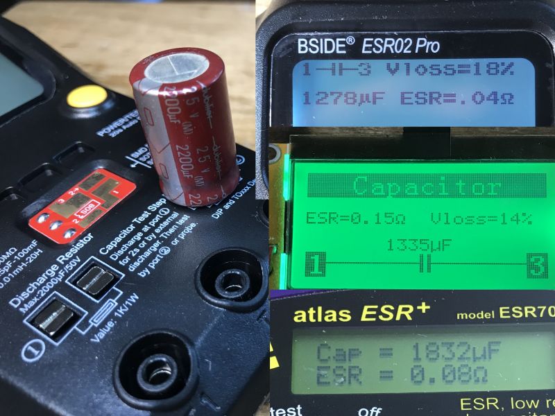

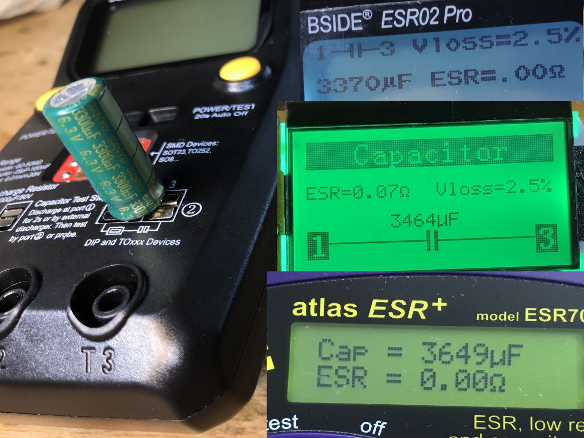

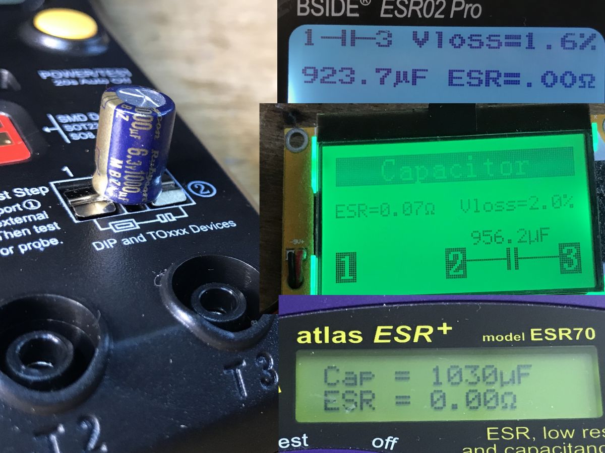

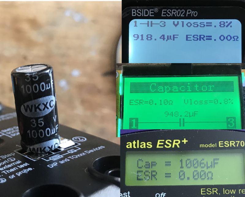

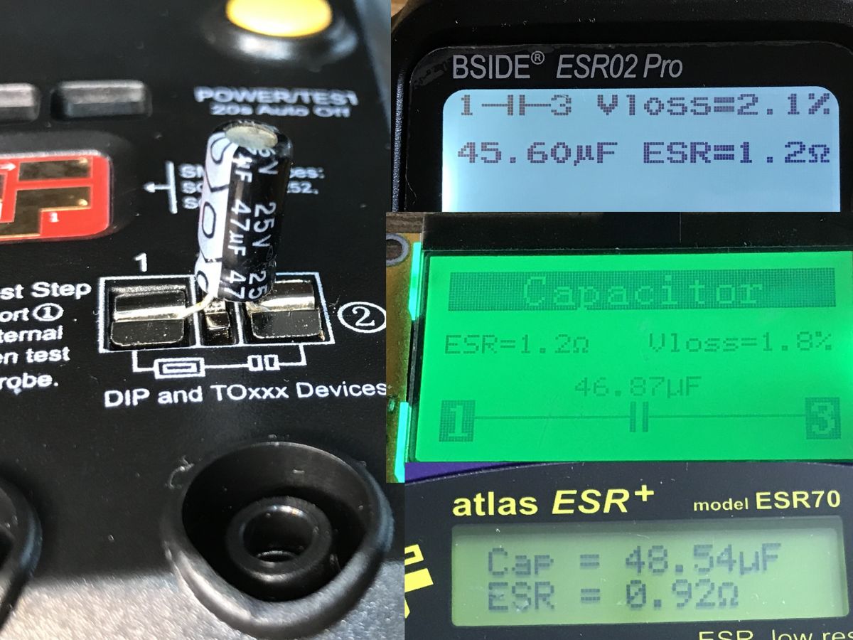

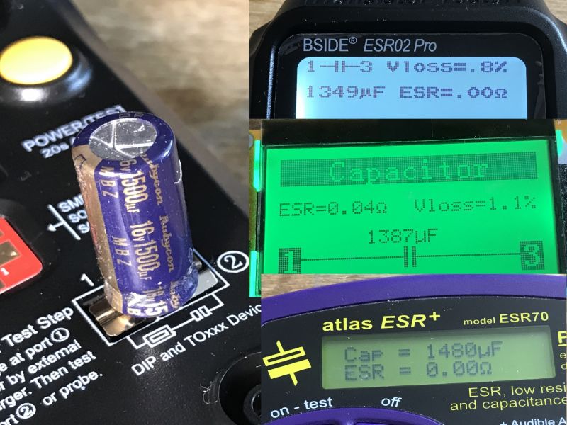

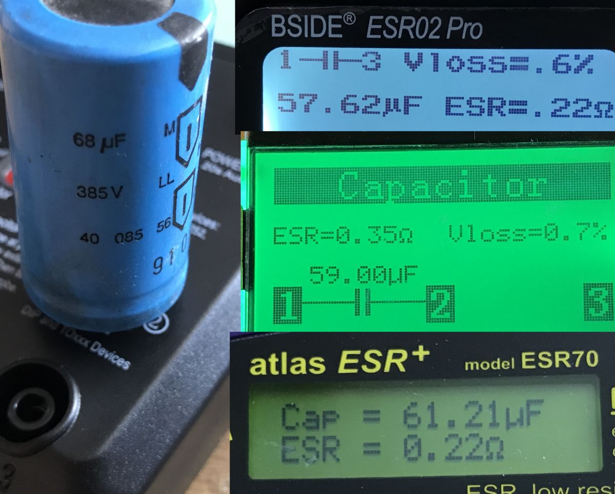

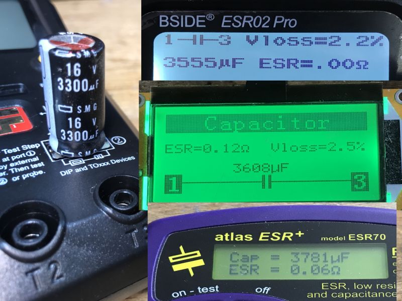

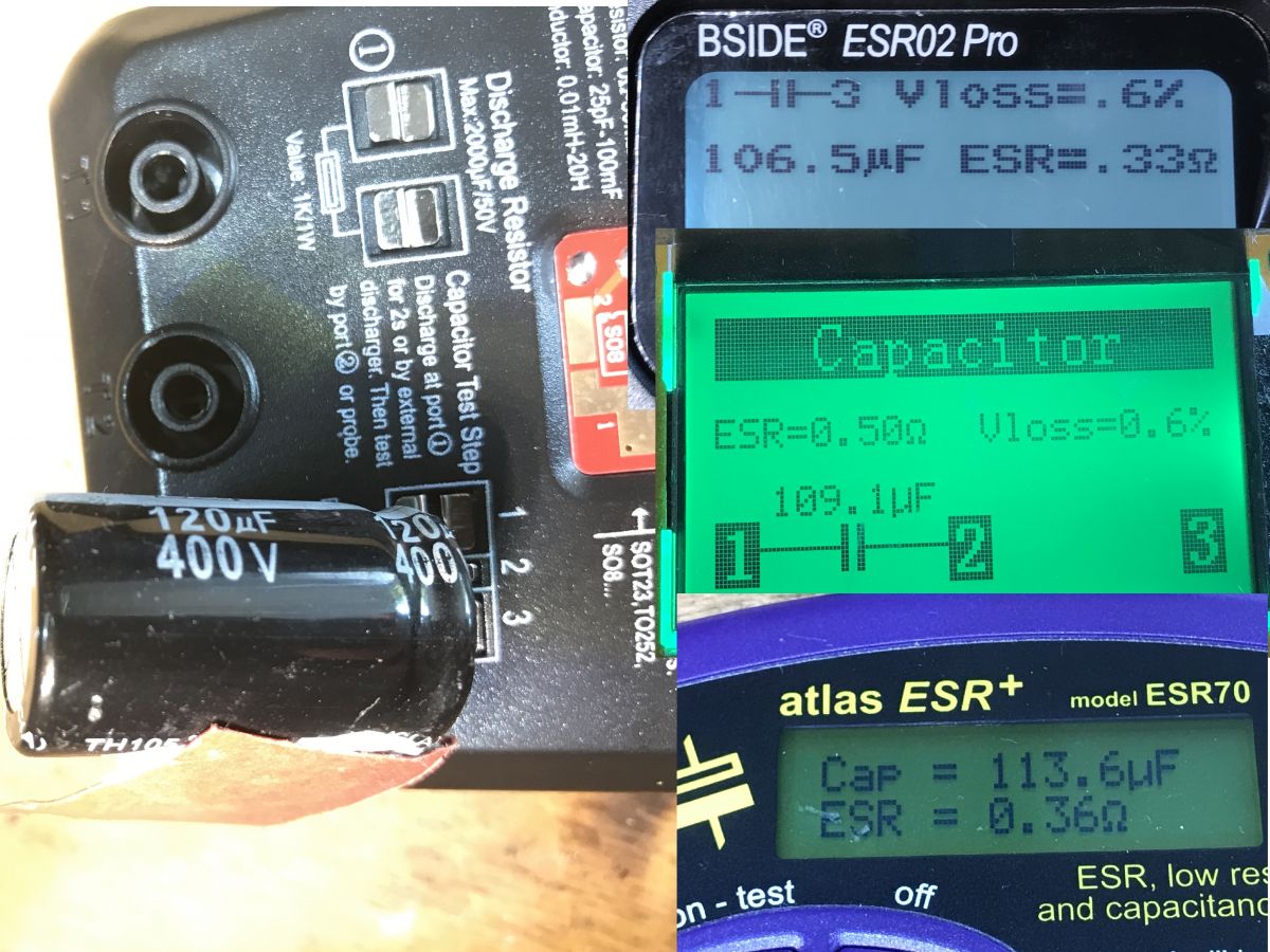

    Comparisons and tests
    Now I`m comparing the results from BSIDE ESR02 Pro with other testers, depending on what I measure there will be other competitors, because e.g. ESR70 only measures ESR... let`s start with capacitors:
    Comparison of ESR measurements on a capacitor by different testers.
    BSIDE ESR02 Pro component tester displaying capacitor measurement results. Comparison of capacitor measurement results using different testers. BSIDE ESR02 Pro tester compared with other ESR testers. Component testers: BSIDE ESR02 Pro, LCR-T4, Atlas ESR+ BSIDE ESR02 Pro component tester compared with other devices. BSIDE ESR02 Pro tester displaying ESR measurements of a capacitor. Comparison of readings from BSIDE ESR02 Pro and Atlas ESR+ testers while testing a capacitor. Example of capacitor testing using BSIDE ESR02 Pro and Atlas ESR+ testers.
    Comparison of capacitor test results using BSIDE ESR02 Pro, LCR-T4, and ESR70 testers.
    LCR-T4 seems to slightly overestimate ESR, or maybe the other two underestimate it?

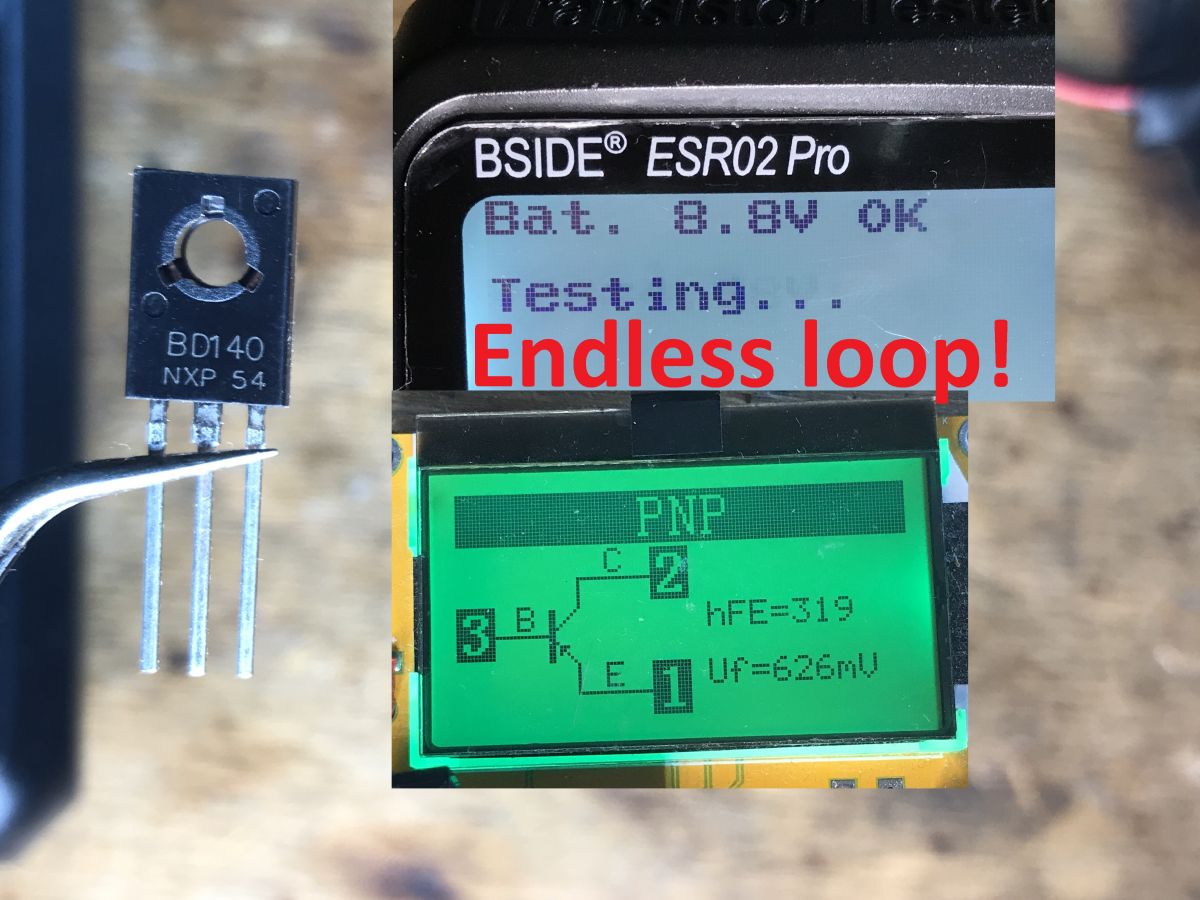

    Maybe now the BD140 transistor:
    BSIDE ESR02 Pro tester in a loop during BD140 transistor test.
    ESR02 gets into testing loops and produces no results.

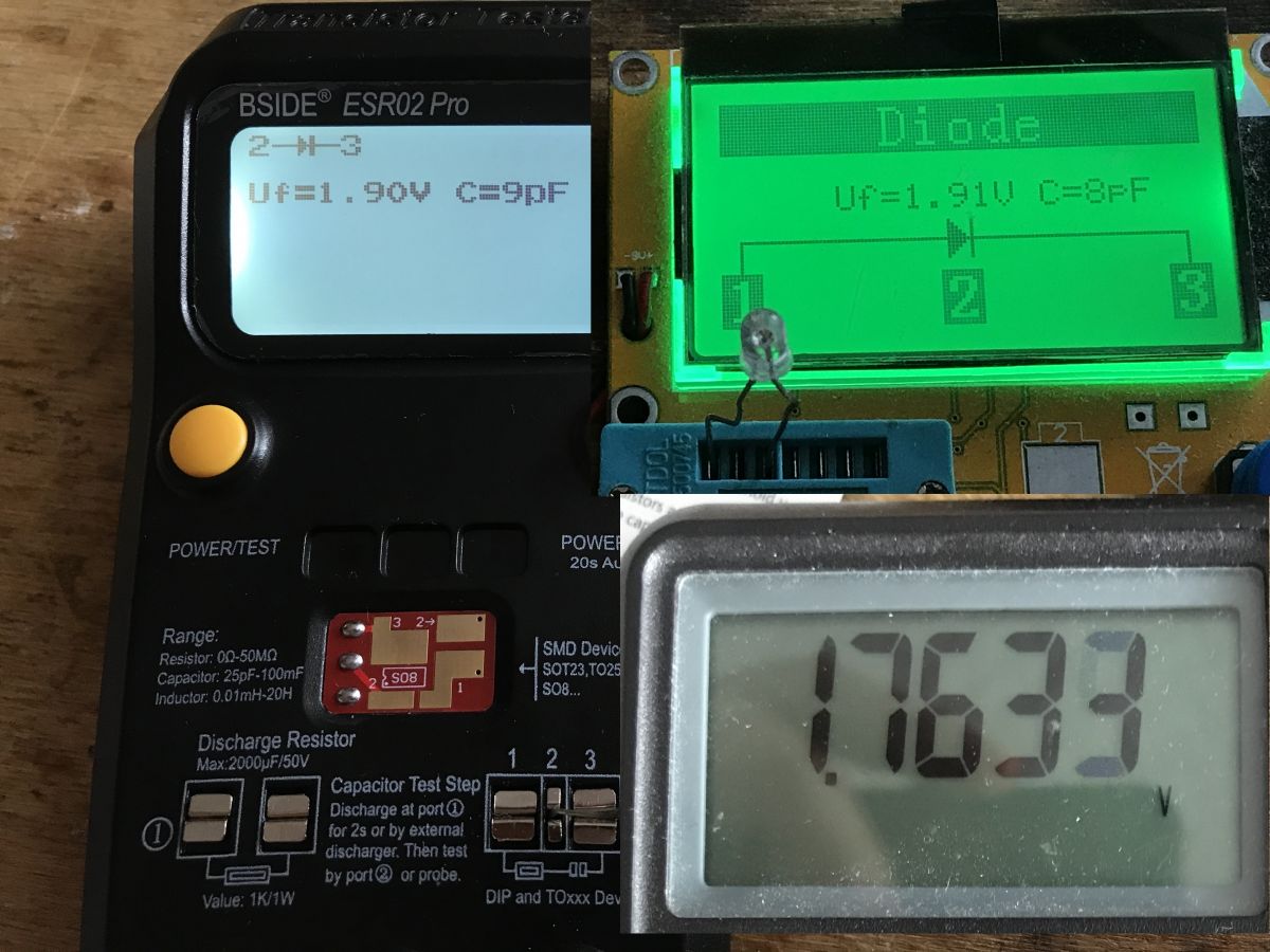

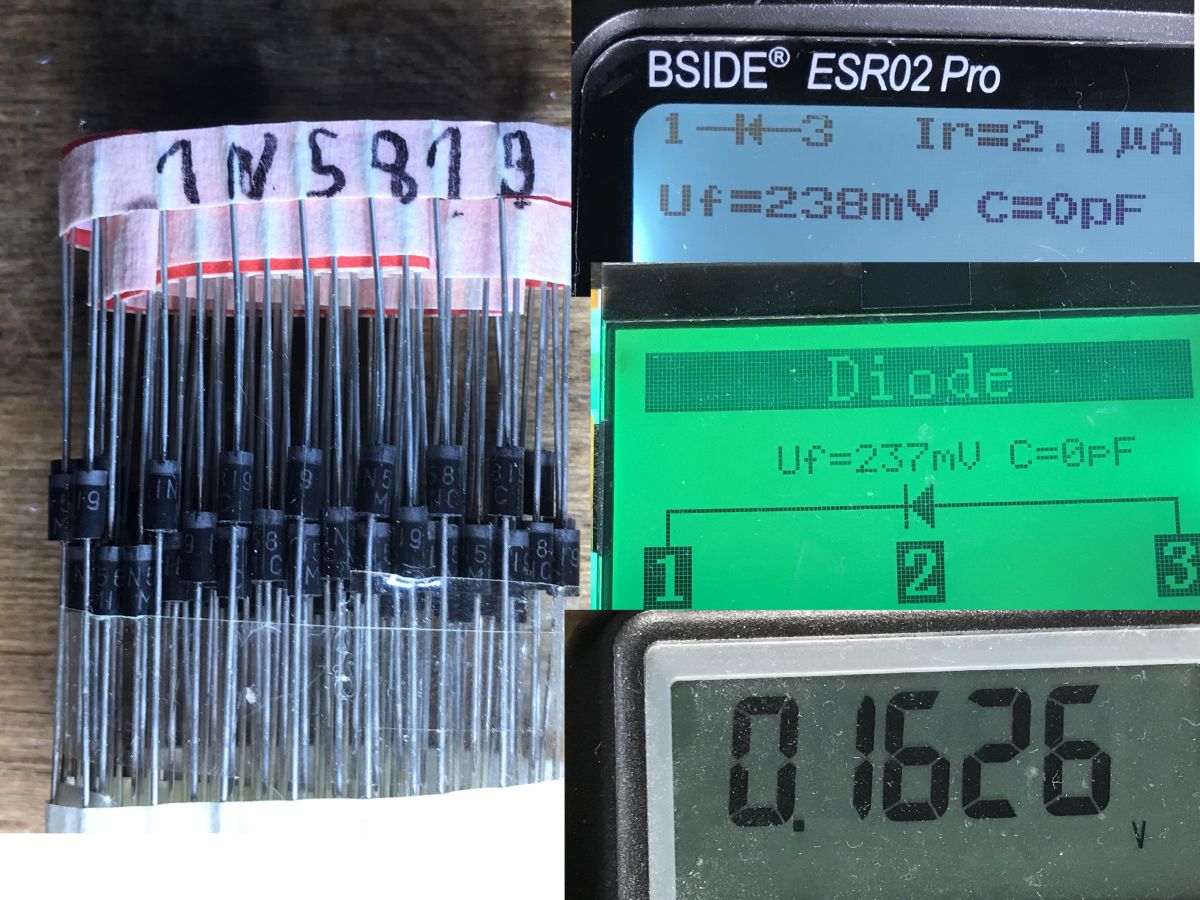

    1N5819 Schottky diodes:
    Comparison of Schottky diode measurement results using the BSIDE ESR02 Pro tester
    Brymen shows slightly lower voltage.

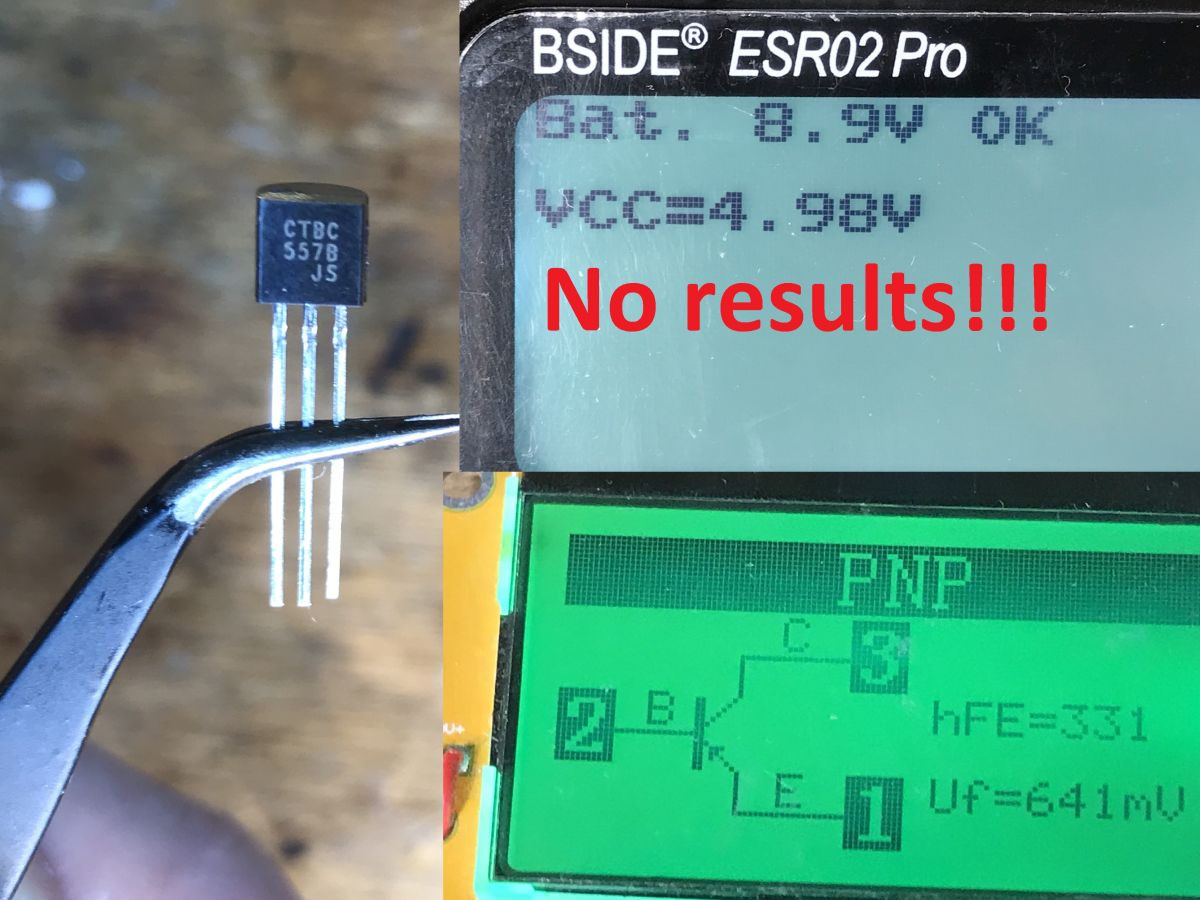

    BC557:
    The image shows a CTBC 557B transistor held by tweezers and the screen of the BSIDE ESR02 Pro tester displaying No results!!!.
    ESR02 failed again.

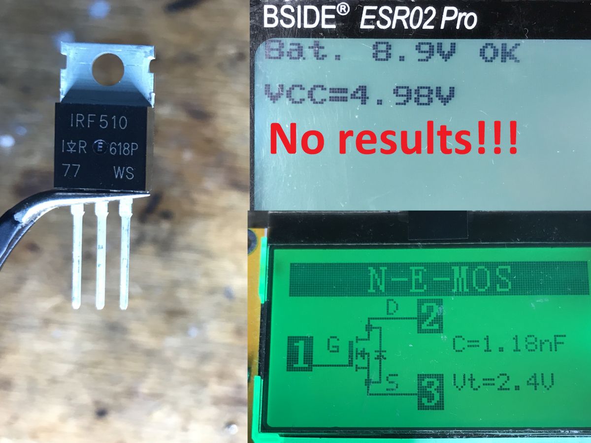

    IRF510:
    BSIDE ESR02 Pro component tester showing no results for IRF510 transistor.
    ESR02 failed again:
    Measurement of the diode voltage drop - quite good, both testers give similar results, Brymen underestimates:
    BSIDE ESR02 Pro component tester, LCR-T4, and a digital multimeter on a table.

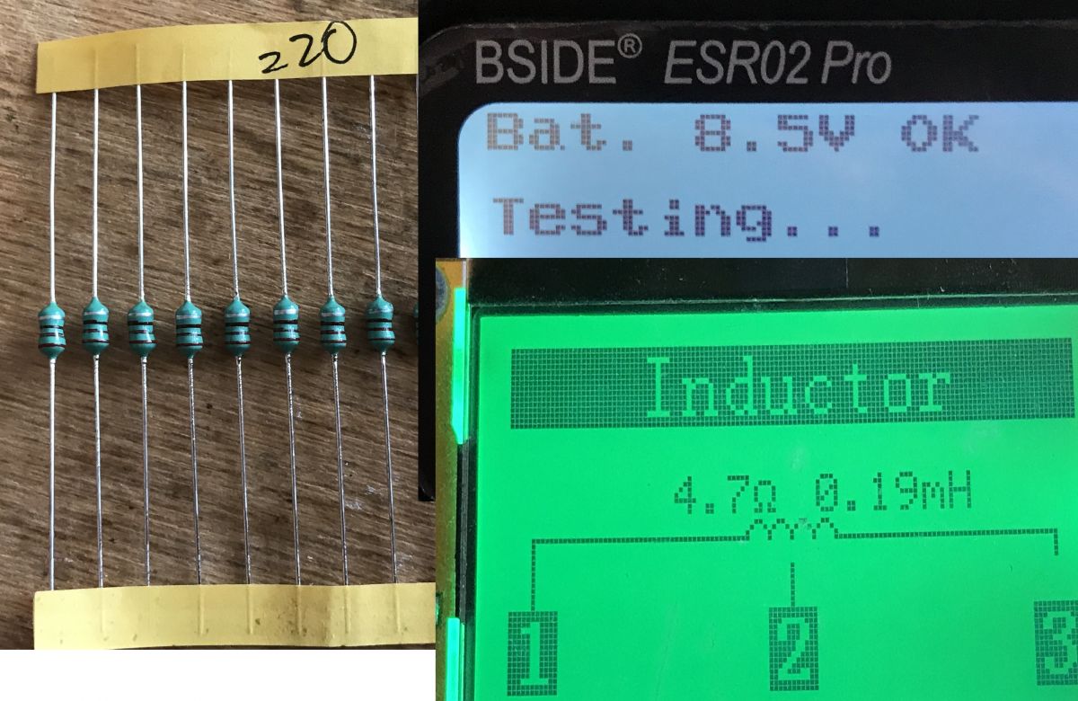

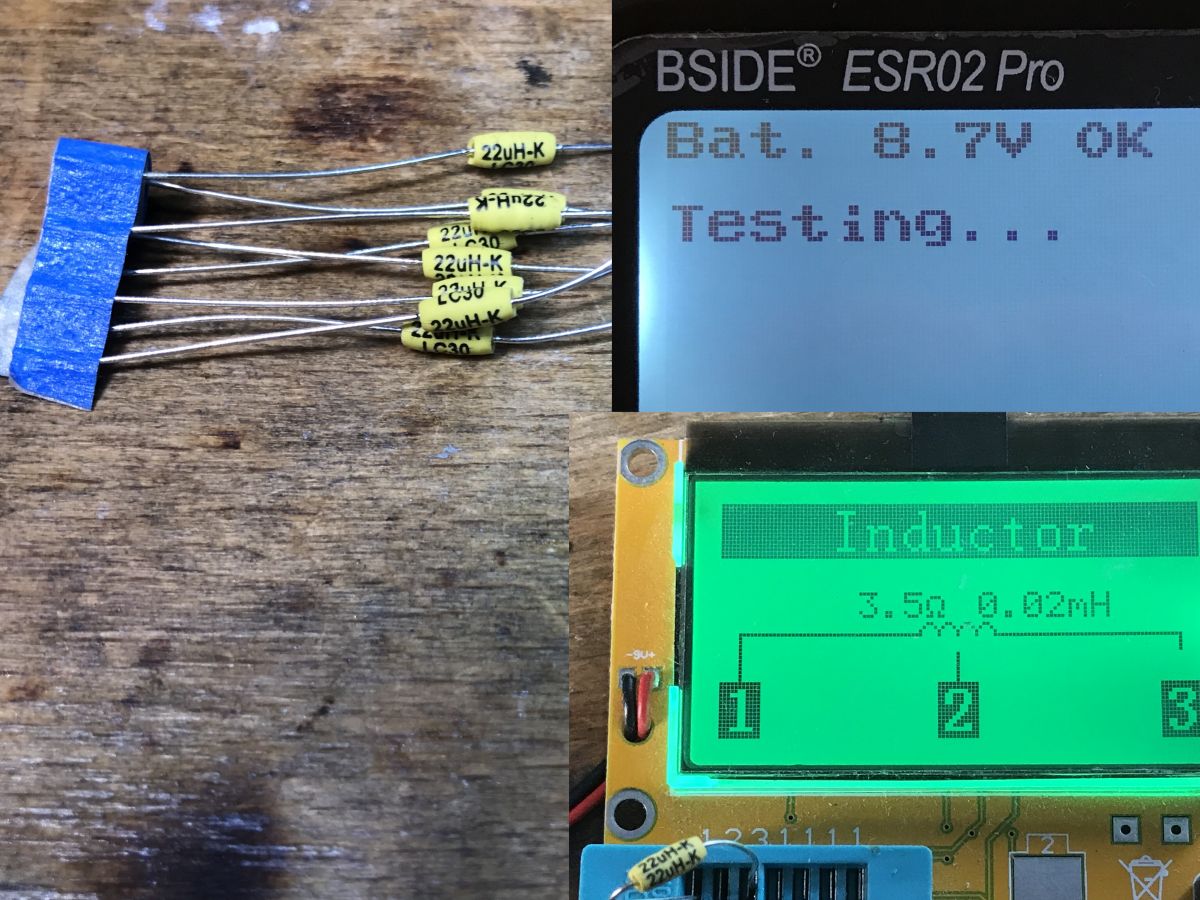

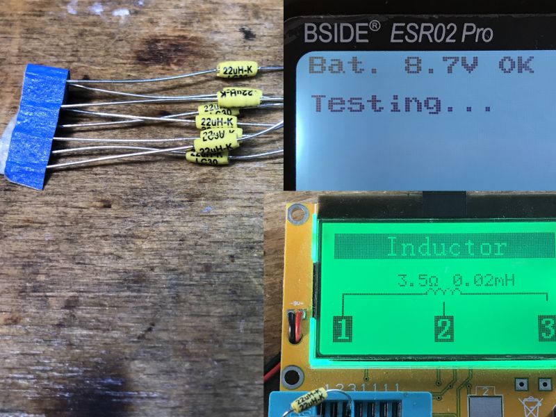

    22uH choke:
    BSIDE ESR02 Pro tester evaluating inductors.
    ESR02 failed.
    220uH choke:
    Image of the BSIDE ESR02 Pro component tester performing an inductor measurement alongside resistors labeled as 220 Ohm.
    ESR02 failed.

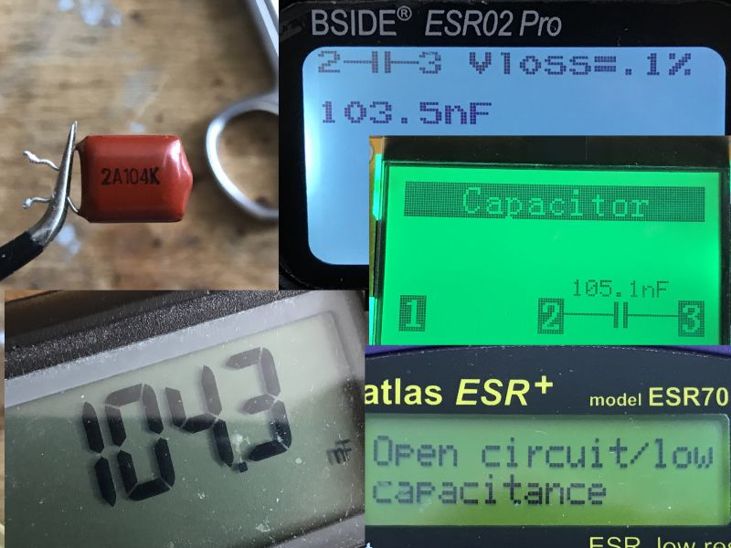

    100nF capacitor:
    Comparison of capacitor measurement results using three testers.
    ESR70 couldn`t handle it, but that`s not what it`s for.

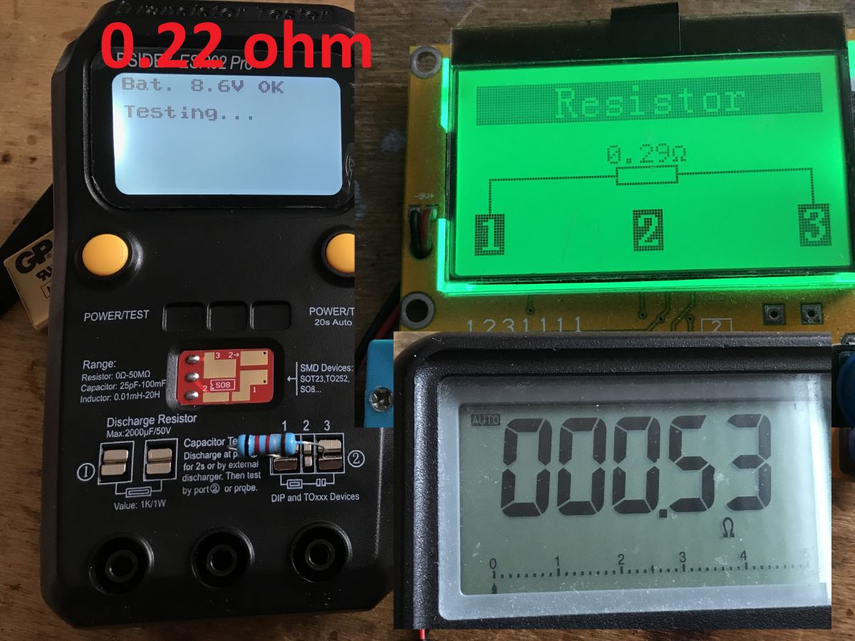

    0.22 ohm resistor:
    Comparison of resistor measurement results using three testers.
    Only the LCR-T4 showed reasonable results.

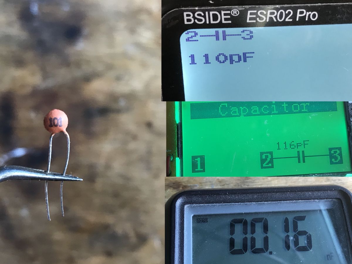

    100pF capacitor:
    BSIDE ESR02 Pro tester comparing capacitor values
    Brymen lost a bit.

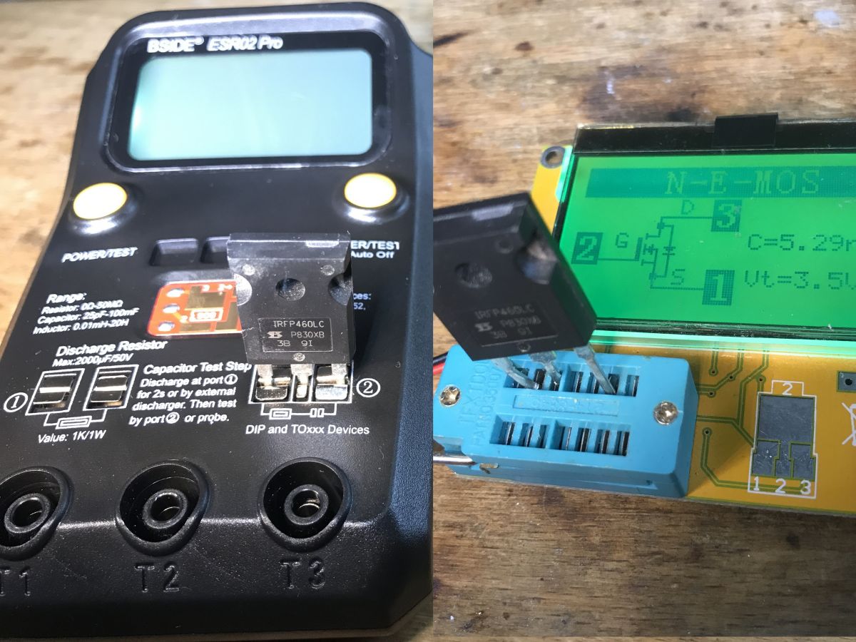

    IRFP460:
    Comparison of BSIDE ESR02 Pro and LCR-T4 component testers.
    ESR02 failed.

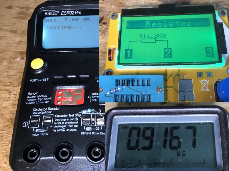

    1M Resistor:
    Electronic component testers BSIDE ESR02 Pro, LCR-T4, and multimeter.
    ESR02 failed...

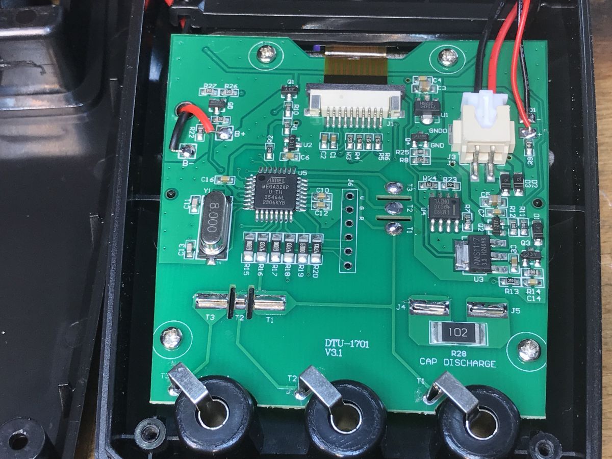

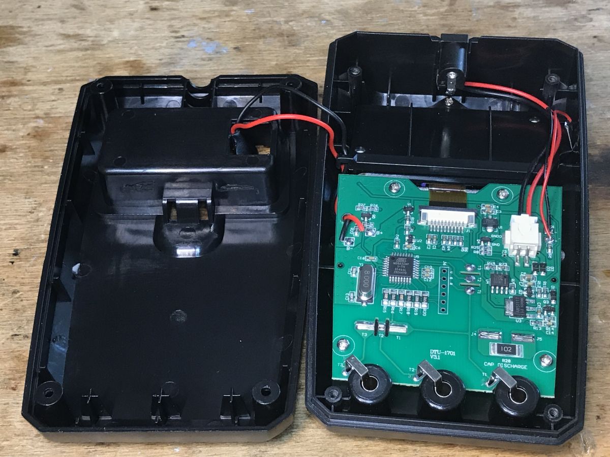

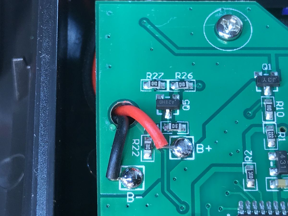

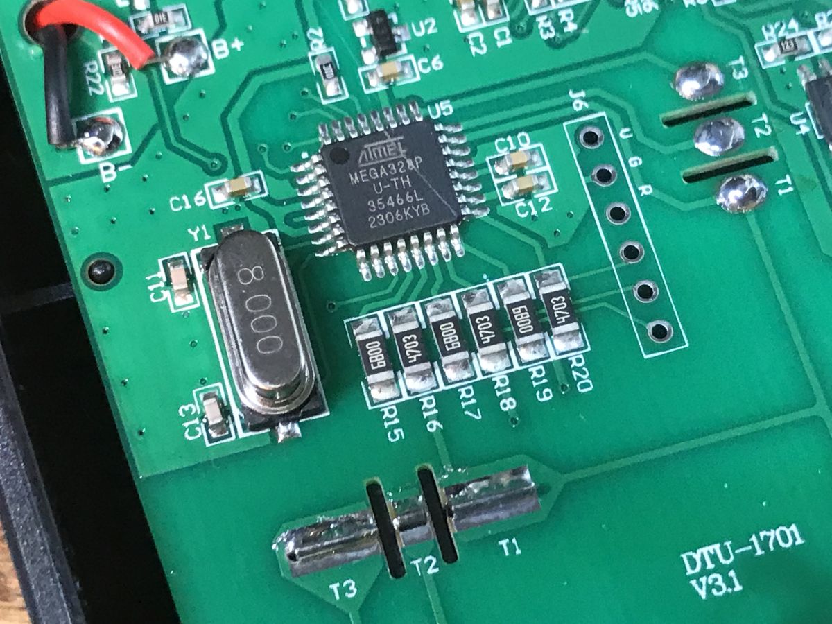

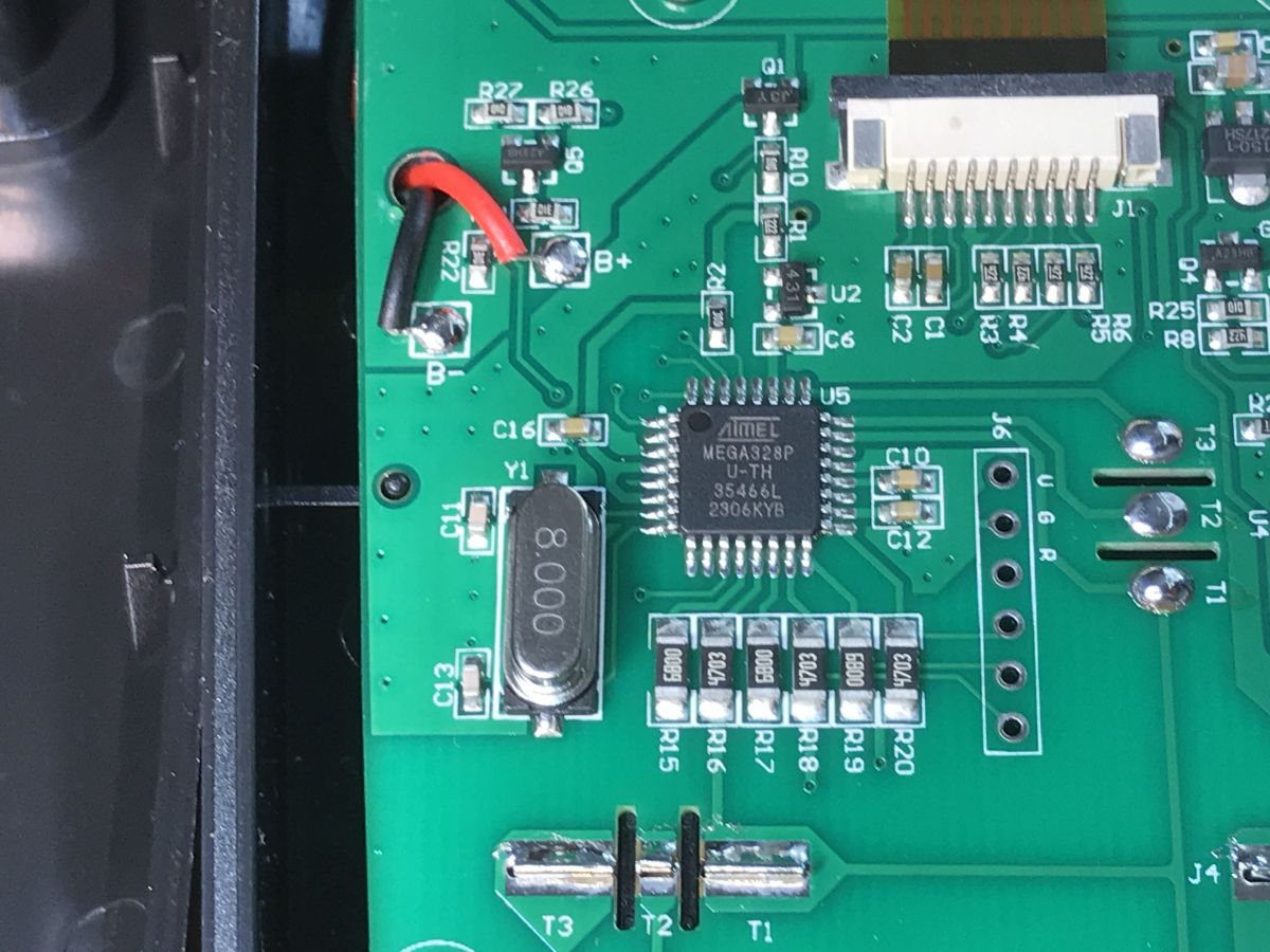

    ESR02 interior

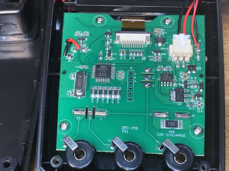

    Unscrew the screws and look inside:
    BSIDE ESR02 Pro component tester open with internal circuit visible.

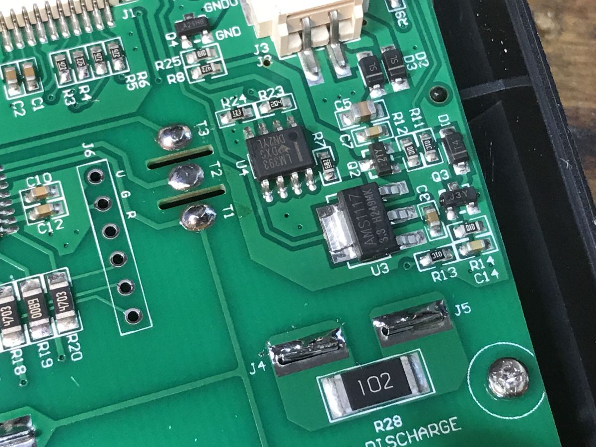

    Yes, this is another Atmega-based tester, here on Atmega328P.
    BSIDE ESR02 Pro component tester with visible Atmega328P chip. Inside of the BSIDE ESR02 Pro component tester with visible electronic circuits.
    In addition, we have a 3.3V AMS1117 LDO and an LM393 compatator inside.
    Close-up of the BSIDE ESR02 Pro component tester's interior with visible electronic components. Close-up of internal components of the BSIDE ESR02 Pro tester, showing wire connections on the PCB. Circuit board of the BSIDE ESR02 Pro tester with ATmega328P processor.
    Summary
    Initially, I thought that BSIDE ESR02 Pro would be an almost identical clone of the LCR-T4, but tests showed that it may be a clone, but it is worse. I don`t know, maybe I got a worse one, but even after repeating the calibration procedure, it didn`t want to measure some of the components. I`m starting to worry that I may need to change the firmware, but more about that another time. Anyway, I invite you to the discussion. I leave the specific analysis of the test results to you. Do you think ESR02 Pro makes sense? The case is nice.

  • #2 20892458
    acctr
    Posts: 4554
    Help: 389
    Rate: 2025
    I think it would be useful to collect some current and voltage waveforms from the tested element to see what these testers actually do.
    Without this, one can only guess blindly.

    I have had the LCR-T4 for a long time and I am very pleased with it. It`s true that I`m slowly looking for something newer and it`s good that you posted this test because maybe I would buy something worse than what I have.
  • LCR-T4 is sufficient for hobby capacitor testing

    Hmm, good idea with these waveforms, I basically already did this with the ESR70:
    ESR70 capacitance/ESR meter - interior, test, principle of operation on an oscilloscope
    so maybe it`s worth a try here too.
    And my side conclusion from the topic is that the LCR-T4 in the context of testing capacitors for hobbyists works well and there is probably no need to buy the ESR70, although the ESR70 also offers automatic capacitor discharge, but is it worth paying so much for it? ?

    Nice test, it`s a pity you didn`t measure these capacitors on a Fluk, Sanwa or other, or on a professional RLC bridge.
    For measurements, did you use new or exhausted capacitors?
    I was most interested in the capacitance measurement part because I evaluate the rest of the elements, such as diodes, transistors and resistors, by measuring them using the diode or resistance test.
    Capacitors are a nightmare, I often know that the electrolyte is damaged because after replacing the device comes to life and the meter shows that the capacity is correct.
    In my private life I use the Kyoritsu KEW1012 meter, and at work I use the Fluke range of meters. As for Fluke, I have not been disappointed, and the capacitance measurement itself is quick, sometimes the measurement is correct, but the capacitor needs to be replaced.
    Kyoritsu measures large capacities around 15s, you have to get used to it.
    When I used to work in a service center, I used CHY meters, a CHY20 multimeter, a CHY15 capacitor and a CHY24 RLC bridge. I was pleased with them.
    I think that the capacitance measurement itself is not reliable, due to the fact that it is performed at lower test voltages than the voltage during capacitor operation, and in addition there is increased temperature, leakage and ESR.
    Sometimes, if there are several capacitors with the same capacity in the device, I charge them with the rated voltage and check their voltage after 5 minutes whether it is still rated and whether they all hold the same voltage, this is more reliable for me.
  • Tester readings vary; only clear capacitor faults are reliable
