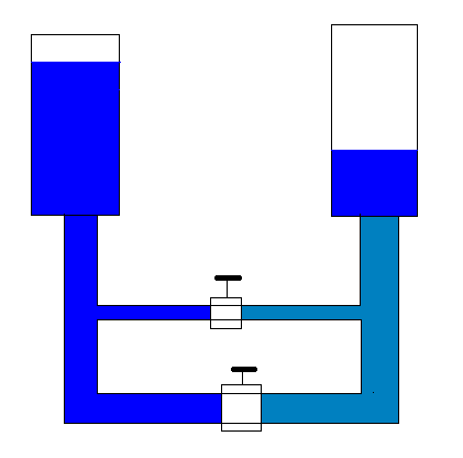

    Then maybe let's try to explain the water supply:
    Imagine two such tanks connected by two pipes of different diameter, and therefore of a different cross-section. There is a different amount of water in both tanks.
    Difference Between Voltage and Current in Electronic Circuits for Beginners
    When any valve is opened, water will begin to flow from the higher level tank to the lower level tank - this is due to the difference in levels in the tanks and therefore the different weight of water exerting different pressure.
    The level in a given tank is potential, in a way it's the ability to do some work.
    The resulting pressure difference is in our case the voltage.
    After opening the valve, the water will flow from higher pressure to lower pressure (it's like pushing a beam through two teams - the beam moves where the given assembly pushes less).
    A certain amount of water can flow through a given section per unit time (just like with a corridor of a given width, no more people will pass through it than can fit in the width).
    This amount of fluid flowing per unit time will be the intensity in our case.
    The intensity will be the greater the larger the cross-section of the pipe (because more fluid can flow per unit time).
    Depending on its cross-section, length and filling, the pipe will make it difficult for the fluid to flow through it in different ways, this hindering is the resistance to the fluid:
    - the cross-section increases - the passage capacity of the pipe increases - the resistance decreases
    - length increases - time to travel the length of the pipe increases - resistance increases
    - we fill the pipe with, for example, balls - we reduce the cross-section of the pipe - the resistance increases
    the latter with balls shows materials with different resistances - the finer the balls, the more tightly the pipe cross-section is filled and the less space the fluid has to squeeze through, i.e. it has greater problems with the flow
    If a larger stream of water flows through the pipe (higher intensity), then more work can be done because the fluid acts with greater force.
    Pipes with different cross-sections offer different resistance to the flowing fluid. It is similar with cables of different cross-sections, the smaller the size, the more difficult it is for the current to flow through it.
    Returning to the electric field. There are different amounts of electrons in different places. Each electron has an electric charge attached to it. Electrons repel each other as single-name charges. The more there are in a given place, the greater the repulsive force.
    If there is a different number of electrons in two places, there is a potential difference (i.e. such a pressure difference on the electrons) and they will want to move from the place where there are more of them to the place where there are less of them. The will to move will cease when there will be the same number of electrons in both places (because the forces will balance).
    In the system, the place where there are more electrons is called the negative pole and where less positive.
    Since electrons are the carriers of a portion of the current (the flow of a charge of one electron in 1 second), the real current flows from the more negative to the more positive place.
    In the past, the physical mechanism of the current flow was not known and it was assumed that it flows from the positive place (positive -> means better -> so this is where the current must flow) to the negative one, although it is actually the opposite.
