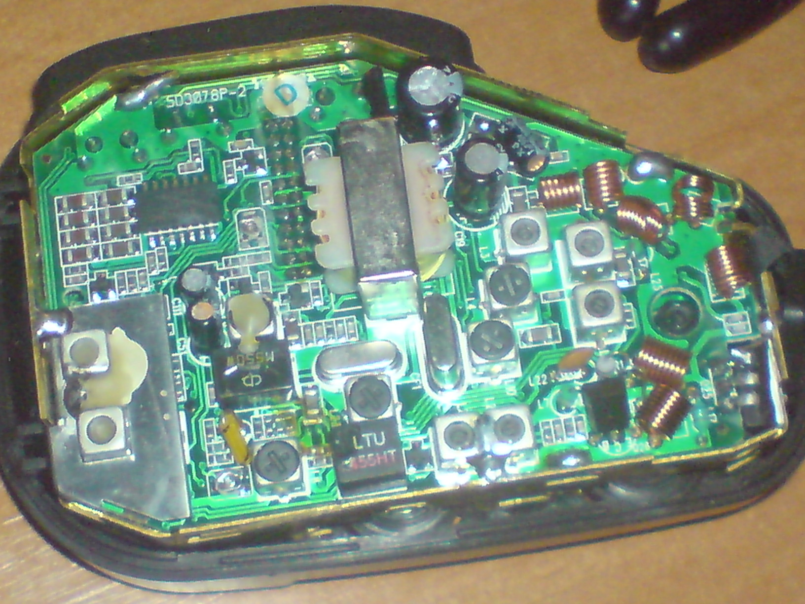

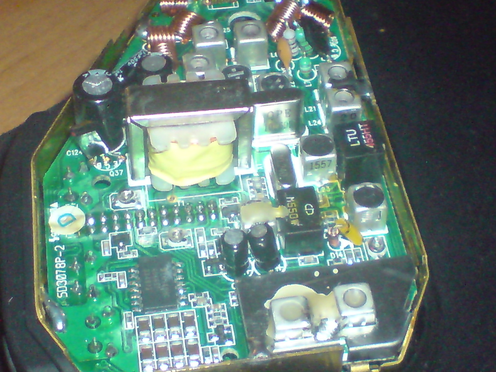

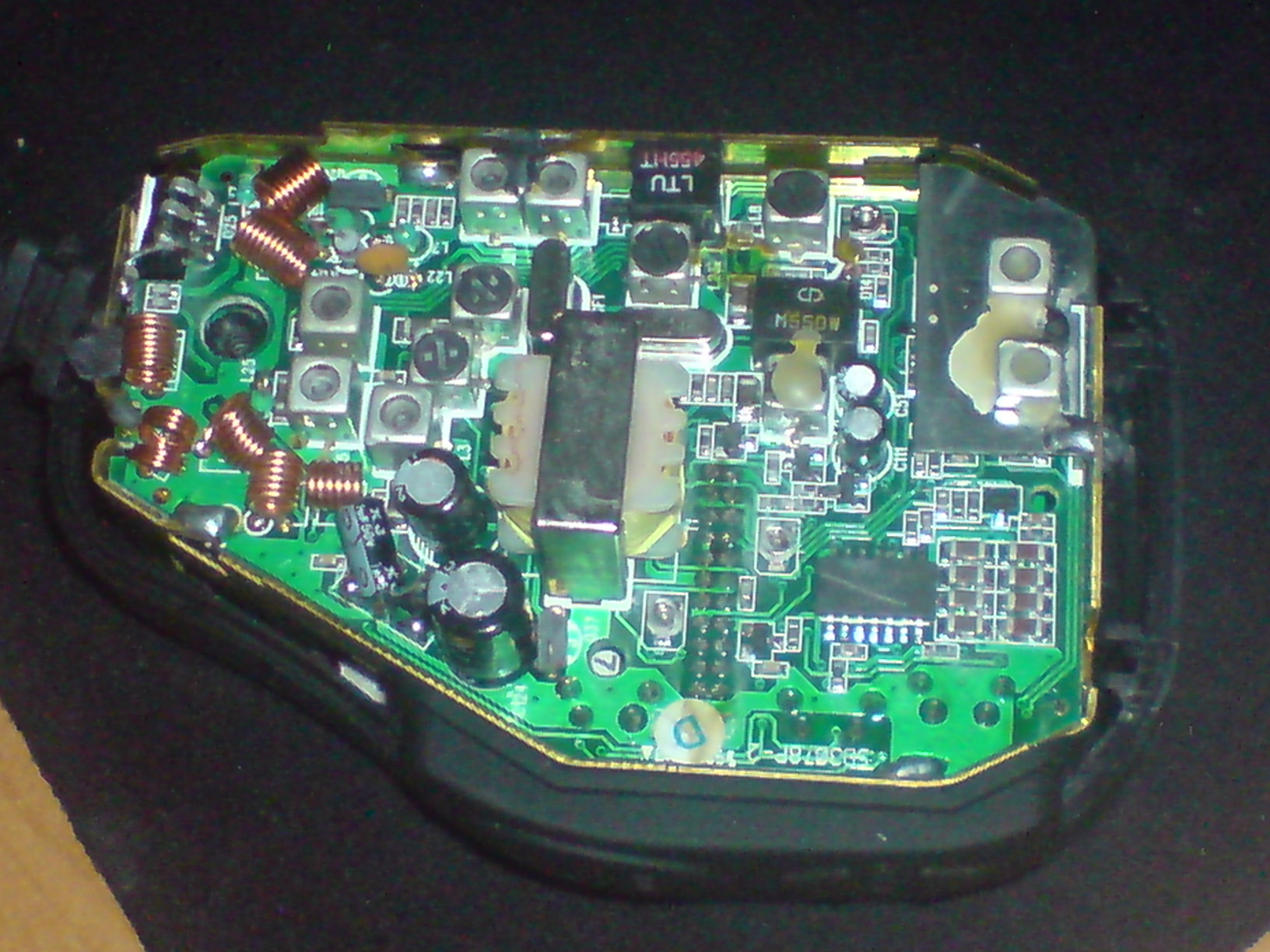

    For more than two years, I've kept the radio in a drawer and I do not have time to tune it in, and they do not want to do it in local websites.
    In connection with this I have a question, is the radiosko deviating from those in normal boxes, apart from the general construction?
    I attach photos for better case recognition. For those who are not oriented, I will add that the radio is in the ;)

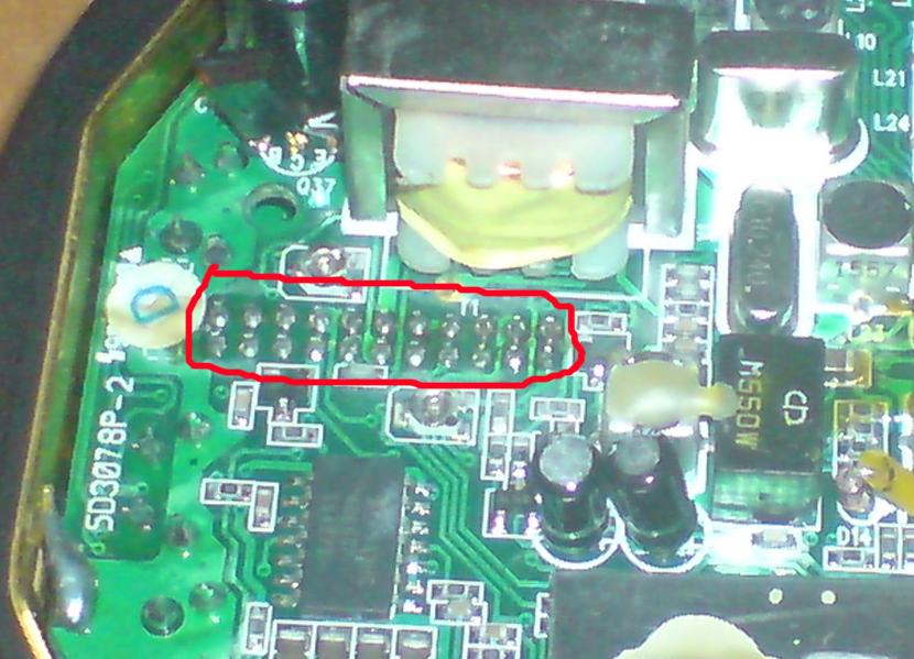

    This CB is made on two plates, the top and bottom are connected by a multi-contact socket which I marked with red.
    Tuning Cobra 75 WX ST Radio: Step-by-Step Guide, Comparisons to Normal Box Radios, Photos Included
    You have to solder the upper plate, remove it, and connect the whole with a service connector. On the lower board you have a processor and jumpers you can set "zero".

    raszej wrote:
    I have the same radio and therefore I have a question: What is this service board?
    This is not just a service connector like SP8JUX :
    and connect the entire service with the
    connector
    The service connector is used to connect two boards with elements into one unit, so that the radio works properly and could be repaired or modified.
    Greetings.
