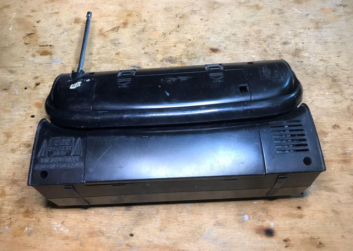

    Some time ago I showed the Fonics FN-105 radio, which turned out to be based on the CD7613CP chip, a so-called 'one-chip radio'. It even had an audio amplifier in it. Now it is time for another similar radio, but this time built slightly differently. We will look inside and analyse the PCB.
    Previous related topic in the series: Fonics FN-105 - CD7613CP .

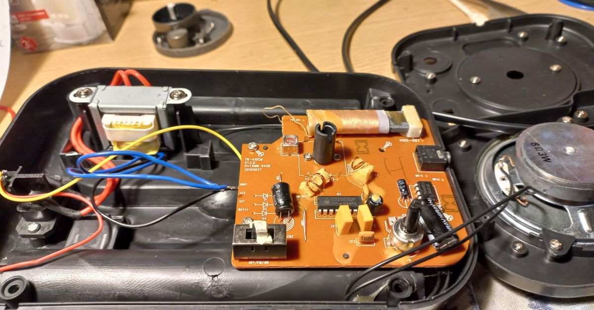

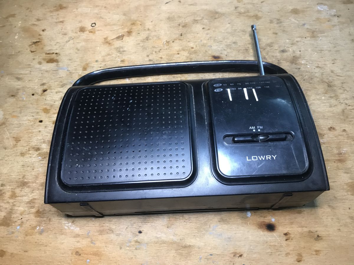

    This radio also belongs to a friend from the allotments and it too has this distinctive modification with a switch on the cable. The friend must like these switches. You can get quite a surprise when you open the battery slot:
    A black, rectangular portable radio on a wooden surface, viewed from the top and back; an extended telescopic antenna is visible. .

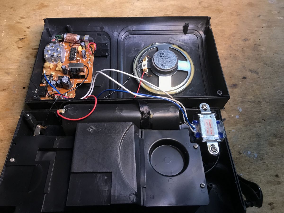

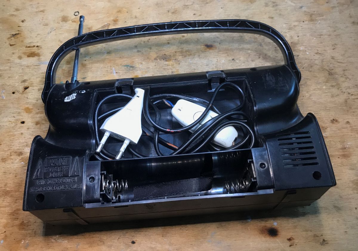

    Who would have expected:
    Open battery compartment of an old radio with a power cord and a switch stored inside. .
    Removing the case, inside is the speaker, one PCB and the mains transformer:
    Inside of an opened transistor radio showing a PCB, speaker, and transformer. .

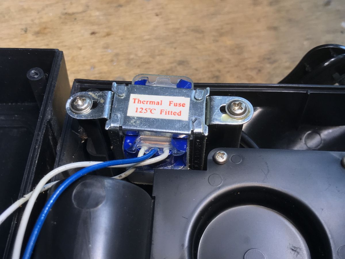

    Interestingly, the transformer has a built-in thermal fuse:
    Mains transformer installed in a plastic enclosure, featuring a visible 125°C thermal fuse. .
    I wonder how effective it is.

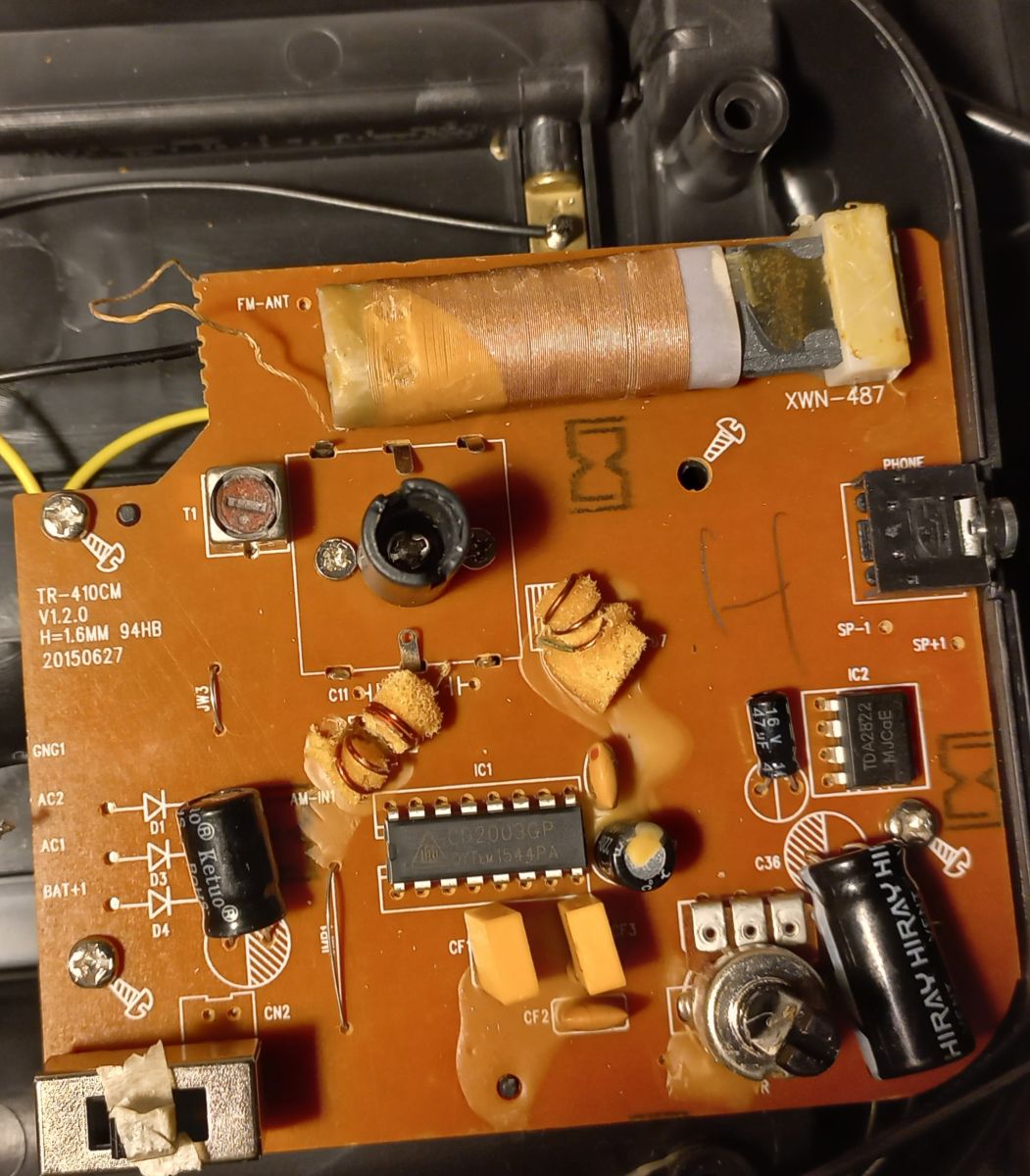

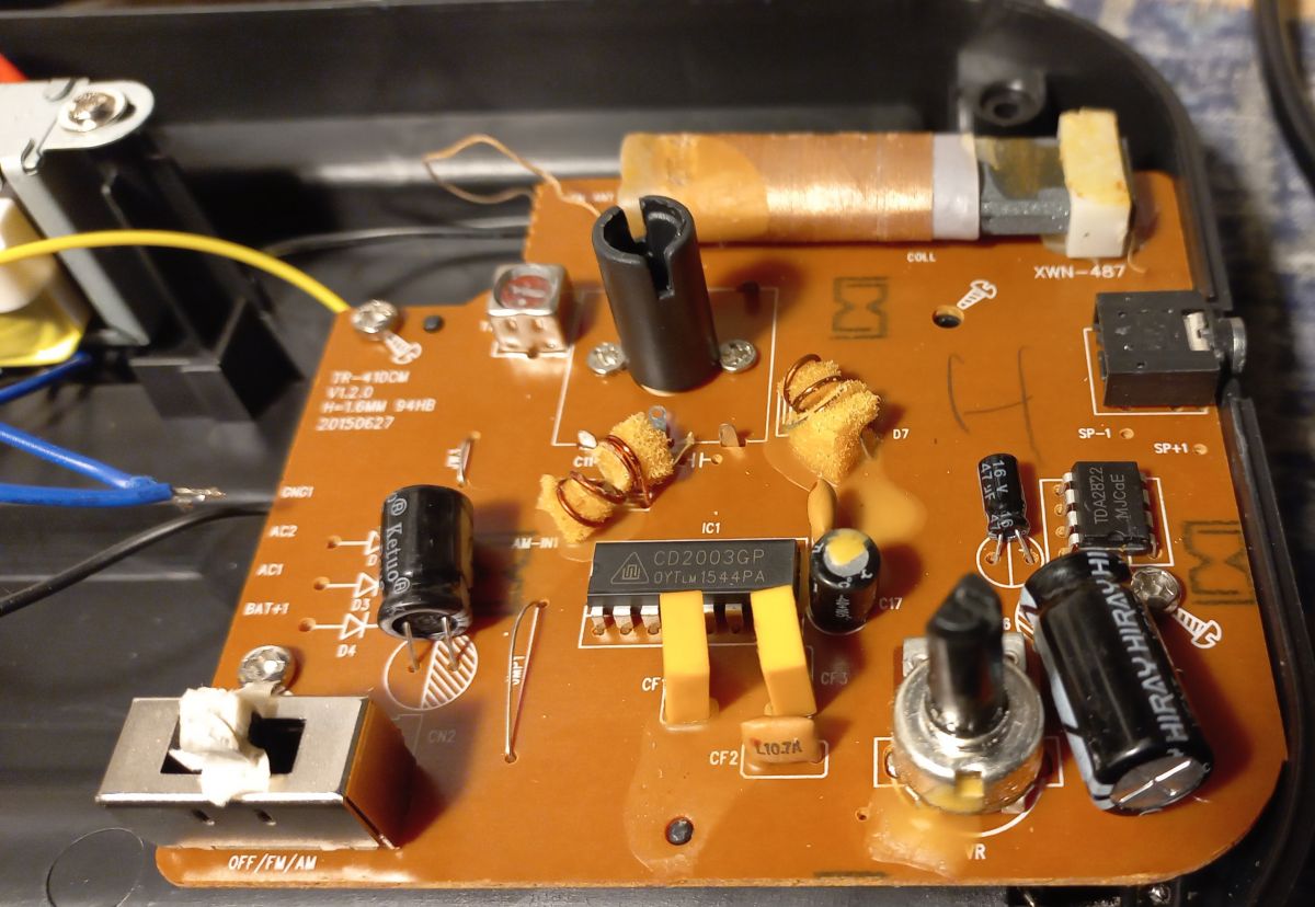

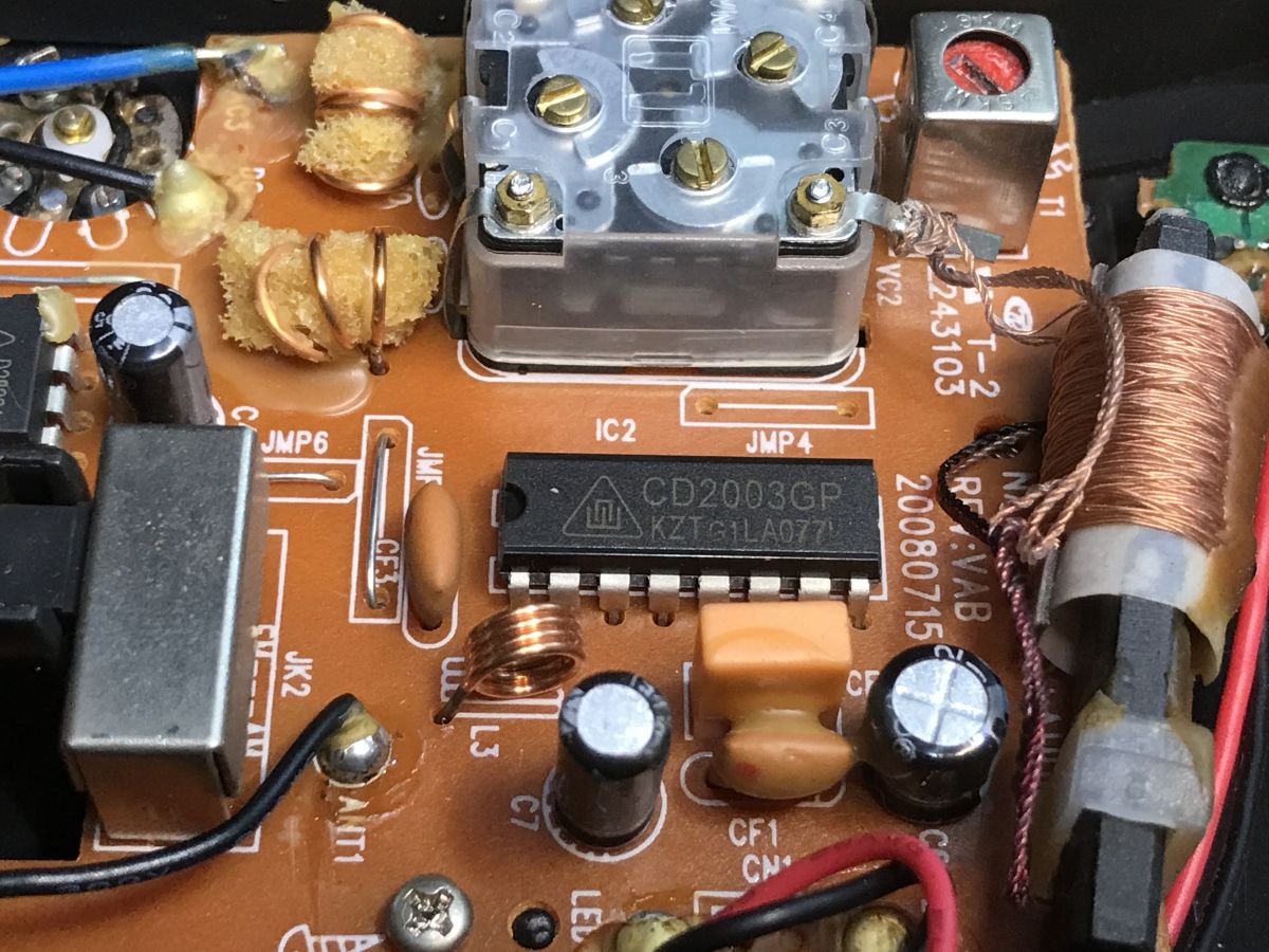

    Now the PCB itself, the layout is even simpler than before, apart from the obvious presence of a ferrite antenna and an adjustable capacitor used for tuning, here we have a headphone socket, a couple of properly protected air-core coils and this time two chips: CD2003GP and D2822A
    Close-up of a radio PCB showing a CD2003GP IC, coils, capacitors, and other electronic components. .

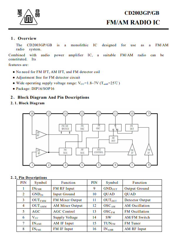

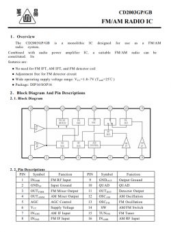

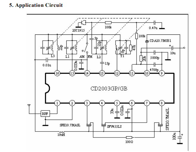

    Catalogue note:
    Section of the CD2003GP/GB datasheet with block diagram and pinout table. .
    Example application diagram:
    Application circuit diagram of CD2003GP/GB chip with passive and active component connections. .
    I think I even know this schematic from somewhere, haven't I done a DIY like this before? But let's not forget the D2822A amplifier (looks similar TDA2822M?):

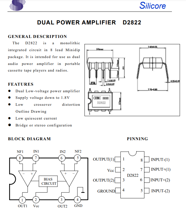

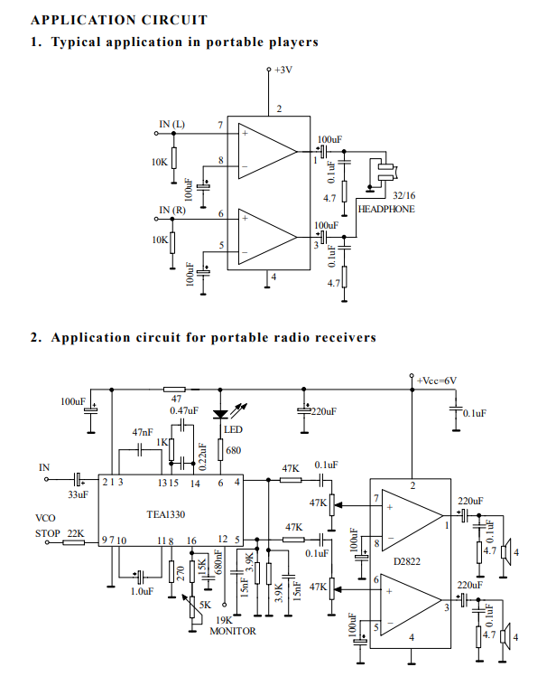

    Fragment of the D2822 audio amplifier datasheet with block diagram, pinout, and package dimensions. .
    This die can be used in both mono and stereo applications:
    Two application circuit diagrams for the D2822A amplifier: the first for a portable player, the second for a radio receiver. .

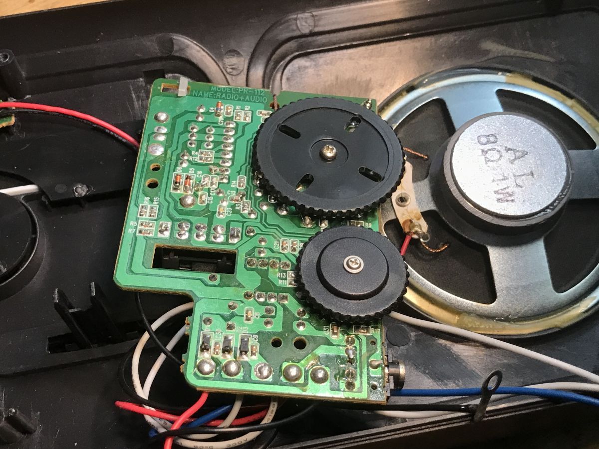

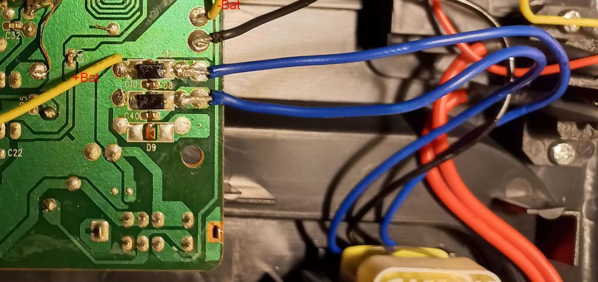

    Another look at the underside of the PCB - there are some SMD components here, this explains why the board is slightly smaller than I would have expected. The rectifier diodes are also surface mounted.
    A circuit board with two black gears and a visible 8Ω speaker inside an opened radio case. .
    By the way, the diodes are three and have small ceramic capacitors in parallel.... one of them probably protects the batteries, so either from the transformer there must be a single pole rectifier or the transformer is tapped?
    Judging by the fact that only two of the diodes have a capacitor, I would bet that there is a transformer with a split secondary winding....
    And I think that's it - there's one more photo of the whole PCB left:
    Radio PCB with electronic components, visible coils, capacitors, CD2003GP chip, and headphone jack. .

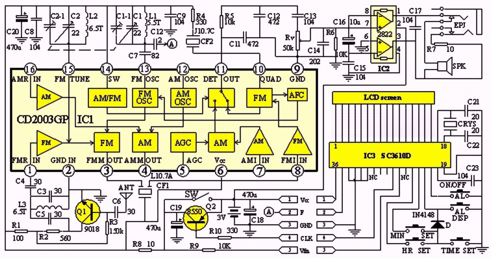

    This is interesting, the previously described Fonics FN-105 was based on a single chip, the CD7613CP, and had no SMD components, here they have introduced a bit of SMD already, but the amplifier and radio circuit are separate.
    The CD2003 used here is a classic, and I have seen DIY projects/kits to assemble on it, including even a project with a frequency display:
    Block diagram of a radio circuit with CD2003GP, 2822, and SC3610D integrated circuits and labeled connections. .
    Here the SC3610D is used in conjunction with the CD2003. If you are interested, you can look for this kit to buy online, although I would rather be tempted to DIY modify a ready-made radio.... maybe it would be possible to buy an SC3610D, only probably worse in terms of cost, all of which would make it just art for art's sake.

    This time you've come across better grade equipment. On the board you can see two ceramic filters and a resonator. These contribute to the better selectivity of the radio.
    Transformer with split winding (two white and middle blue).
    Thermal fuses are quite effective in such traps, I have had a few pieces of equipment where they have worked after a short circuit and heat up.

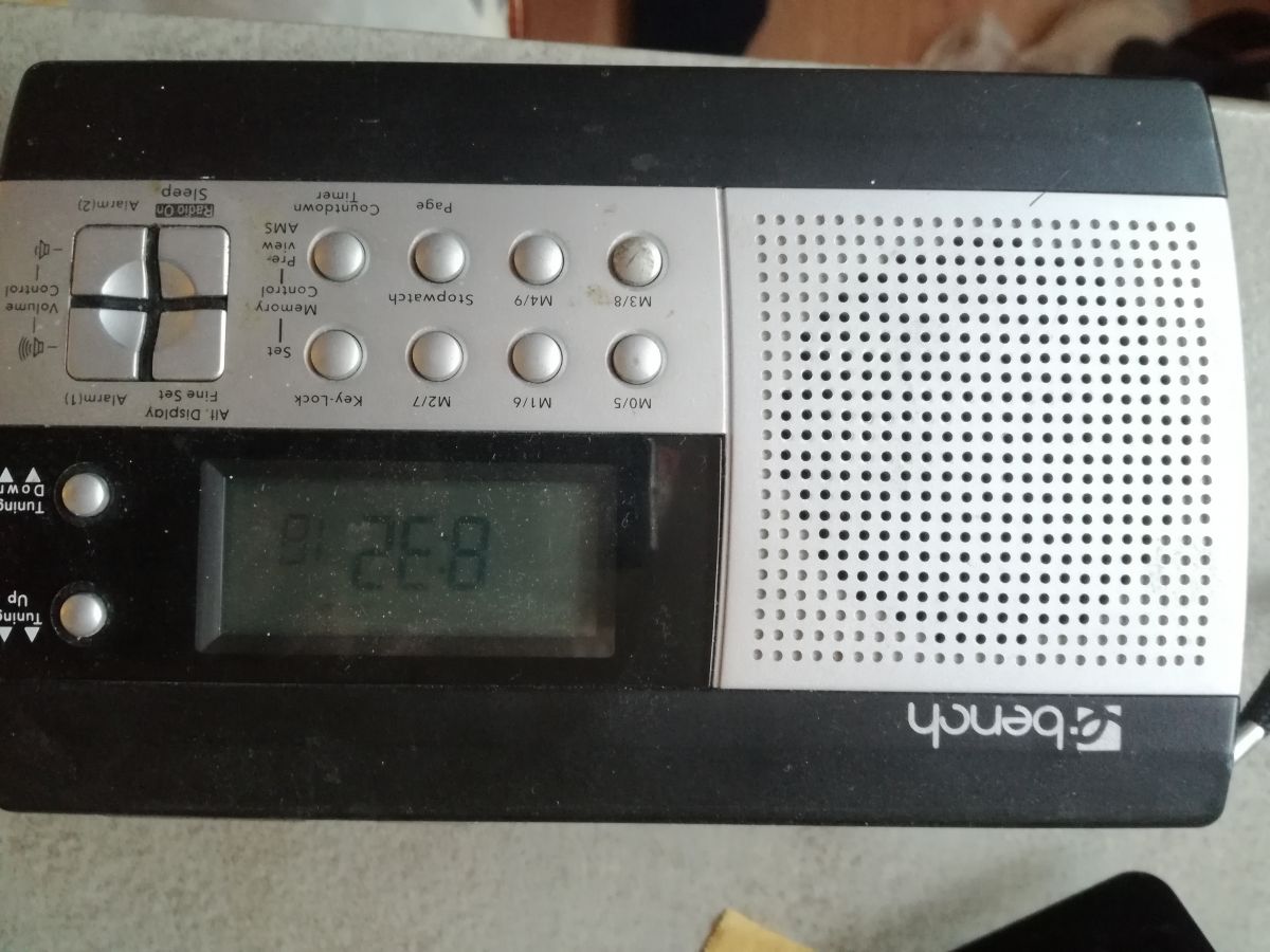

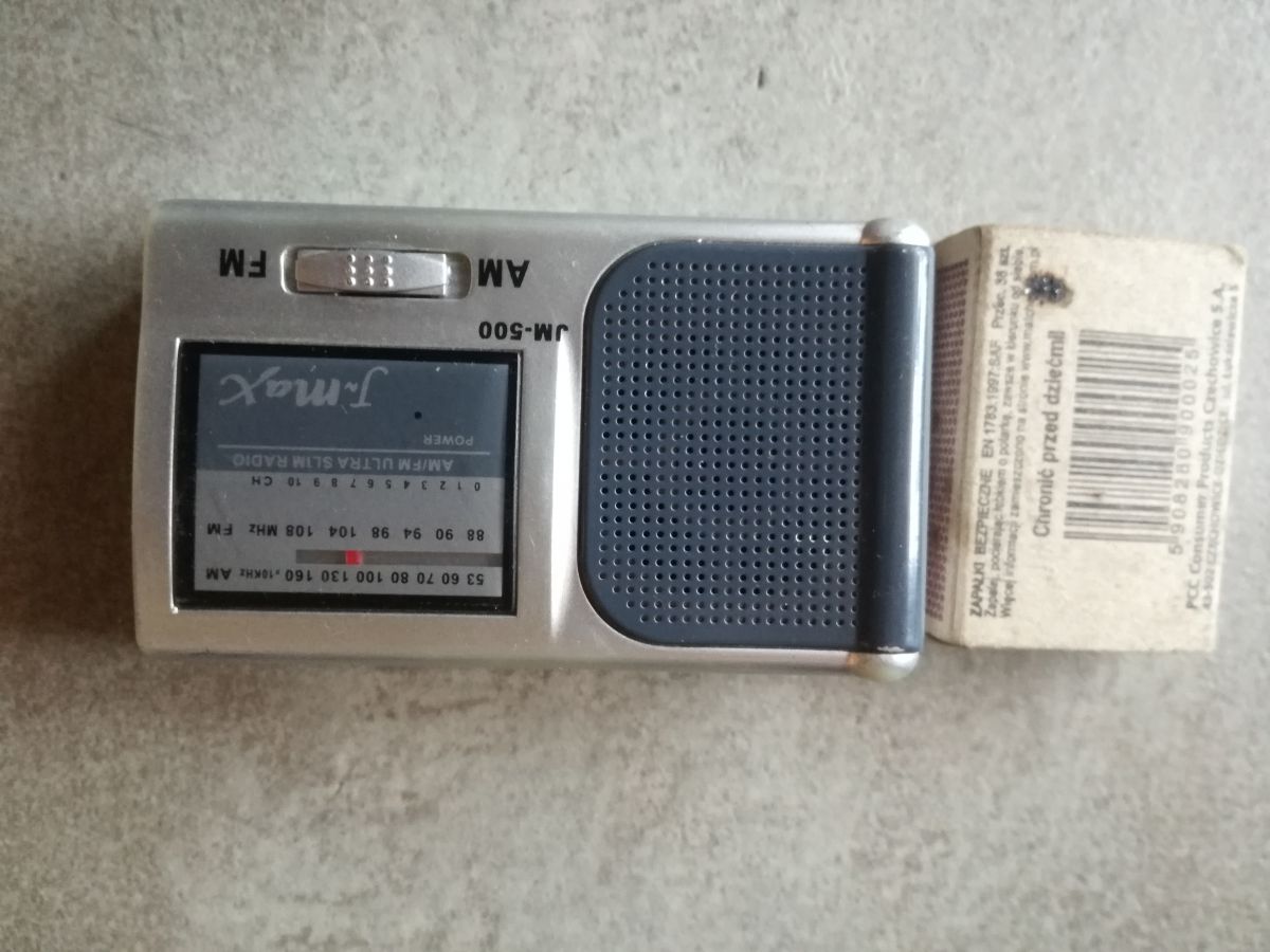

    About 10 years ago, when "Everything's 3 zloty each" except what's five 😉 in the shops, you could buy various models of miniature UKF FM receivers that searched for stations by scanning the band up and down. Once one I came across a receiver that allowed manual tuning . At its heart was the SP2003 chip .

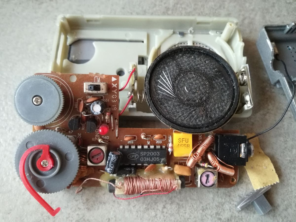

    I've come across the CD2003 a couple of times and even have one (from the outlet). Quite popular in Chinese radios.

    A small silver Jmax JM-500 portable radio is placed next to a box of matches on a light surface. Interior of an old portable radio showing the circuit board, speaker, and electronic components. .
    This is what the first one looks like and the second is a Bench from Lidl, D, ¶, K, UKF waves. Also for 2003.
    Bench portable radio from Lidl with LCD display and silver buttons. .

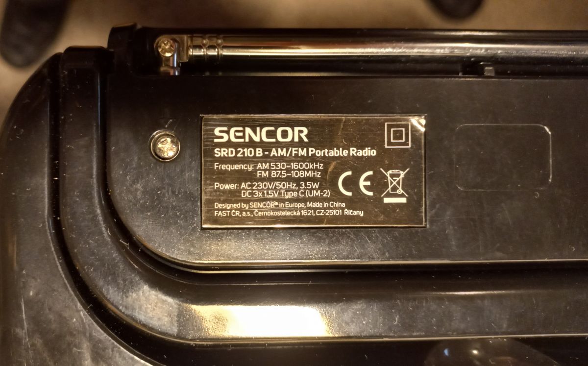

    A neighbour also threw me a "Sencor SRD 210B" radio on CD 2003 and TDA 2822 chips. The radio is humming, no FM or AM reception.
    Power supply from 3 x R14 batteries, i.e. 4.5V, and 9.7V from the power supply! Behind trafo on desoldered wires 7,9V .
    The amplifier is in working order so I guess the trafo and CD 2003 hit.
    Is it possible to buy such a circuit?

    kristof_61 wrote:
    Is it possible to buy such a deal?
    You can, they are on Aliexpress. There are still chips left from disassembly if you don't want to buy there, find a donor or someone who has one. I have one, but I don't know if it's working.
    Another issue is the viability of repairing this radio....

  • #15 20854768
    kristof_61
    Posts: 85
    Rate: 15
    Board Language: polish
    There are 2 offers on the web for about PLN10 each + postage. In my shop they demand 32 zł. What about the voltage from the 9.7V power supply? The power supply parameters for this circuit are 1.8-7V.

    And this is probably the cause. My radio from Lidl has a 6V power supply at idle.

  • #21 20859621
    kristof_61
    Posts: 85
    Rate: 15
    I wrote that two diodes in parallel. Image of a circuit board with two diodes connected in parallel, using wires in different colors. .
  • #23 20859911
    398216 Usunięty
    Posts: 34010
    Help: 3912
    Rate: 9182
    You don't know what a parallel connection looks like.
    This is a rectifier circuit using two secondary windings - it needs two diodes.
  • #24 20860017
    bratHanki
    Posts: 5658
    Help: 451
    Rate: 1367
    Maybe not so much two secondary windings as one with a tapping in the middle. Layout-wise, it's two single-voltage rectifiers, each operating in a different half-period.
  • #25 20860246
    398216 Usunięty
    Posts: 34010
    Help: 3912
    Rate: 9182
    How this is wound is a secondary matter anyway, we have two windings whose centre is connected to earth. And whether two or one with a tapping is a technical matter of the winding itself.
    As a practitioner (because I've wound THOUSANDS of transformers in my life) I can say that technically the "middle" from the "tapping" differs only in where the start of the second winding is shorted to the end of the first. In the case of the taps, this is done just at or on the winding itself, in the other it is done outside the transformer winding.
