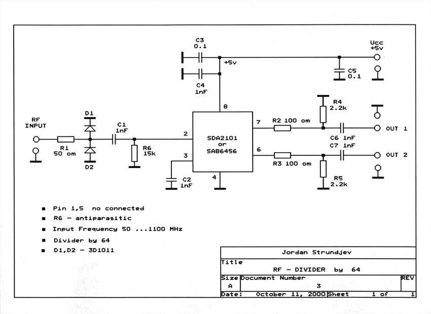

    I recommend SDA2101 (replacement SAB 6456). I used it in a frequency meter built on the PIC. The above description is from 40 to 1100 MHz, but in practice it turned out that it correctly measures from 2 MHz to 1260 MHz. Probably maybe more, but I did not have a signal with a higher frequency. It is necessary to secure the input with diodes. I used one of you (from the sixth leg)
    • ICs or modules for prescaler with fmax >= 2GHz and TTL output for 90S8535? sda2101.gif (39.66 KB) You must be logged in to download this attachment.
