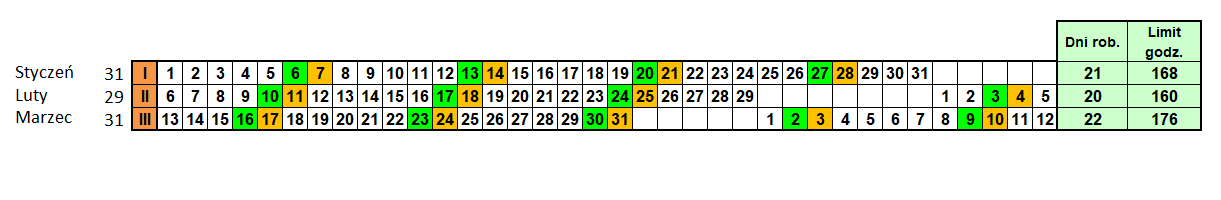

  • #30 18921121
    mieszko I
    Posts: 483
    Rate: 71
    Excel 2019 - only count white cells and only with text.
    From what I read, there is probably no such function available, will someone proficient in VBA help.
    The point is for the function in the "Working days" cell to count (sum), only white (or selected color) cells with text only (color without meaning).
    Excel 2003: Counting Cells by Background Color - Identify & Calculate Colored Cells in Spreadsheets
    • Zlicz_Biale_Pola_z_Tekstem.xlsx (11.38 KB) You must be logged in to download this attachment.
