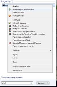

    Method 1. when we have access to a standard account or an account that has administrator rights.
    1. START> enter " CMD ", we right-click and choose" Run as administrator ".
    Windows 7 Admin Password Reset/Removal: CMD, Trinity Rescue Kit 3.4, Offline NT Editor
    2. Enter " Net user administrator / active: yes "
    3. Log in again and select the administrator account - from this level we can freely manage the computer. However, for normal computer use, it is better to create any account with administrator privileges.
