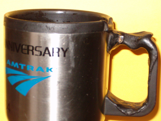

  • #18 1354973
    Łukasz Dolega
    Posts: 55
    Rate: 15
    MrHak wrote:
    At Discowery, a group of people check "fairy tales" like metal in a microwave oven. Nothing will happen, ie it will not explode, however, this should not be done. And why should you do it?
    However, my friend, I think he saw fairy tales on Discowers, decided to heat up the water in my mug by putting it in the microwave.
    After about 3 minutes, black smoke blew from the microwave and the flames were visible. The stench of inadequacy.
    The luck in the misfortune was that he noticed in time what was going on.
    The statement that nothing is going to happen is perhaps a little exaggerated.
    Defects found: increasing leakage of tea from my cup. :(
    • Microwave Cardboard Box Inside: Replacement & Material Composition (90 chars) HPIM0069.JPG (130.95 KB) You must be logged in to download this attachment.
