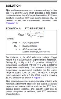

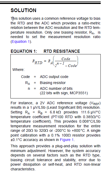

    Regarding the application AN1154 I would like to use Microchip Ratiometric measurement of PT100 temperature using the MCP3551 transducer.
    I read the description from this documentation and I can not understand from where and how the resolution and measurement accuracy were calculated and the resistance measurement itself. Therefore, I do not know how to write a temperature calculation program, based on reading from ADC.
    So please, explain this passage in particular:
      MCP3551 and PT100: Understanding Measurement Accuracy, Resolution & AN1154 Application
    As far as I know the 1 µ V resolution, I do not know why Ra and Rb are 6.8 k Ω and from where value 111.6 μ V / ° C and value 0.008 ° C / LSb ...
    The author of the application probably uses some simple patterns and rounding, so please help in deciphering all these calculations.
    A trade-off between signal level and self-heating.
    and where from value 111.6 μ V / ° C
    The entire divisor is 6.9k Ω RTD sensitivity is 0.385 Ω / ° C reference voltage 2V so 0.385 Ω / ° C / 6900 Ω * 2V ≈ 111.6 µ V / ° C
    1µV/111.6µV/°C
    Watch out for thermoelectric voltages, these ones look good on paper, but each combination of two metals is a thermocouple that can generate tens of voltages under unfavorable conditions µ V.

    And why is it 6.9k Ω instead of 6,8k & # 937 ;. Is 100 Ω with PT100, but why? After all, RA is everywhere as 6.8k Ω ...?
    Ok, so what does it receive as a result of ADC conversion, what represents the value of the Code and how to transform it into temperature? Lookout table every 1 ° C will be good? Fractional values count interpolation from 2 points?
    #4 13258582
    jarek_lnx
    Posts: 22638
    Help: 4183
    Rate: 6067
    So the sum, count like any other resistive divider in the nominative will be the sum.
    Have you ever had an analogue ohmmeter? here you have the same, only the "pointer" is digital, in the analog equivalent there was a nonlinear scale here too, you linearize by "equation 1", you get resistances from the resistance you will calculate the temperature.

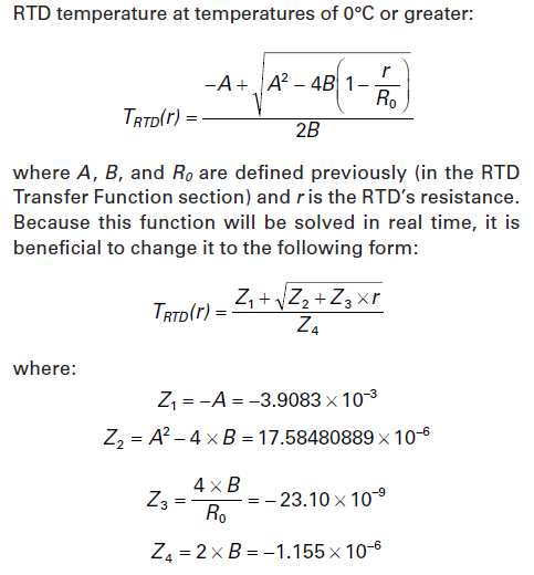

    I think that it is best to deduce t from the formula for resistance Pt100 and substitute the calculated resistances Rrdt from equation 1 for this formula.
    Just damn how to draw t from this formula: R = R0 * (1 + At + Bt ^ 2)

    As you noted in post # 5, the non-linearity of the sensor does not allow for such a simplification in such a wide temperature range.
    You have to solve the quadratic equation that you mentioned, it is difficult, because of some useful tips for implementation, I recommend to look at the application note Analog Devices AN-709.

    Thank you guy jarek_lnx, pattern with DIRECT MATHEMATICAL METHOD AN-709 (which defakto lay on my disk) solves my problem.
    Now since this equation:
    I will measure and face Rrtd, then from this:
     I will calculate the temperature.
    The calculations will take a while, but the system will control the heater so the calculation speed is not needed. As for me, this is the most convenient method, because you do not need a data table.
