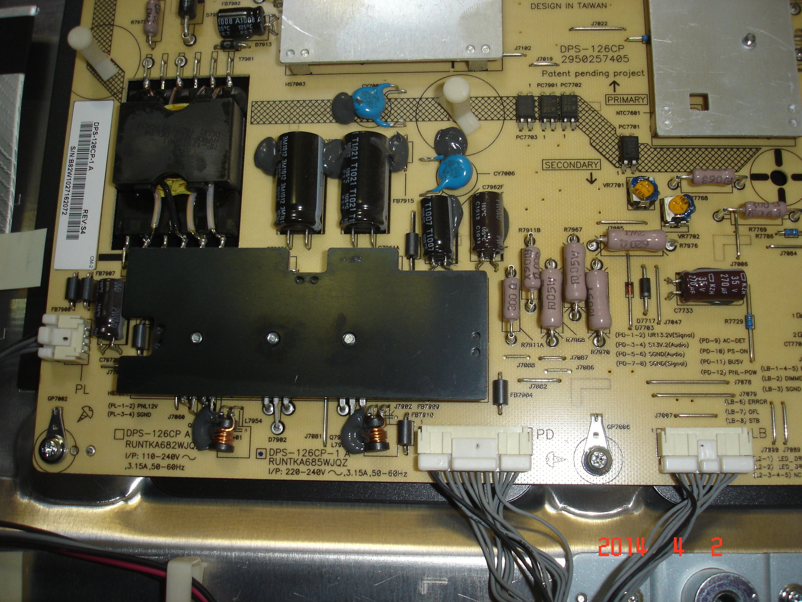

  • Hello everyone interested. The communication fault is 2 long blinks, we press the menu 1147 on the remote control and after a moment 2 long blinks of 5 quick ones. No 12V or undervoltage on t-con logic. Damaged voltage stabilizer 12V on the power supply, the one closest to the PU socket with 4 legs under this plate. Good luck. SHARP LC-40LE810E: Addressing 2 Long Blinks, 5 Quick Blinks, 12V Stabilizer & T-con Logic Issues
