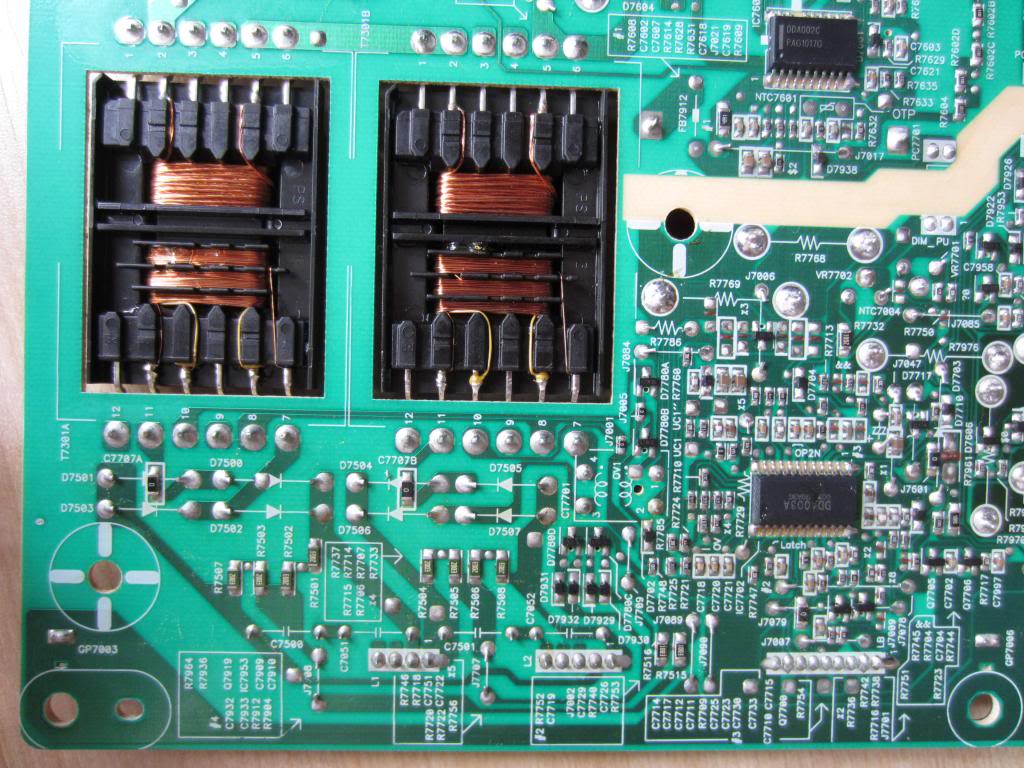

    I have a TV Sharp LC-40LE824E, for several days I have had a flicker of the screen after about 1 - 1.30 hours of viewing. After switching off the TV for some time and switching it back on, the effect disappears but returns after about 1 hour.
    Will erasing errors in the service menu help something? How to get to this menu?
    Possibly if it's the hardware fault, the reason lies in the power supply?
    The power supply model is: DPS-126CP-1A.
    I am asking for a solution to the problem.
    greetings
    Artur

    Here in this SM is not described Link or the second commonly available ftp://helpedia.com/pub/temp/datasheets/monitors/Sharp/Sharp_LC-40LE814E_LC-46LE814_LC-40LE824E_LC-46LE824E_[SM].pdf
    Verify and give what you have at home: descriptions with T-con, matrix and power supply.
    Provide a set of integrated circuits in the power supply.

    Buddy check the temperature of the black heat sink in the RUNTKA685WJQZ power supply. Take a fan and chill it. The KIA378R12PI stabilizer is overheated under it. Alternatively, to determine the cause, heat the heat sink with a hot air dryer or dryer, otherwise it will dissipate the heat with the cover and otherwise without it. You will not have to wait an hour. :D Check if the backlight starts going crazy and returns to normal after cooling down. Read my last post in the topic www.elektroda.pl/rtvforum/topic3047339.html

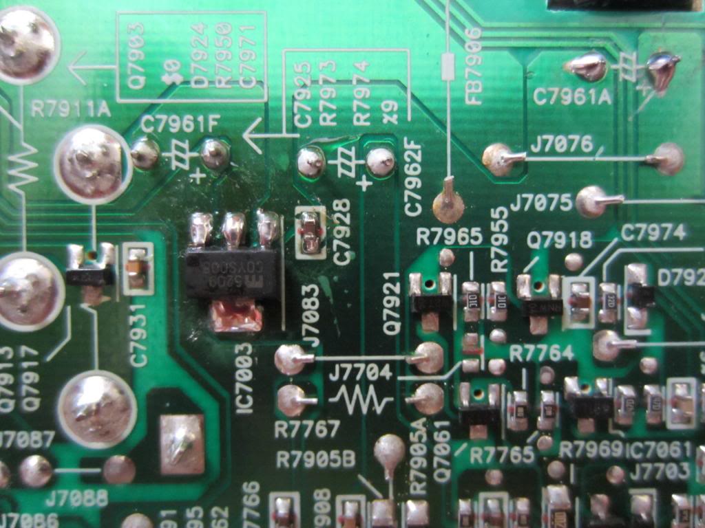

    And this is already strange, because after the appearance of the defect I changed the paste on the MX2 and tightened everything to the max and on all 3 heat sinks.
    I will try to tighten something to this heat sink. Preventively I drilled some holes at the very top of the case in the warmest place for better cooling.
    In addition, I had the same symptom as you, regarding the flashing of the matrix backlight after turning off the TV.

    I'm coming back with the topic. Despite the efforts to cool as much as possible, the black heat sink still occurs. I replaced the previously indicated stabilizer and increased the radiator surface. Additionally, getting rid of paint in places where elements meet.
    An additional defect that I observed after some time when it blinks stops and locks at the highest brightness, the brightness adjustment in the TV menu does not work.
    The conclusion is that some TV element consumes more power while overheating this stabilizer.
    At the moment the only thing that comes to my mind is to add a fan. The only question is what to feed it to turn on when turning on the TV and turned it off when turning off the TV. It's best that it is not 12V and about 8V.
    Possibly where to look for the fault?
    greetings
    Artur

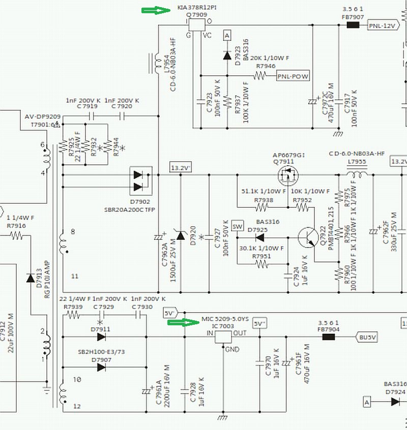

    Provide ICs in your PSU.
    RUNTKA686WJQZ to DPS-141CP 1A> somewhere I have MS, then I will find and give it in diagrams
    IC7601 DDA002C
    IC7702 DDA003A-5G240
    IC7801 NCP1608 * PFC
    Sharp LC-40LE824E - Flickering backlight after approx. 1 hour of operation
    __________
    In Sharp LC-40LE820M with RUNTKA687WJQZ the problem was with IC7003 (MIC5209-5.0YS) + elements C7928, C7961A, D7907, R7939, ... * ambient measurements
    (' :!: ') This stabilizer heats up because you put on "classic" >> it has to be LDO (low-drop) small voltage drop between input / output. IC

    lisek wrote:
    (' :!: ') This stabilizer warms up because you assume "classic" >> it has to be LDO (low-drop) small voltage drop between input / output. IC
    Who told you that he was moving at all? ;)

    Can you confirm unambiguously , that the cause of this fault is the overheating stabilizer 12V ??
    Or maybe in a different way ... though timidly, I will ask.
    What connection with the backlight have the elements on this heat sink?
