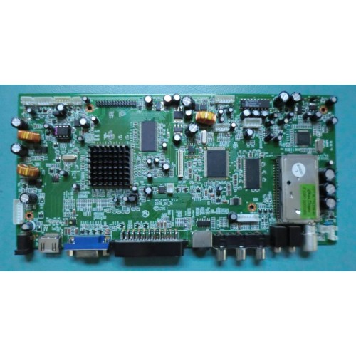

    Hi, friends! I would like for software lcd equipped with this memory type of 24C32.The problem is that came with symptom: Currently backlight of the keyboard execute commands, but when accessing the Setup menu, the menu disappears and does not take any comands.In the absence a suitable dump I put an empty memory that functioned correctly, that involves the DVD, remote MFY (code 201) .A few days comes back to the same event, replacing again the EEPROM 24C32 and again functions and ... in again make the same chassis model problem.Maybe you can help me, thanks in advance!From Romania, Cluj-Napoca, best regards!
    The mainboard has code : HD_D7102_V3.0. Thanks!

    Problem solved: power supply LM1117 ADJ( 1,8V) on the main board defective (1,6V~OUT).Thanks for views, from Romania the best regards!
