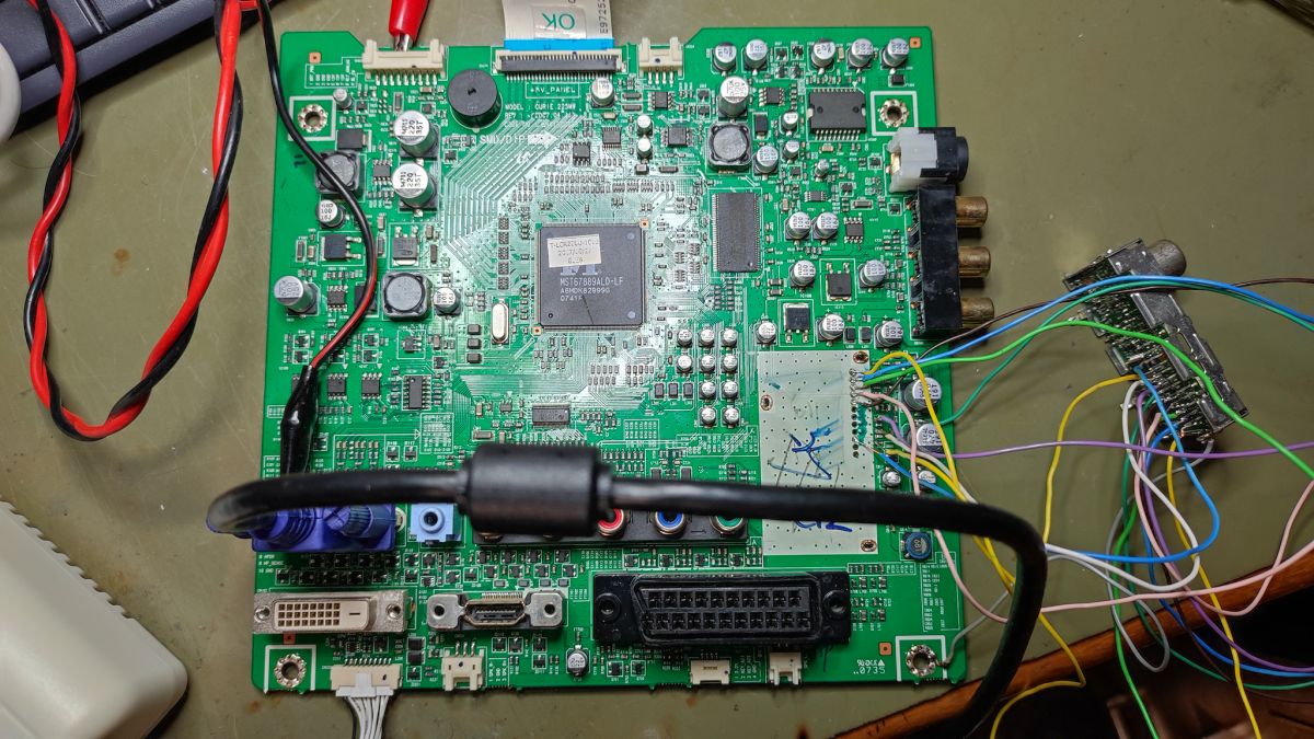

    I got an old Samsung 225MW TV with BN41-00825 motherboard.
    Since the TV has a buzzer when it starts it makes a beep. The main problem is that the TV goes in a sort of bootloop and beeps every 2-3 seconds.
    So I attached the VGA UART cable and read the debug data using a RT809H programmer:

    According to the Service Manual all the voltages looks good, so I made a backup of the internal flash and all the EEPROMs (1 Settings + 3 EDID) and cleaned the EEPROM.
    Now the TV boots but it's stuck on VGA. If I try to change the source it goes to TV, restarts (beep) and returns to VGA.

    I replaced the EEPROM and retried again and it's all the same.
    I removed the Tuner and tried again but pretty same stuff (with only the addition that the board can't communicate with the tuner via i2c).
    I've also tried with another flash dump but same stuff.

    I also opened the tuner box to check around and the demodulator "TDA9886TS" heats up a bit even if it's not in use and the entire box absorb around 120mA when powered.
    Unfortunately theres nothing useful in the service menu and most of stuff is made via WinDDC that I don't have (neither the Samsung Jig to connect to).
    Before trying to replace the Tuner module do someone have any suggestion?
    Thank you.
    Samsung 225MW TV motherboard with connected debugging cables
    AI: Could you provide any specific error messages or codes you observed from the debug data using the RT809H programmer?
    No, no error codes, just event logs. (Power up, selected input)
    AI: Have you checked the condition of other components on the motherboard, and if so, did you notice any irregularities or damage?
    Yes, it looks pretty ok and all voltages values seems good.
  • #2 21441338
    Jacksoft87
    Posts: 11
    Replaced NEAR ALL the caps on the motherboard (not the PSU), especially the 100uF 16V because of high ESR (10~14Ohm) but stable voltages.
