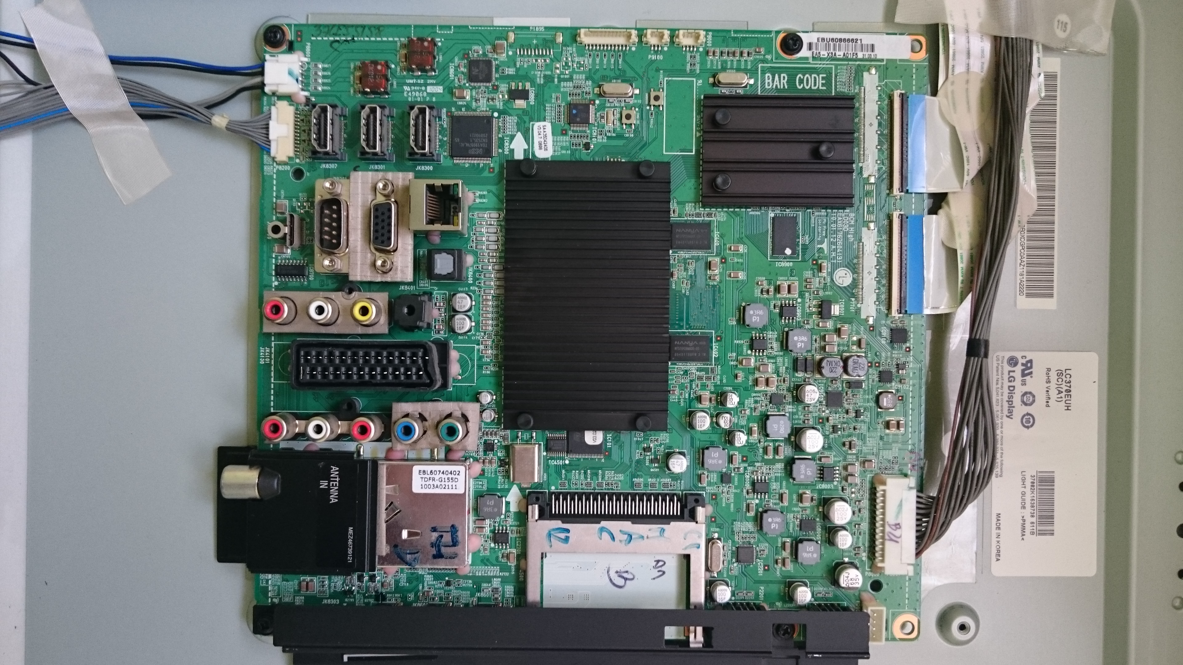

    Unfortunately, I live far away from the nearest LG service, I also gave the television to unauthorized service. The symptoms were such that the image after switching on and a few minutes of work was suspended while the audio was still working, after which the TV rebooted ...
    The diagnosis in the "website" did not point to a specific element, but to the entire motherboard. I do not know if this is due to professionalism or the complexity of the components.
    Also the motherboard. Its original designation is: EBU60866621. It's very hard to find a stimulant with this sign.
    Is this motherboard with other motherboard models also mounted in 37LE5500 ???
    I ask, because I see that in this 37LE5500 other models were also installed, for example: EBU60866645WR, EBT60943821, EAX61762605, EAX61762604 ...
    Can I also mount a disc there from another 37LE5500, even if it has other EBUs?
    Thank you in advance for your help...

    The CD you have sent is completely different in the above TV, the CD with the LD03B chassis symbol works

    It's me? I turned on the TV and the album in it is: EBU60866621.
    Today I also took a photo of the power supply and its version is: EAY60803001 (LGP37-10SLPBLD)
    Matrix: LC370EUH
    Will the proposed motherboard match this power supply and matrix?

    On your TV you have a board with the LD03B chassis symbol, the link is LD91A chassis, which has only one LVDS connector, so it probably will not fit.

    Today I finally took pictures of most of the components.
    Here are the most important:
    Alternative Motherboard Models Compatible with LG 37LE5500 TV: EBU60866621 Replacement Options Alternative Motherboard Models Compatible with LG 37LE5500 TV: EBU60866621 Replacement Options Alternative Motherboard Models Compatible with LG 37LE5500 TV: EBU60866621 Replacement Options Alternative Motherboard Models Compatible with LG 37LE5500 TV: EBU60866621 Replacement Options Alternative Motherboard Models Compatible with LG 37LE5500 TV: EBU60866621 Replacement Options
    The board has the printed designation: EAX61762604 (3) and chassis LD03D , although it has a sticker with the designation EBU60866621.
    There are two 60pin matrix tapes: EAD60974143 and EAD60974142.
    It also has a 37LE55158 :?: pen
    The rest of the signs as before ...
    Question for one hundred points: is there a "replacement" for this CD?

    Subject solved in such a way that at the auction I found a guest who turns this type of assortment, I sent him a set of photos and sent me a new CD for downloading. The plate works today.
