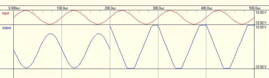

    Can someone explain to me in a simple way what distortion is and, if someone has enough patience, what excitation is???

    I see you`re a beginner, so I`ll explain it simply. Clipping is when the signal level is too high, i.e. if you feed a very large signal to the amplifier input, it will be distorted. This is clipping - distortion caused by too high a signal level. Excitation most often occurs in all types of amplifiers, most often at supra-acoustic frequencies (e.g. 100 KHz). It usually consists of a closed loop and 100 KHz over and over (something like feedback with a microphone). You can`t hear it because the high frequency causes distortion of acoustic frequencies.
    Finally, there is probably no need to explain that both phenomena are highly unfavorable. :D

    The attached figure shows two Output waveforms that respond to the amplifier`s Input signal. There is no clipping until the two hundredth microsecond. From the two hundredth microsecond, the same waveform is shown, but after much greater amplification, as a result of which the output level "tries" to exceed certain permissible levels - visible clipping of the sinusoid peaks.

    my colleague Joachim Krukowski`s drawing shows a small distortion - the signal distortion is probably around 1%, it is enough that you can notice it, but it does not bother you. the equipment sometimes specifies power with THD (non-linear) distortion of 10%, then the signal resembles a rectangle rather than a sine... operational amplifiers also overdrive when they have a high gain and signal at the input - the signal simply cannot be larger than the power supply and causes this is "clipping" the peaks of the sine wave...
