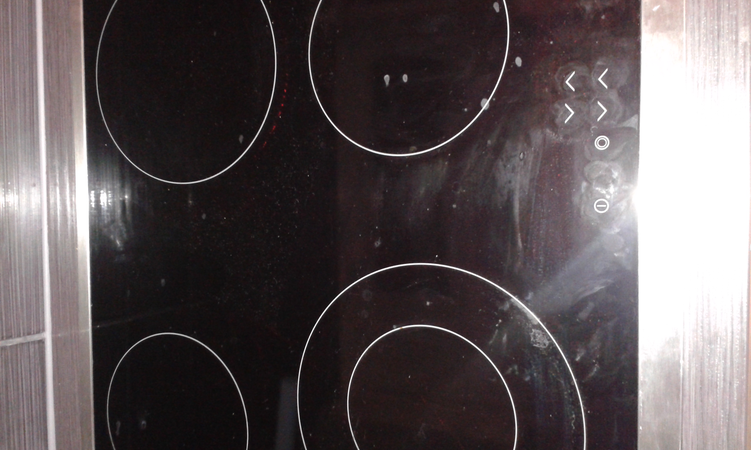

    Hello, please help me unlock the AEG electric hob, I do not have the number or model of this plate, because I moved into a new apartment and I did not find anything like that in it. I only took the picture that I am sending. I've been struggling with it for a good few hours and I don't know how to unlock it
    I would like to ask for help (I can't eat food reheated from the microwave anymore :P ) and thank you in advance
    greetings

    i.e. I moved to a studio apartment and this plate is built into the entire kitchen counter, so to speak, and I have no way to look under ......... also well ...:)
    When I turn on the disc, the letter "L" lights up, i.e. Locked, I browsed, tried many instructions from AEG but I did not come across the matching one :(

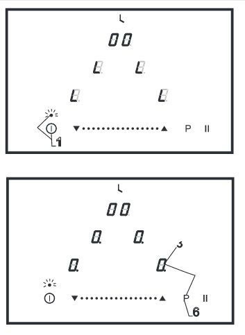

    After switching the hob panel on with the sensor (1) on
    all displays will show an "L". Then press simultaneously
    sensor (3) of the front right cooking zone
    with sensor (6). The letters "L" will disappear and the numbers "0" will appear on the cooking zone displays. with
    blinking dot. You can then start switching on the cooking zones.
    • Unlocking AEG Electric Hob: Step-by-Step Guide for Unknown Model (Attach Photo) 969212b472b10011gen.jpg (17.76 KB) You must be logged in to download this attachment.

    everything is very nice and legible, but it does not match the sensor system for my board :( I am attaching a slightly clearer photo Unlocking AEG Electric Hob: Step-by-Step Guide for Unknown Model (Attach Photo)

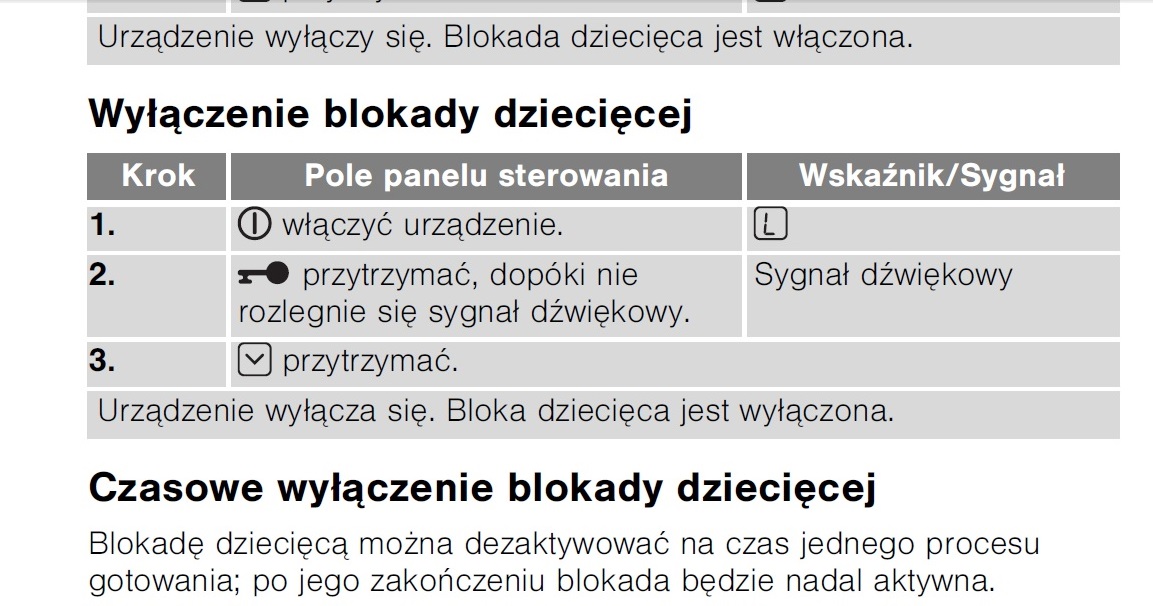

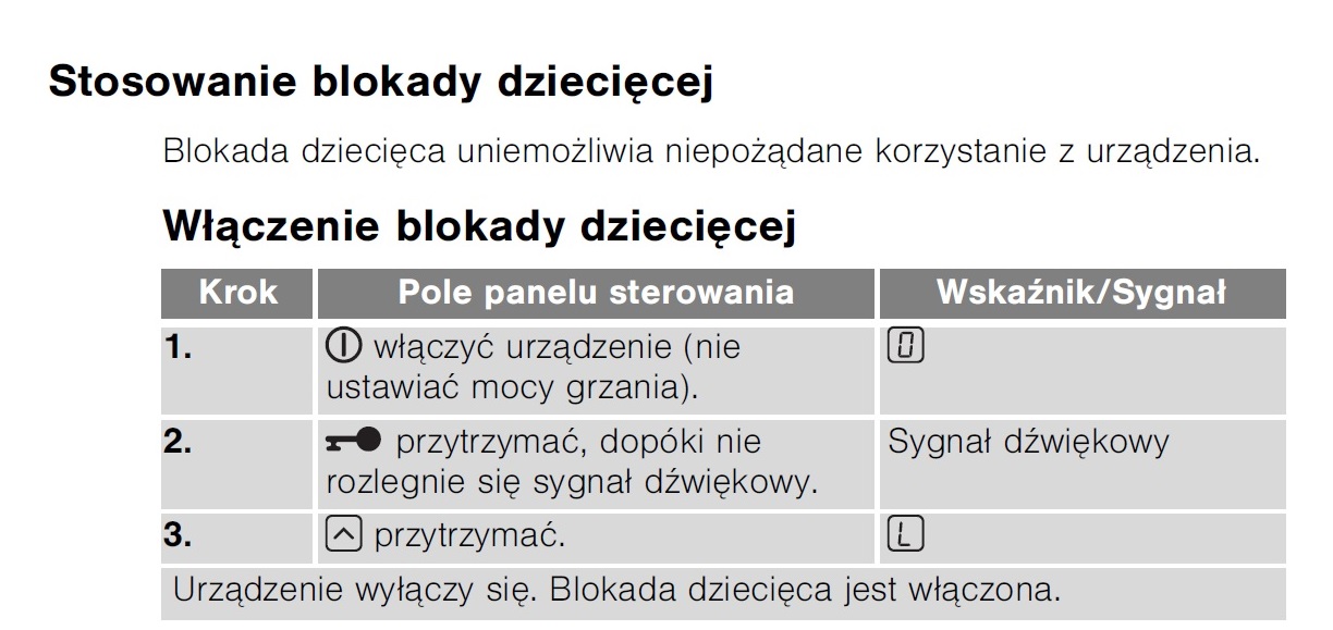

    You have to dig through the instructions from Electrolux.

    • Unlocking AEG Electric Hob: Step-by-Step Guide for Unknown Model (Attach Photo) Bez__tytu__u.jpg (185.31 KB) You must be logged in to download this attachment.
    • Unlocking AEG Electric Hob: Step-by-Step Guide for Unknown Model (Attach Photo) Bez__tytu__u.jpg (156.22 KB) You must be logged in to download this attachment.

    I have already looked at many instructions for these hobs but I can not find a model like mine :( I do not have this "key" button on the disc. If it were, I would have realized it right away ... :(
