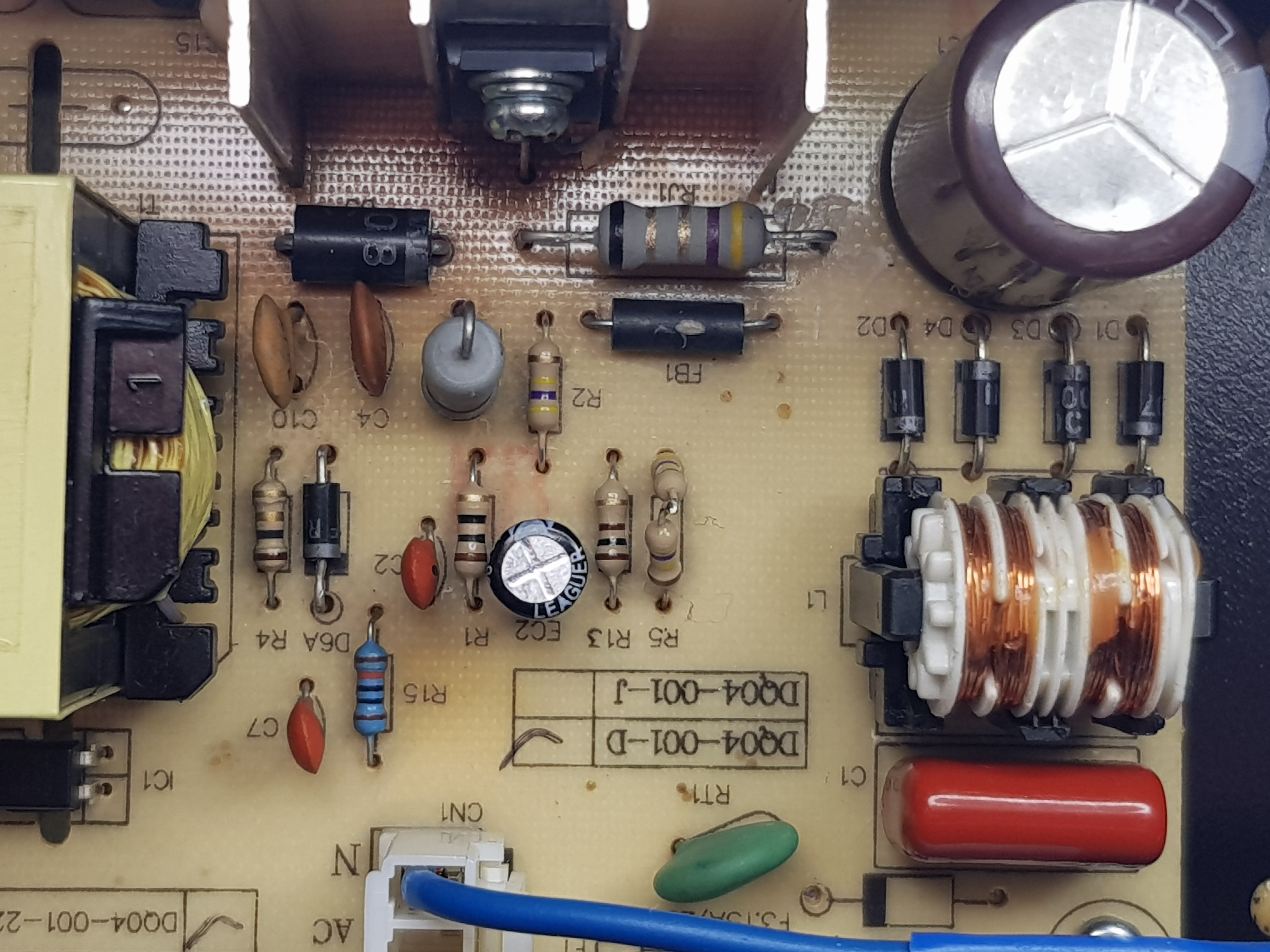

    If the topic is in the wrong section, please move it. I am trying to repair the power supply for the display refrigerator with led lighting, the power supply was flooded and damaged on the input side of the 230v bridge, transistor, resistors, capacitor and transistor control circuit.
    The original transistor is ISA05N60A, the replacement I put in is P5NK80ZFP, the rest of the parts are the same as the original ones. The power supply still does not work, when I measure the voltage on the control system power supply I have 0V, the system is powered by two 320kohm resistors, it has a short circuit. Unfortunately, it has no markings, does any of your colleagues know what to replace it with? TSOP6 housing. Description in the photos.

    If there is a resistor in pin 3 (about 100k) then probably LD7535, OB2263, SG6848 or less known substitutes, for example XN1049. Look for.
    What does it mean that there is no lettering on the layout? Scuffed, can't you read?

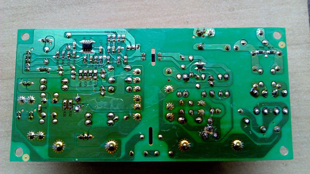

    Thanks for the hint, I hurried up a bit, the disc was covered with varnish and I assumed in advance that there was no inscription on the system, it looked deceptively torn, after heating the hot-air and gently washing the paint off, the inscription 865G27 appeared, but Google does not find anything for me. There is 100k on pin 3 so I think I will substitute this LD7535.

    The power supply was theoretically repaired, but not tested in the device, so far the customer has not received it from repair. The power supply was connected to some control panel and did not want to start in the workshop.

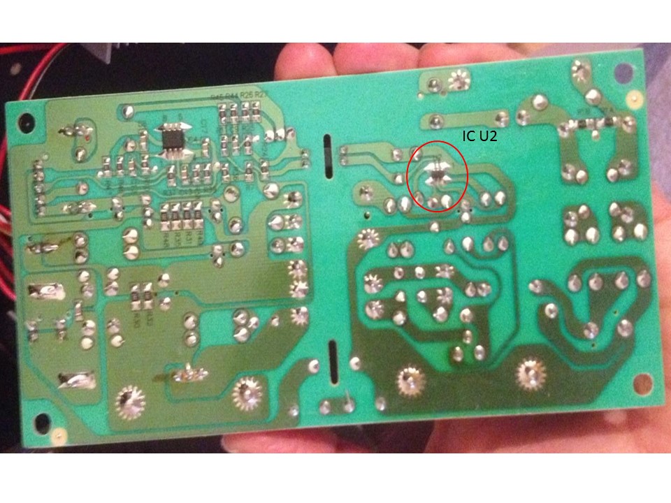

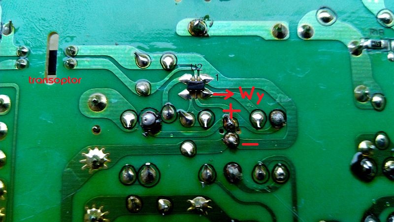

    Witam, mam ten sam module sterujacy jak na zdjeciach. Niestety zpowodalo habencie ze SMD-IC U2 they zniszczyl na odwrotnej stronie platyny i pismo jest calkowicie nieczytelne. Moze ktos odzytac i mi podac dokladna nazwe? Dziekuje za pomoc.
    Hello, I have exactly the same control unit as the one in the photos. Unfortunately the SMD-IC U2 on the back of the board is destroyed by a short circuit and the lettering is no longer legible. Can one of you read the exact name and tell me? Many thanks for the help.
    Hello, I have the exact same control unit as shown on the other photos. Unfortunately the inscription on the SMD-type IC U2 was destroyed by a short-cut and hence, it is not still readable. Could one of you read the exact type and help me, Thx in advance. Please use one of the languages above, preferably German or English.

    I had the same problem with the inverter. Defective: fuse, U2 -865K01 chip, MOSFET - ISA 05N60A, rectifier bridge, EC3 capacitor on the secondary side.

    There is no information about the 865K01 anywhere. As a replacement, I put in the SG6859A chip with minor modifications, according to the specification in pdf page 10.
    http://www.mouser.com/ds/2/149/sg6859a-305985.pdf
    I changed the supply resistors U2, R2 and R5 to three 470kom. Unfortunately I didn't have 1.5Mom.

    In the first photo of this topic, you can see that they are all the same - 201 or 102 ;)
