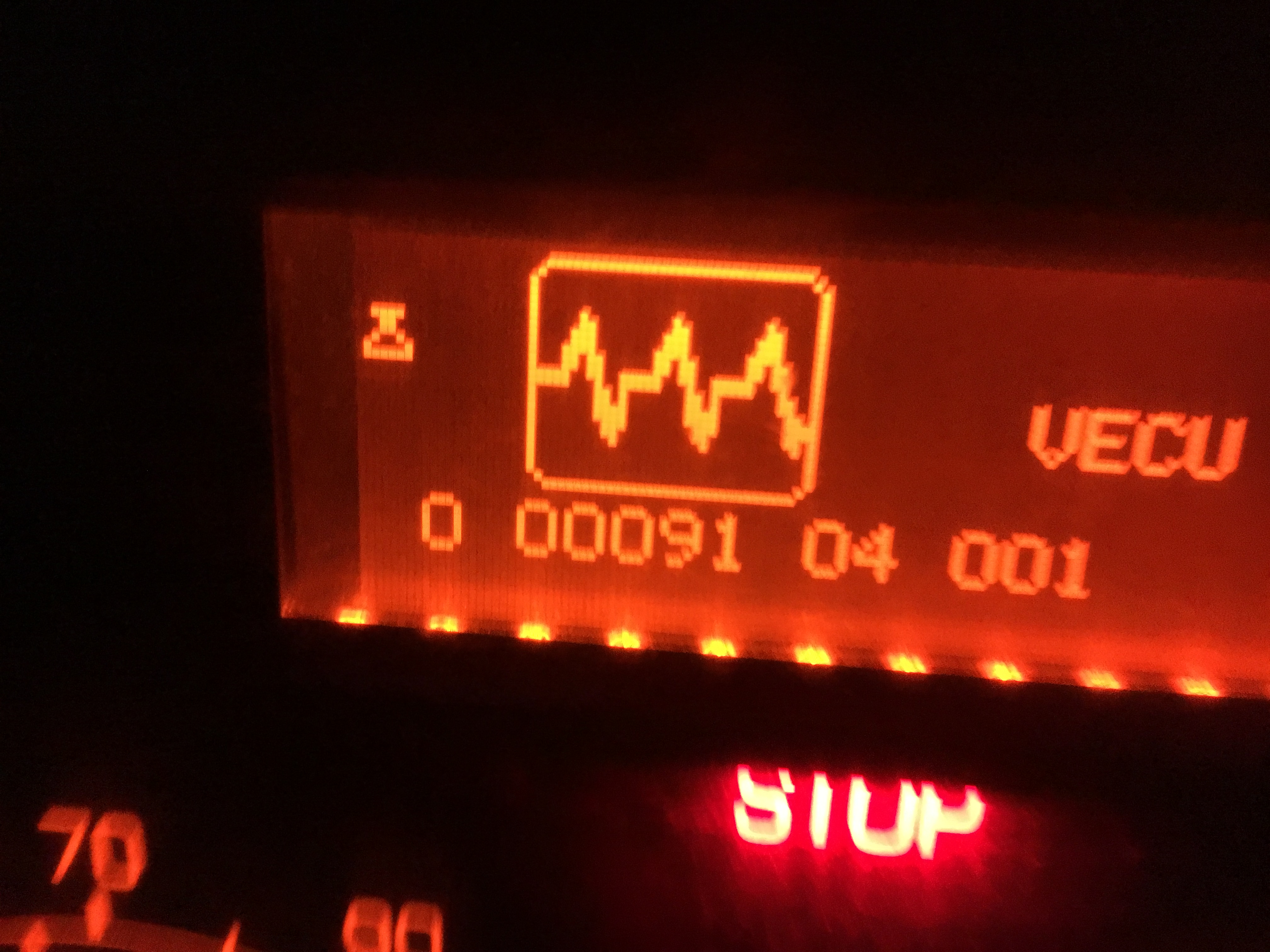

    Hello, I see defect 92 and defect 200 .. the car loses power .. I also have error codes but I can not decipher them .. help!
    • Renault Midlum: Defect 92 & 200, Power Loss, Deciphering Error Codes IMG_0165.JPG (1.76 MB) You must be logged in to download this attachment.
    • Renault Midlum: Defect 92 & 200, Power Loss, Deciphering Error Codes IMG_0168.JPG (1.71 MB) You must be logged in to download this attachment.

    91 fmi 4-pedal acceleration, voltage below normal or short to ground.
    639 fmi 9 data bus CAN - data communication error between VECU and EECU motor.

    So how can I solve the problem by doing what so I can do the truck to be ok
