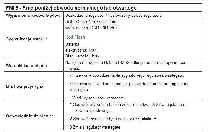

    I kindly ask you to decode two errors that are displayed as POWER DROP.
    EMS
    Mid 128
    Pid 102
    Fmi 0
    And
    Mid 128
    Sid 32
    Fmi 5
    Thanks in advance

    Pid 102 - boost pressure error
    Sid 32 - System controlling the discharge valve outlet below normal or open circuit. (Mountain brake control so briefly)

    piotr budzowski wrote:
    PID 102 - Heater cable 3,
    Do not mix, you have given an explanation for MID 128 PSID 102 not PID.
    Here, the first mistake is the result of the second, and giving the error from Adblue (the author, moreover, wrote that adblue ok) you will only baffle him ;) .
