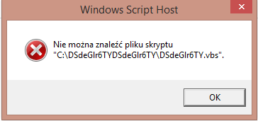

    Hello, for several days I have encountered a pop-up window (attachment), could someone help me fix it? ; /

    Use AdwCleaner, Scan and Clean / Search and Delete option: http://www.bleepingcomputer.com/download/adwcleaner/
    Include in the attachment the logs from FRST (Frst.txt and Addition.txt):
    http://www.bleepingcomputer.com/download/farbar-recovery-scan-tool/
    Make a full scan with Mbam and delete what it detects:
    http://www.bleepingcomputer.com/download/malwarebytes-anti-malware/

    Oczywiscie musiales grzebac w opcjach FRST?
    Odinstaluj:
    AVG PC TuneUp
    Zrob kopie zakladek z Chrome, skrypt usunie katalog profilu przegladarki.
    Podany Fixlist dla FRST wykonaj w trybie awaryjnym.
    Obok frst.exe utworz plik Fixlist.txt z podana zawartoscia:
    Task: {530AD3CB-8A41-4B7B-BE0A-464F195CC2B8} - System32\Tasks\DSdeGlr6TY => C:\DSdeGlr6TYDSdeGlr6TY\DSdeGlr6TY.vbs
