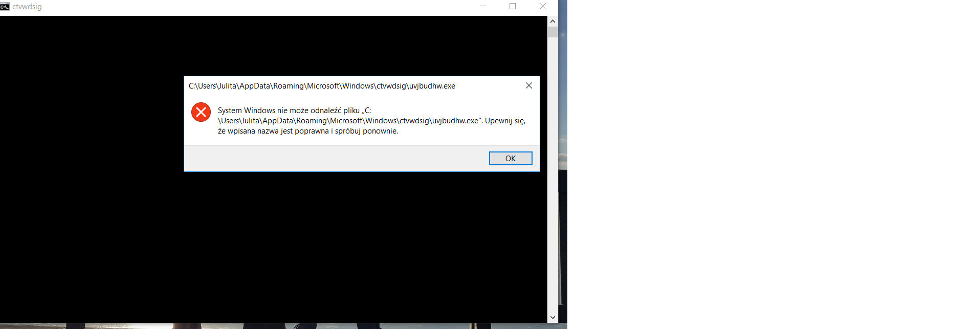

    Recently, I installed various crap and infected the computer. A window pops up at startup. Windows cannot find the file (details in the screenshot). It also adds a report from frst and otl. Can anyone help?
    • Windows Cannot Find File Error at Startup: Post-Infection, FRST & OTL Reports Provided bład.png (70.91 KB) You must be logged in to download this attachment.

    Otwórz notatnik systemowy i wklej:

    I did as ordered, unfortunately the same problem still occurs

    Post new FRST logs.

    Odinstaluj Avast Cleanup.
    Wykonaj Fixlist.txt dla FRST:

    Thanks kolobos, it helped! the computer started working as it had been working sooner. Due to these viruses, I also had a problem with the video because it started to cut, for example, videos on yt, but it has also disappeared ;) I have not removed Clean Up, since it is ok, in about 50 days it will crash when the free period ends :D (Janusz of business). I'm throwing logs

    Make a new Fixlist.txt for FRST:
    HKLM \ SYSTEM \ CurrentControlSet \ Services \ 45830DE0C2F3430E

    Thanks, close ;)
