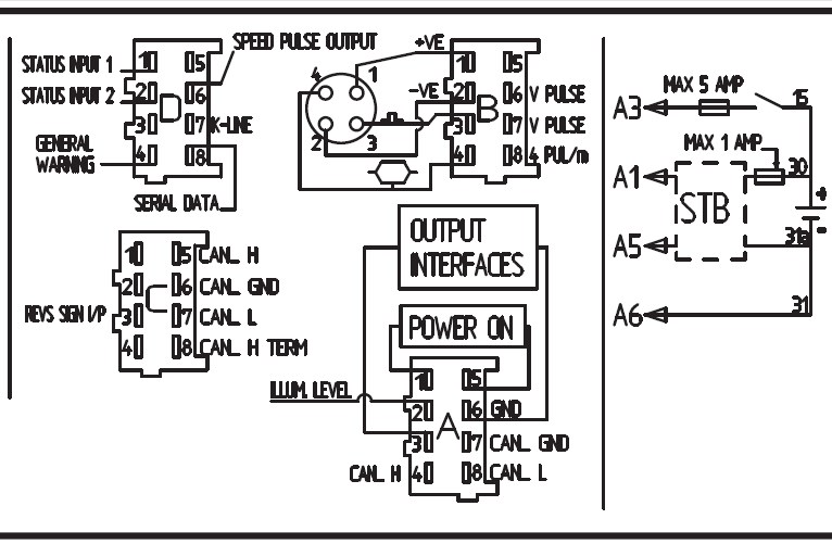

  • #6 19146337
    wydling
    Posts: 62
    Rate: 32
    Hello, gentlemen, I would like to attach to this post, the case looks similar With the error that only lights up at a standstill while driving, the clocks work normally and additionally every hour the message is displayed on the tachograph, the message is damaged transmitter error 20
    Thank you in advance for any suggestions, best regards

  • #12 19164232
    stanisławpiotr
    Posts: 1555
    Help: 211
    Rate: 832
    You have a description of the pins on the tachograph. You need to check the beam by pulling the halogen bulb from the generator side, connect all cables to ground and from the tachograph side connect the bulb to + 24V and with the other end check the 4 cables going to the previously massed generator connector. On the cable where the bulb does not light, you have a break.
    • Man TGA Construction with Reducer - Speedometer Not Working: FFR Error 3279 FMI 4, Speed Pulser opis pinów tacho.jpg (85.15 KB) You must be logged in to download this attachment.

    I soldered the wire, I checked the beam as my colleague STANISŁAWPIOTR wrote on each, the bulb lights up and the error on the board as it was so, where else to look, what to do
  • Harness puncture test and tachograph as suspects
    #18 19168598
    stanisławpiotr
    Posts: 1555
    Help: 211
    Rate: 832
    And did you check the wiring harness for punctures? If not, try checking the beam this way. Power the test bulb through one of the wires and leave the other wires disconnected. Then connect the device with one end to the ground and with the positive one, check the other wires for voltage, using the lower and lower range, perform such a test on each wire separately. If there is no voltage on other cables, repeat the measurement after washing the car. If the beam is ok, even a slight voltage should not penetrate between the wires. If you still do not detect the fault and the problem persists, you need to substitute a new cable. If this does not help, the tachograph can be suspected.
  • #19 19168615
    wydling
    Posts: 62
    Rate: 32
    Does it matter that before replacing the pulser on the tachograph, the transmitter failure code 20 was displayed after a failed attempt to pair a new pulser
    I screwed on the old pulser and the tachograph showed code 23 interruption instead of the above-mentioned one
    The display shows the code as in the description of the post
    Connecting the computer displays it as a permanent error

  • #21 19168719
    wydling
    Posts: 62
    Rate: 32
    The guy who does legalization of tachographs
    I have not checked for punctures, I will replace these 4 veins for the sake of peace, what is new is new, the more that water collects in the conduit through which these cables go
  • #22 19169401
    stanisławpiotr
    Posts: 1555
    Help: 211
    Rate: 832
    A good decision, write about the effects.
  • #23 19170228
    wydling
    Posts: 62
    Rate: 32
    I replaced the cables with a new one, the error is still there, but after re-testing everything returned to normal, the errors disappeared
