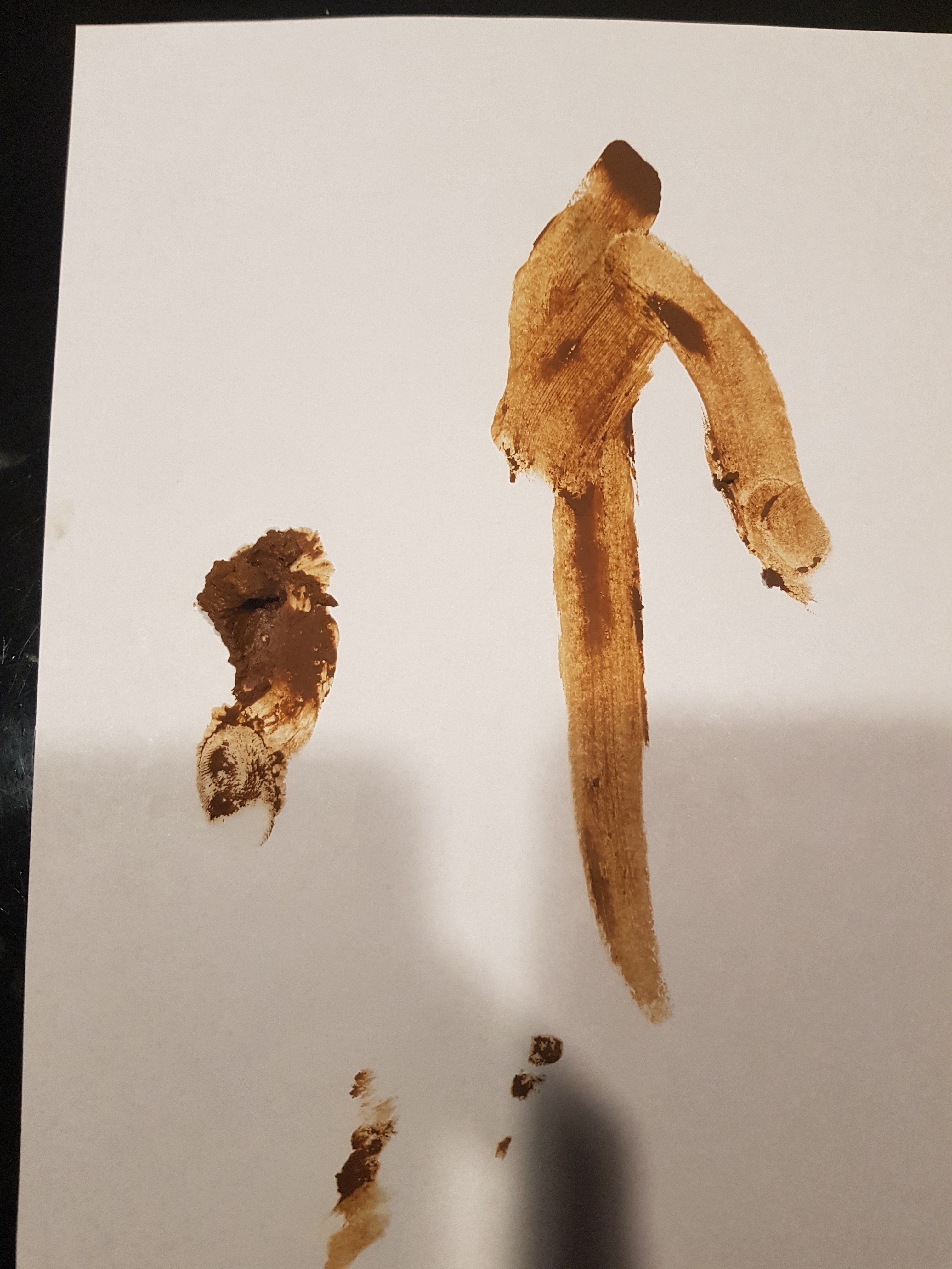

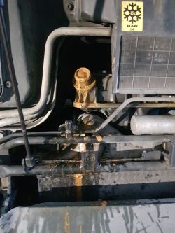

    and tell me, I changed the egr in the mana because the coolant was taking the liquid now less, but it will also take something, there is no leakage, but every day sir the orange bubble appears and the thermometer stinks with exhaust fumes as if it burned out, but every day even 2 times a day after 30km goes out
    Added after 5 [minutes]:
    MAN TGX 440 - TCU Gearbox Error 00191-08: Troubleshooting & Assistance
    or I have something like that in tga 400 d20 I do not know what if the liquid is bad, because the bubbles are gently and the plug is unscrewed, the pressure is done sle the car has power and goes normally
    If you do not smell the exhaust gas, there may be bubbles from the compressor.

    A few questions; Does the car have a retarder. Did you change the coolant, if so, what was the reason. Was it done with EGR. Does this goo in the tank have any smell or is it greasy, can you feel some "sand" under your fingers.
  • #8 17080172
    mikiman440
    Posts: 8
    Rate: 26
    hello gentlemen, this goo is such a frothy smell of egr fluid not touched a year ago made head the fluid was replaced I do not know what retarder does not have a tank stuck with this muck

    Hello, maybe a poor quality coolant?
