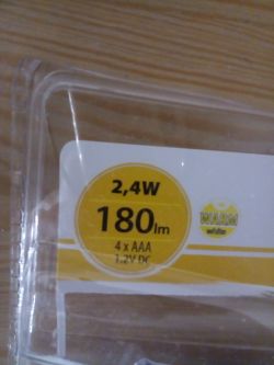

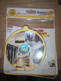

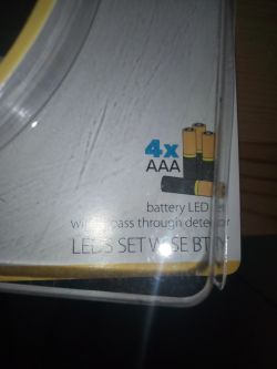

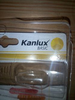

  • #9 17681784
    vicio_32
    Posts: 9
    I found an interesting solution.
    I just converted the power supply.
    Instead of batteries, I used a power bank with a capacity of 4,000 mAh.
    With this configuration I got the effect of 9 hours of ordination without a break.
