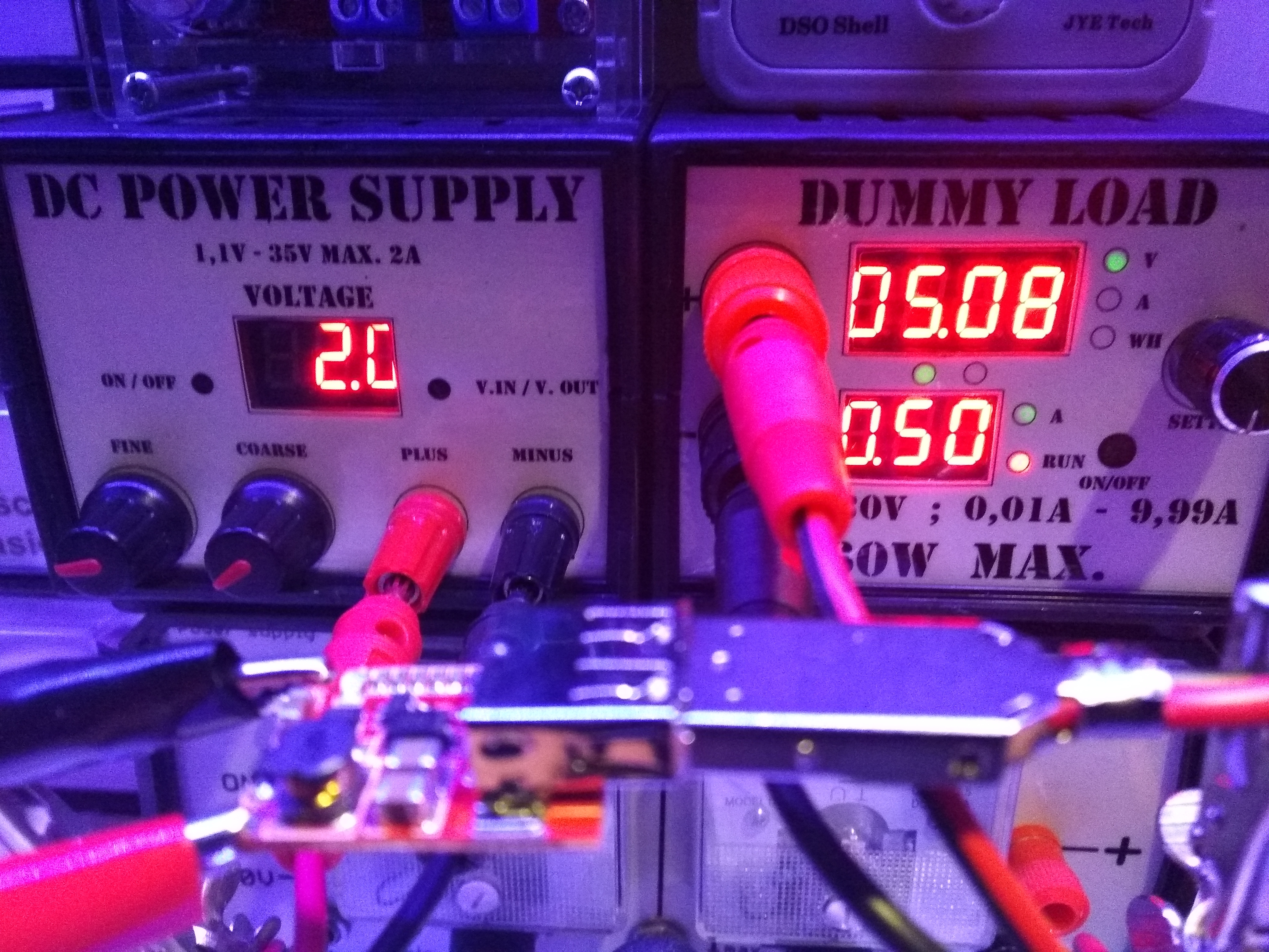

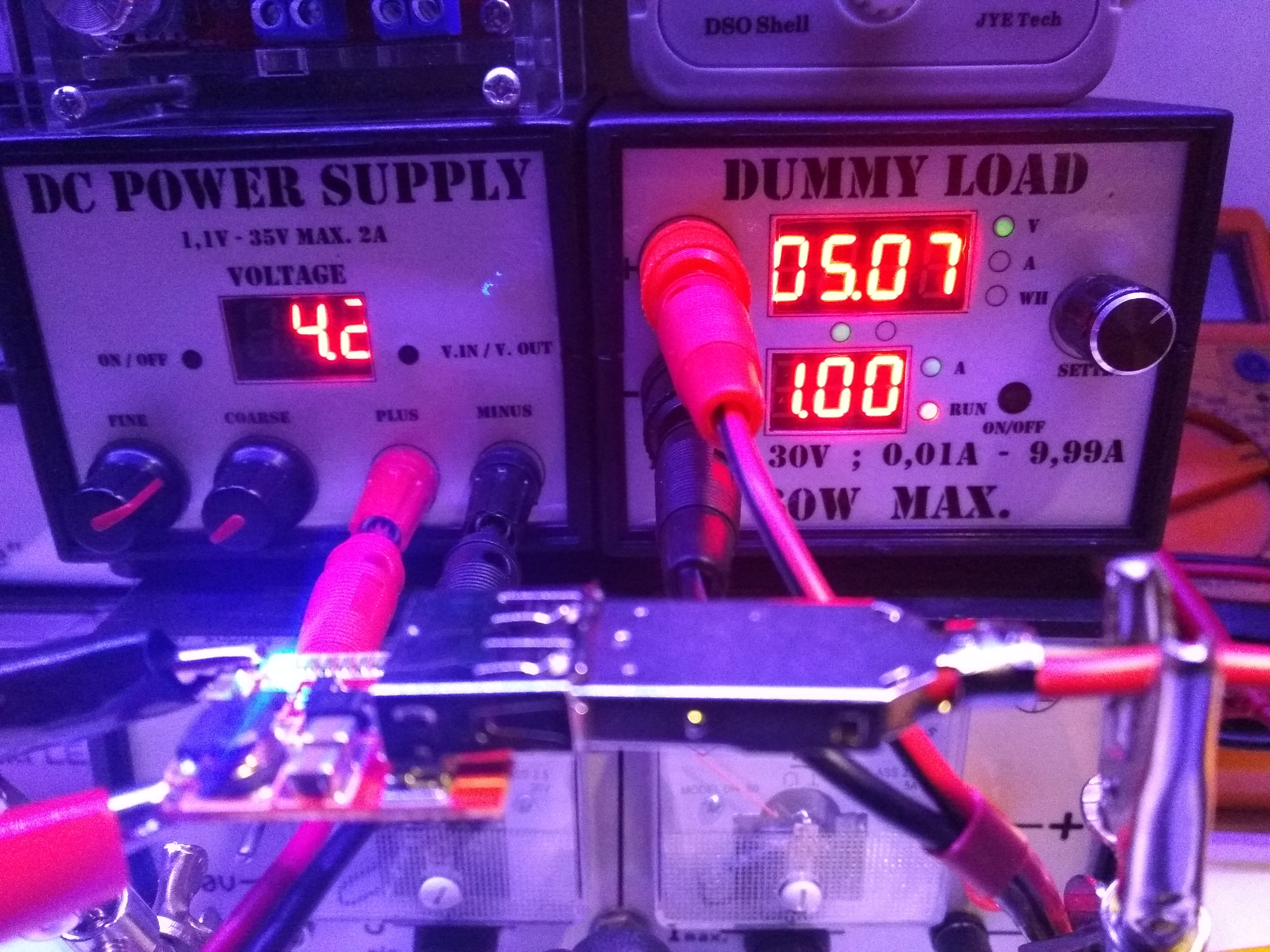

    Well, never mind the oscilloscope, after a while I find that I received a terrible crap specimen, because the previous ones, which I did not test, but used to a greater or lesser degree, did not make any (at least audible to me) sounds.
    The tested converter maintains the correct voltage under load, which is confirmed by the photos. But after a few minutes it gets very hot.
    With a load of 0.5A after approx. 3 minutes of operation:
    Chinese converter test for PowerBank. Step-Up 5V "1500mA"
    With a load of 1A after approx. 3 minutes of operation:
    During the tests, I did not dare to "reach" the "promised in writing" 1500mA, because while the voltage was stable, the converter literally sang in a large input voltage range. The sound effects occurred at both 500mA and 1000mA loads.

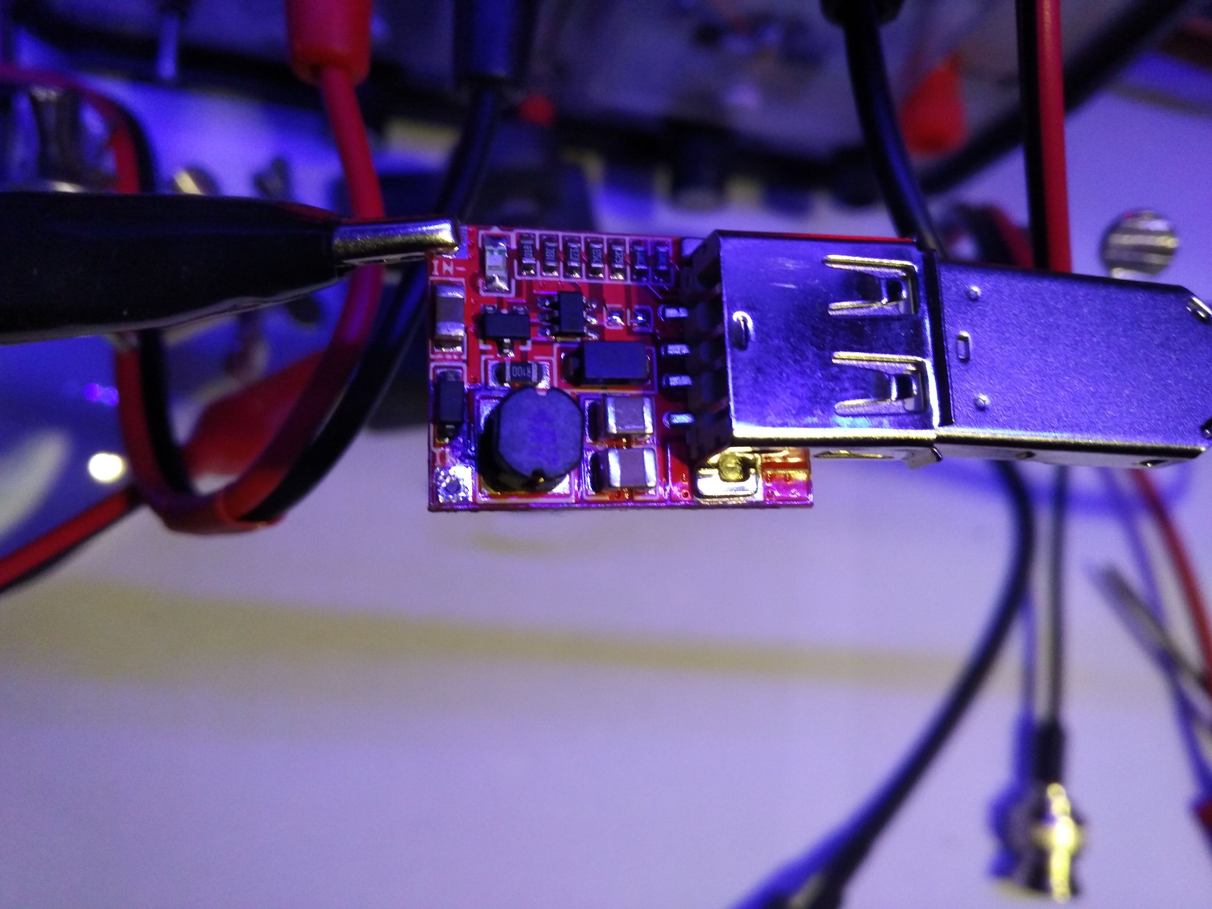

    Now a few photos, so that it would not be that I made it all up :) and finally two videos presenting the "singing" of this converter.
    Chinese converter test for PowerBank. Step-Up 5V "1500mA" Chinese converter test for PowerBank. Step-Up 5V "1500mA" Chinese converter test for PowerBank. Step-Up 5V "1500mA"
    Because the converter heats up very much, which in the case of these particular converters (and as I mentioned, I have already used the exact same model several times already) is quite normal, but I have never encountered a chance that it warms up so quickly. Additionally, it makes suspicious sounds. I wonder if I should send it to the land of eternal power supplies and transformers using the "let's see how much we can squeeze out before the magic smoke disappears from the chip" method. :)

    Here the inverter is loaded with 0.5A and starts its correct operation from 2V.
    Here we take 1A and the converter starts working correctly only at 2.8V
    You can't hear it that clearly in the movie, but believe me, this sound is very unpleasant and really loud.
    Now imagine a PowerBank next to your head, in a tent, in the beautiful wilderness of the Bieszczady Mountains, for example ... And this cruel whistle of the converter.

    Unfortunately, after about an hour under a load of 1000mA, the converter turned off. I wasn't in the room, so I don't know what temperature it got. When I got back it was 61 ° C and it started.
    EDIT 2:
    And it happened. This time I was fortunately next door when I noticed the characteristic smell of magic smoke. I even managed to take a few photos, but unfortunately you can see anything at all on only one. But I managed to capture the soul of this converter. Hehehe ...
    It had to "jerk" a lot of electricity, because the voltage on the power supply dropped by 0.5V.
    When giving data, the Chinese forget about the most important thing, that at higher currents, additional cooling is required, which is not included in the set. It is commonly duplicated at various auctions, for example the LM2596 inverter is supposed to be 3A, but only when you put on a heat sink and without heat dissipation it will burn at 2A. Similar treatments are with BMSs for Li-ion packages, like 30A, but already above 10A and with continuous load, they require a heat sink / cooling.
    ps.
    The characteristic squeal is normal for a cheap high frequency choke.

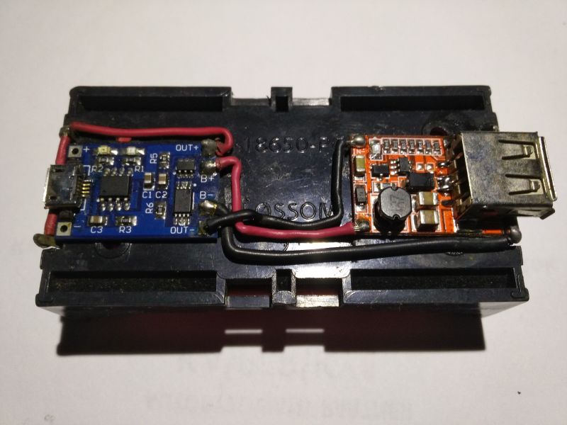

    This is interesting because I used to use such a PowerBank
    and nothing squealed, and the inverter was able to charge two phones in a row. The big diode was the most warm. The board is stuck on a double-sided 3M tape for gluing displays, and in summer the glue was able to release after a long charge on the table in the sun.
    Can you count on the charger description on the left? :)
    I have a similar one, but I do not know what the OUT + and OUT- outputs are for, when I connect a receiver there (say Arduino), I cannot charge the battery connected to B + and B- :(
    Let's not expect miracles from such a simple and cheap charger. The OUT outputs are for the receiver and B for the battery. To be able to charge and use, you would have to connect the batteries and the receiver in parallel under B-, B +, but then you have no protection against excessive Li-ion discharge.

    Well, but if there is an output to the receiver, there is something for it, unless I have to unplug the receiver during charging?
    I'm not entirely sure, but I suspect it was the converter's singing and its premature death during your research, that might not be her fault.
    This particular converter is based on the RT9266 system, working in a factory-like application with an external transistor (mosfet or bipolar):
    But most importantly, it works with a constant, factory forced frequency of about 500kHz.
    So even if everything is loose, it still cannot produce audible sound. So the squeaking (one kilohertz per ear) can only come from some completely different oscillations in the current circuit.
    If the inverter output voltage is ok and the inverter supply voltage is OK, then most likely in my opinion this artificial load is excited.
    Let us assume that the load resistance (mosfet to be precise) oscillates within wide limits, thus the current. The amplitude is large, which causes the choke to emit a sound (e.g. magnetostriction). The inverter can even keep the voltage of 5V quite accurately, but in the system there are large instantaneous currents (hence the abnormal heating) exceeding the strength of some element and, unfortunately, death.
    This is only an unconfirmed hypothesis on my part because I do not have this particular converter to verify it. I also don't have this type of load.
    I watched your thread about this load and a colleague posted a diagram there, which would show that the current is forced only in an analog way (mosfet + WO) based on the voltage generated by the uC, but it is not measured in any way (there is only a simple detection threshold voltage on the gate, which only gives information about the inability to obtain the assumed current, that it is not enough).
    So in the event of oscillations, the load controller has no chance to detect them or even show the real value of the current on the display. It is possible that even in the case of oscillation, the (effective) current value is much higher than the set value.
    So I would have such a suggestion, as you will be testing other converters, look with the oscilloscope especially on the current (e.g. measuring at the shunt) in case of such anomalies as e.g. these sounds. If necessary, check against purely resistive load.
