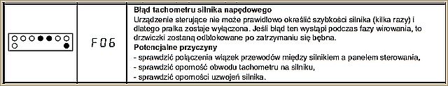

    Another failure, the service lights came on - the Whirlpool AWO / D 43105 washing machine, does anyone know what this sequence of LEDs means?

    Another failure, now I have such a combination of diodes, please decrypt, the washing machine only pumps out and an error pops up ...
    Washing machine Whirlpool AWO / D 43105 - Service marking of the diodes
    I would ask for fixes to all Whirlpool led error codes. Could it be the fault of the relay or the diode?

    Probably the heater to be replaced.

    I have not checked the heaters yet, but recently replaced it had a puncture to mass. Recently, I had a problem with spinning the laundry, so I took out the controller and improved February on capacitors, triac, LNK304PN system. I also desoldered the SB140 diodes and the G2RL-1A-E relay for checking, of course I had to twist something and solder the diode the other way round, and the washing machine did not show any signs of life, after soldering the above error correctly appeared.
