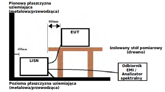

    The following block diagrams show the standard recommended electrical and physical configuration of the test bench.
    Understanding EMC Compliance Tests and Pre-Certification Measurements in Electronic Device Design
    Figure 6: The electrical circuit of the conducted emission test bench.
    Understanding EMC Compliance Tests and Pre-Certification Measurements in Electronic Device Design [/url]
    Figure 7: Physical layout of the stand for measurements of conducted emissions.
    Key Issues:
    1. The vertical and horizontal ground planes are typically sheets of metal twice the size of the equipment under test (EUT).
    2. The vertical and horizontal ground planes should be electrically bonded together and grounded.
    3. The tested device must be placed on an insulated table above the horizontal shielding plane. No devices or cables may be between the EUT and the horizontal ground plane.
    4. The LISN is electrically bonded to the horizontal ground plane. LISN is a network impedance stabilization system. Its task is to separate AC disturbances from the conducted disturbances generated by the EUT. The LISN system with rated voltage, current and frequency should be selected appropriately to the device under test.
    5. Make sure that all connecting cables lie freely and do not form coils and thus induction loops.
    6. The spectral analyzer should be located at a distance from the horizontal ground plate, typically not less than 1 m.

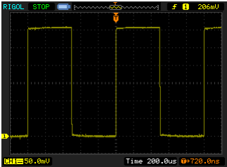

    Figure 11: Signal on the oscilloscope screen with shielded input circuits.

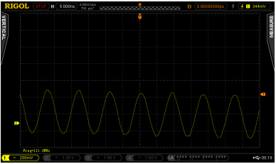

    Figure 15: Sine wave from demonstration board without RF interference.
    After turning on the RF signal, the board's waveform started showing signs of distortion. The strongest interference appeared at the 110 MHz carrier frequency, as shown in the figure below.
