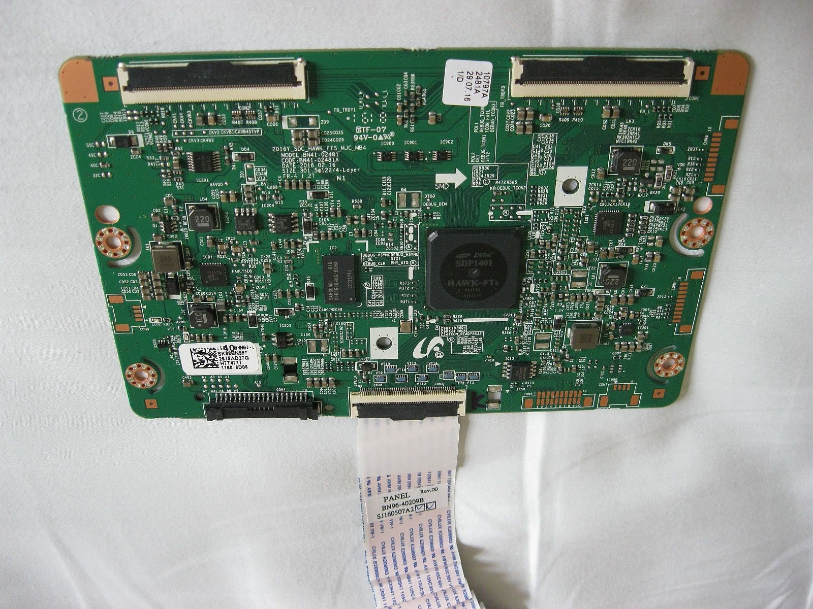

    Is there maybe a cheaper replacement matrix for samsung UE40K5672 TV?
    • Damaged Samsung UE40K5672 TV Matrix: Seeking Affordable Replacement Options TV samsung UE40K5672 .jpg (112.94 KB) You must be logged in to download this attachment.

    I am not a service technician, only a "user", so I thought that a professional can get the model after the model, which is why the TV matrix is, so I posted a photo TV nameplate, but if I need to spin up the TV and check as far as free time what matrix model is in this TV.

    TV son slid off the store shelf, it is physically damaged i.e. in the left corner as if an intersection. At the beginning of the TV, however, the matrix crack increased and the image disappeared, the voice works (other functions also worked). I know that the price of such a matrix is high on the website, so I wanted to know if you could put something cheaper here so that you can watch this TV if you can.
    Greetings.
    • Damaged Samsung UE40K5672 TV Matrix: Seeking Affordable Replacement Options TV_samsung_UE40K5672.jpg (75.79 KB) You must be logged in to download this attachment.

    On models from 2016 (made in Slovakia) there were Korean models, described with "Samsung words", i.e.
    40J6330 - VS04, 40A1AF0V 120Hz
    What is needed after the description: T-con or "matrix ears"
    Maybe after this info. Link_ Samsung 2016
    5th Samsung model series: UE40K5600 / UE40K5602 / UE40K5672
    The best model is 5672 (tuner with DVB-S2) and supposedly has a matrix:
    60 / 50Hz
    ??m?ung: U? ?U6600, ?U6510, ?U6500, ?U6400, ?U6000 ..., ?6300, ?5600, ?5500, ?5100, ?4100
    * officially FHD (1920x1080)
    ps
    Maybe here description of the specification (TV and matrix comparison) link
    Or SamyGo forum (all about Samsung TV) Link_ K series
    The avsforum forum is good Link_ some ... pages about matrices
    About Samsung matrices over 6x pages (last was 68) link
    In the UE40K6300AK 40 "LED TV model was T-con: BN41-02481
    - curved screen
