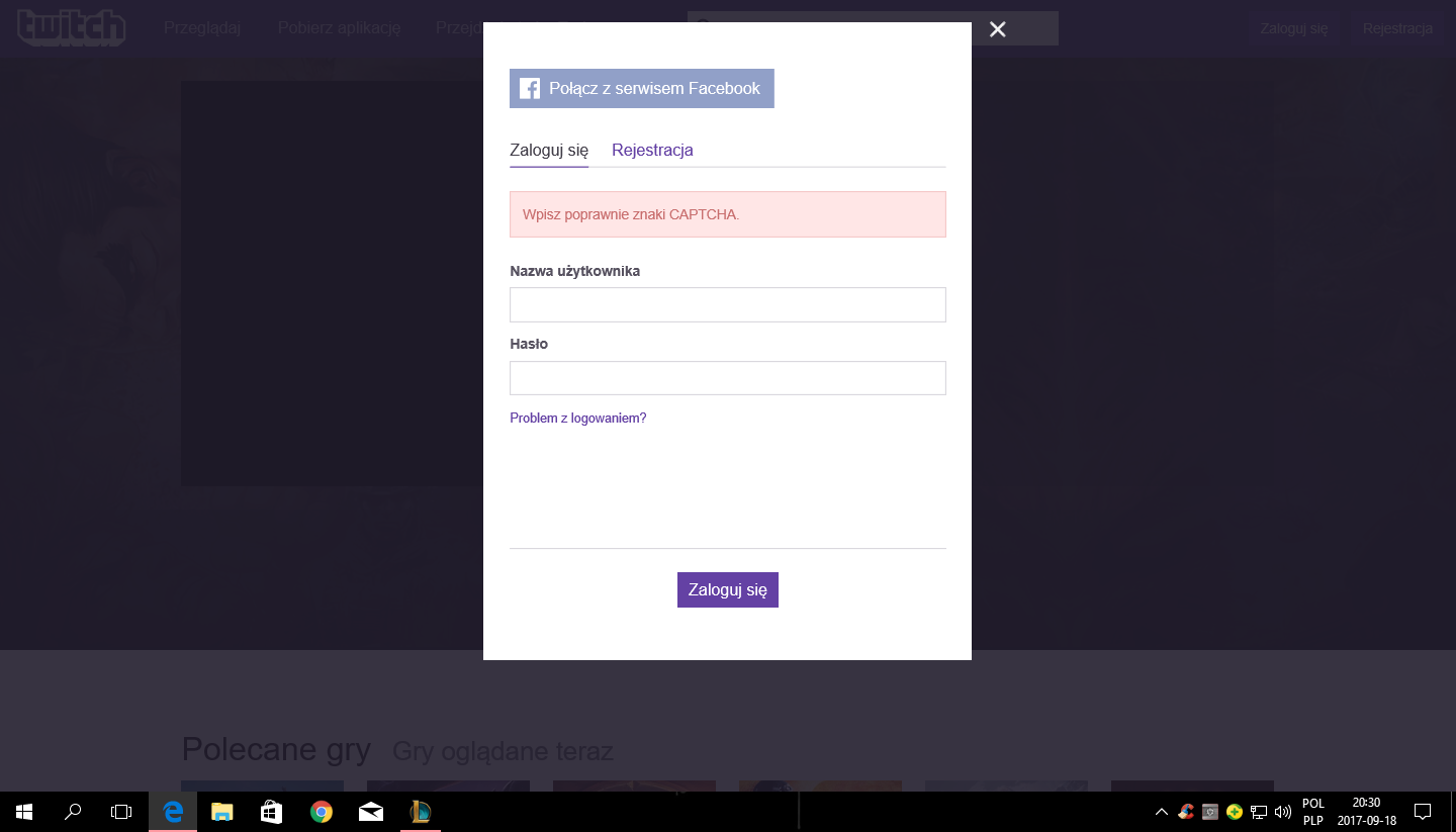

    When you try to log in to some pages, you must enter the numbers and letters of the CAPTCHA graphic. The thing is that a message is displayed asking you to enter the content of this graphic, but no graphics or trace. I turned off and even removed Adblock from Chrome, scanned my computer with anti-virus, updated jave, cleaned browsers. I even reset to the initial version. I also looked at other browsers such as Microsoft Edge, Internet Explorer but it was not displayed.
    An example from twitch:
    Error with Captcha Confirmation: No Graphics Displayed on Login Pages, Tried Chrome, Edge, IE .

    Jakas infekcja ustawila Ci proxy, ktore jak widac powoduje problem z captcha.
    Odinstaluj:
    Browser Configuration Utility

    W FRST wybierz Napraw.
    Po wykonaniu usun katalog C:\FRST i sprawdz czy juz jest ok.
  • #9 16707472
    reter12345
    Posts: 7
    Thanks a lot, problem solved.
