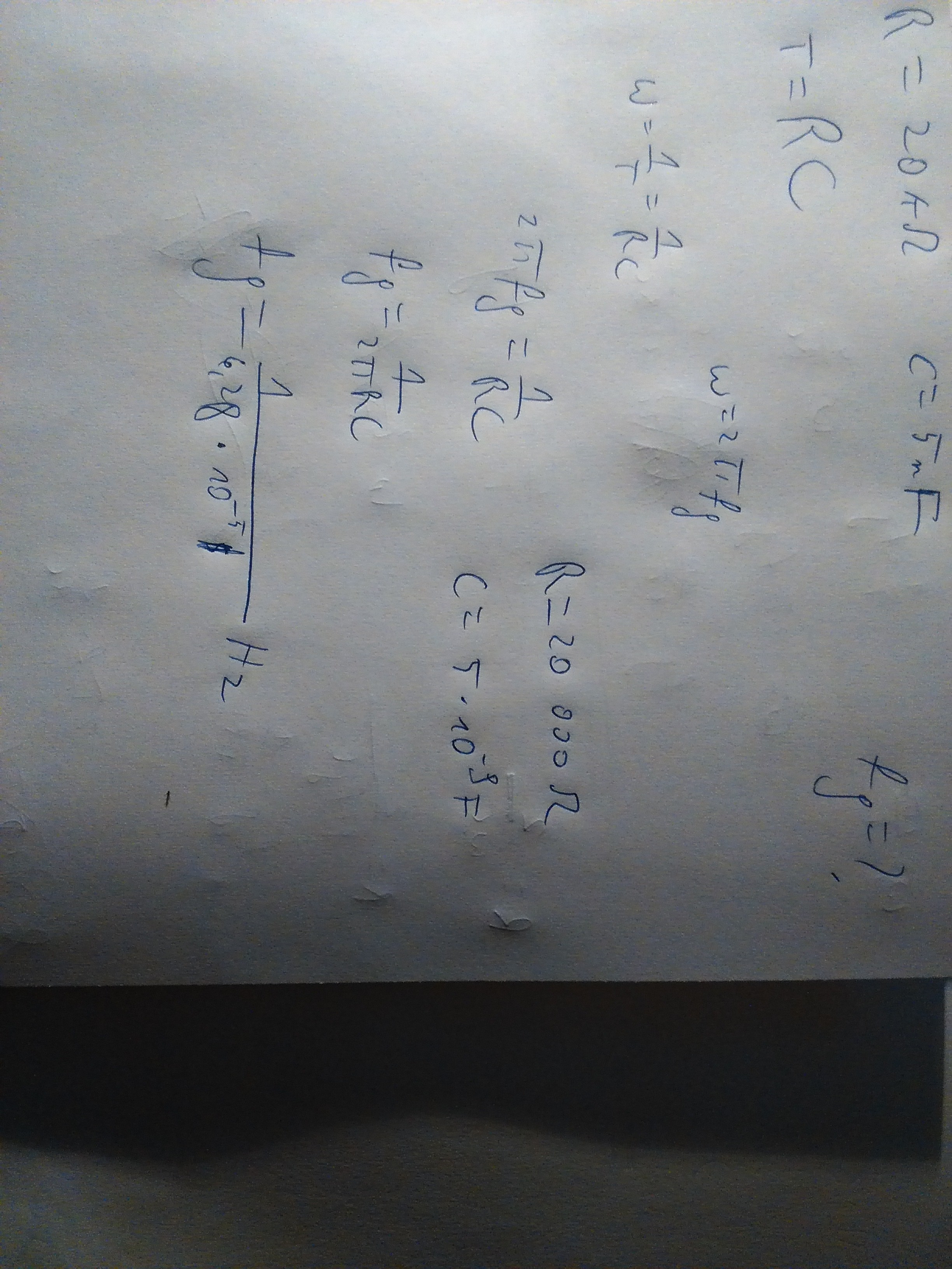

Calculate Low-Pass Filter Cutoff Frequency: Formula, R=20k Ohm, C=5nF, Solution & Photos

    Use the formula for the low-pass filter cutoff frequency as follows:
    fg = 1 / (2? * R * C)
    That is, in accordance with the one you provided. Now you have to substitute and calculate everything as you did. It should output 1592.3566 Hz or 1.592 kHz
