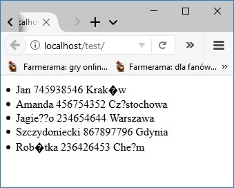

    However, as I suspected; calling the script with the same query displays the following message:
    PHP wrote:
    Query Error: You have an error in your SQL syntax; check the manual that corresponds to your MySQL server version for the right syntax to use near '?y, id_klienta, id_towaru, ilo??, data from `Sprzedaż?` at line 1
    Which means exactly what I wrote a few posts earlier; Polish letters in the names of variables, arrays, fields, etc. is not a good idea: /
    Code used:
    Code: PHP
    However, the use of a code that avoids the use of Polish characters in the query;
    Code: PHP
    gives a good effect in my opinion:
    Connecting & Displaying Database on Website: XAMPP, Fatal Error, MySQL, Apache, strona.php
