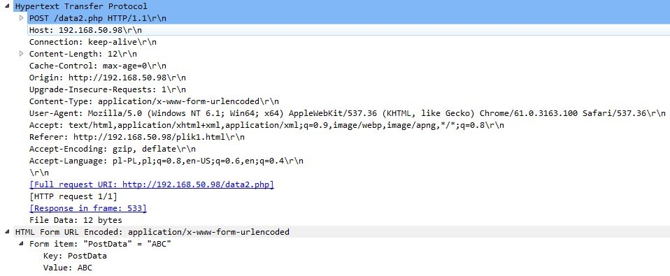

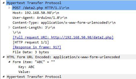

    After uploading the whole thing to the local server and analysing wireshark it looks like the header is not correct.
    The name of the variable does not appear at all, instead there is its value.
    Code: C / C++
    wemos
    Wemos D1 mini ESP8266 PHP Mysql empty variable in POST method
    mozilla
    Wemos D1 mini ESP8266 PHP Mysql empty variable in POST method .

    I have painfully modified the code according to the header examples on the web and the value is always empty even "PostData=ABC" does not work.
    Starting to suspect a bug in the arduino library.
    Added after 13 [minutes]: .
    Success, seemingly trivial but maybe someone will find it useful :-) .
    The whole string must be defined in a variable together with the equal signs and values otherwise Length truncates the value just after the variable name and value is empty:
