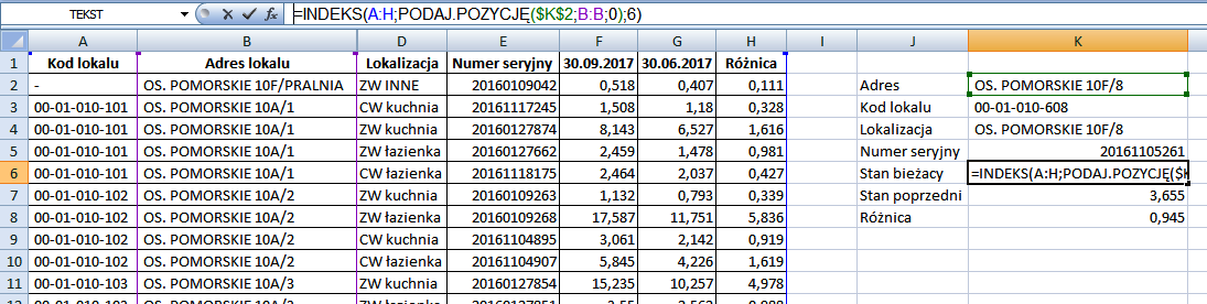

  • #6 16836717
    marek003
    Level 40  
    Posts: 4607
    Help: 801
    Rate: 488
    The sum of the conditions will not work here because each position is different.
    Validation point to the list and mark the column A: A
    In the cell below index () with the entire table and as a row specify the position () where the argument is the selected location and zero as the last parameter.
    added after a while
    Below is an example of my proposal - you only change the yellow cell.
    • Zeszyt1.xlsx (9.6 KB) You must be logged in to download this attachment.

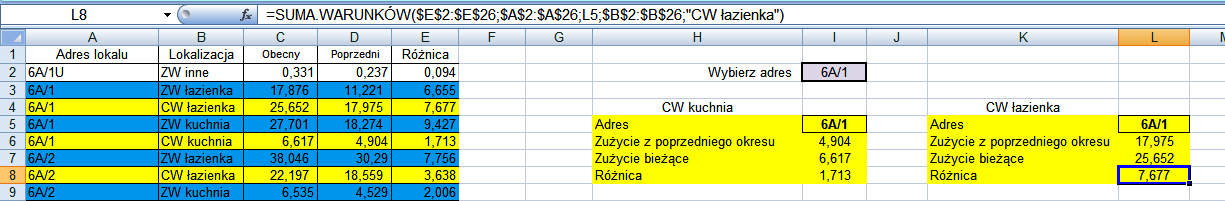

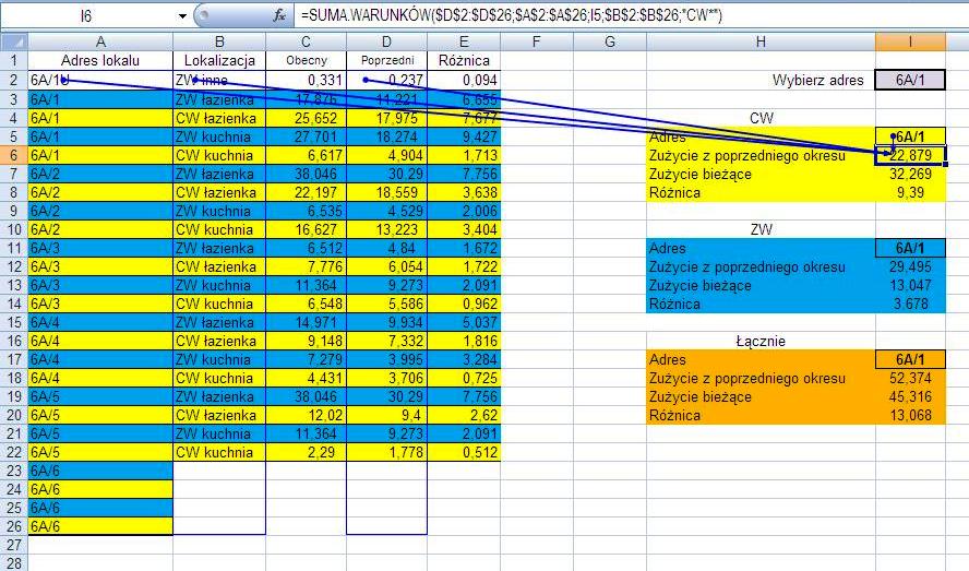

  • #7 16840030
    Prot
    Posts: 2580
    Help: 574
    Rate: 297
    However, he maintains his original opinion :ok:
    It is precisely for the analysis of water consumption in multi-apartment buildings - "unsubscribe - paint" the sum of conditions perfectly fits :spoko: (I used it myself for such purposes :D ).
    For the data provided by the author of the post (unfortunately in the photo: cunning :) this analysis can be performed as shown in the screenshot:
    Excel - Automate Copying Row Values to Column (8K Data) - Efficient Methods & Tipssumwar.JPG (122.64 kB)You must be logged in to download this attachment.
    In the attached file, apart from the obvious summing formula, there is also a dynamic address selection list installed :idea:
    zużyci..lsx (11.96 kB)You must be logged in to download this attachment.

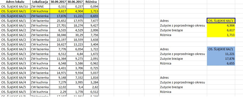

  • #10 16849539
    Prot
    Posts: 2580
    Help: 574
    Rate: 297
    Probably due to limited knowledge of Excel - your friend's conclusions are wrong :cry:
    Both the first and the second method, after minor modifications to the formulas, enable the search for individual indications.
    "Index" method
    Excel - Automate Copying Row Values to Column (8K Data) - Efficient Methods & Tips2017-11...png (47.47 kB)You must be logged in to download this attachment.
    "Conditional sum" method
    Excel - Automate Copying Row Values to Column (8K Data) - Efficient Methods & Tips2017-11-2..1).png (32.79 kB)You must be logged in to download this attachment.
    However, it seems to me that when it comes to searching for individual consumption indications - the easiest way is to use the auto-filtering or advanced filtering method. :D
