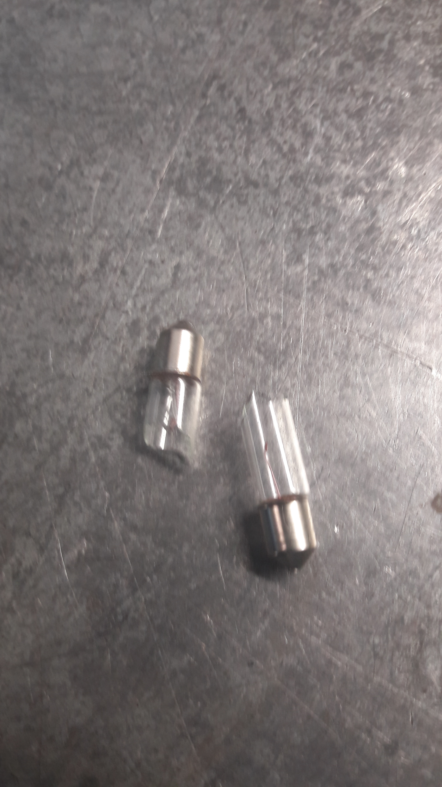

    Hello all. I am a mechanic, car diagnostician.
    I have a question about the 12V tester. The point is that there is a 24V 3W bulb inside. My question is: How do I calculate (using the formula) the power of this bulb for a voltage of 12V?
    For example, to match and buy a bulb for 12V and .... W.
    I am asking for this because I measured the current consumption of this bulb for a voltage of 12.5 V.
    It was 0.065A. The formula for the power P = U × I shows that this bulb has only 0.8W.
    Thank you for your help
    The most appropriate pattern. At 12 volts you should have 1.5 W. As for the reason why you get these results - I would bet that the cable with the alligator clip has a lot of resistance.

    Buy a normal 12V 250mA or 3W tubular bulb, there are plenty of them on the net.
    Although when it comes to the sampler itself, why replace the bulb? This one is so universal that, as you have experienced for yourself, it lights at 12 and at 24V.

    These calculations suck. Bulbs have a resistance strongly dependent on temperature, i.e. in consequence of the flowing current. Moreover, this correlation is non-linear.
    Measure the resistance of the bulb with an ohmmeter, you will be surprised ...

    Continuing with the main question how to convert 24V 3W to 12V. Such an example:
    ,, The customer comes to me with the above-mentioned bulb - I tell him that they are no longer available (or horrendously expensive). How am I supposed to choose a 12V bulb for him?

    I understand the non-linearity of resistance. But I mean, no one on the forum will answer the following question.
    Calculate how much electricity is consumed by a 24W 3W bulb connected to a 12V voltage source?
    After all, I should probably remember that I will not mention schools, not studies.
    For me, this question is very simple, but I have a problem with the answer.
    If the light bulb had a constant resistance (which is of course not true because its resistance depends on the temperature), the current intensity would be twice lower. Simply Ohm's law: I = V / R. As for the power, P = V * I = V ^ 2 / R = I ^ 2 * R, so the electric power for a constant resistance is proportional to square voltage or square current. This is called the Joule-Lenz law in physics. You decreased the voltage twice, the power decreased four times, approximately, of course, without taking into account the change in resistance.

    marekkgb wrote:
    Buddy Adamcyn. I am completely satisfied with your answer.
    I understand and thank you.
    So you already know how to deal with it :)
    For illustration - the characteristics of the 25W and 100W main series bulbs.
    http://www.elektro.info.pl/images/photos/24/1973/__b_7618d25315538abab5c0376536a0c5a0.jpg
    Red curve - 100W
    Blue curve -25W
  • #16 16857748
