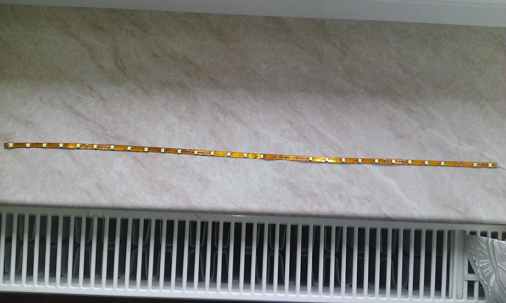

    Hello. The LED strip that illuminated the nameplate in the truck burned out. It was a 12v tape because that's what it says on the strip (on the "plus" strip there is a description of 12v + in the place where the tape is cut). In this tape you can see that there are several diodes desoldered - maybe it made the 12v tape work under 24v? I am asking because I have a 12v tape and I would like to use it. I know there was already such a topic and it was written about serial connection. However, I would like someone to tell me in simple language if it is possible and what is the easiest way (without soldering additional components or resistors.

    Converting 12v LED Strip for 24v Use in Truck Nameplate Illumination Without Additional Soldering Converting 12v LED Strip for 24v Use in Truck Nameplate Illumination Without Additional Soldering
    This is what the burnt tape looks like.
    Can you please explain how to connect two sections in series?
    Added after 24 [minutes]:
    Well, I have a charge of about 28.2 - 28.4. This tape shone for me about a year and probably burned not from the voltage but from the water that got into it, but I can't say for 100%.

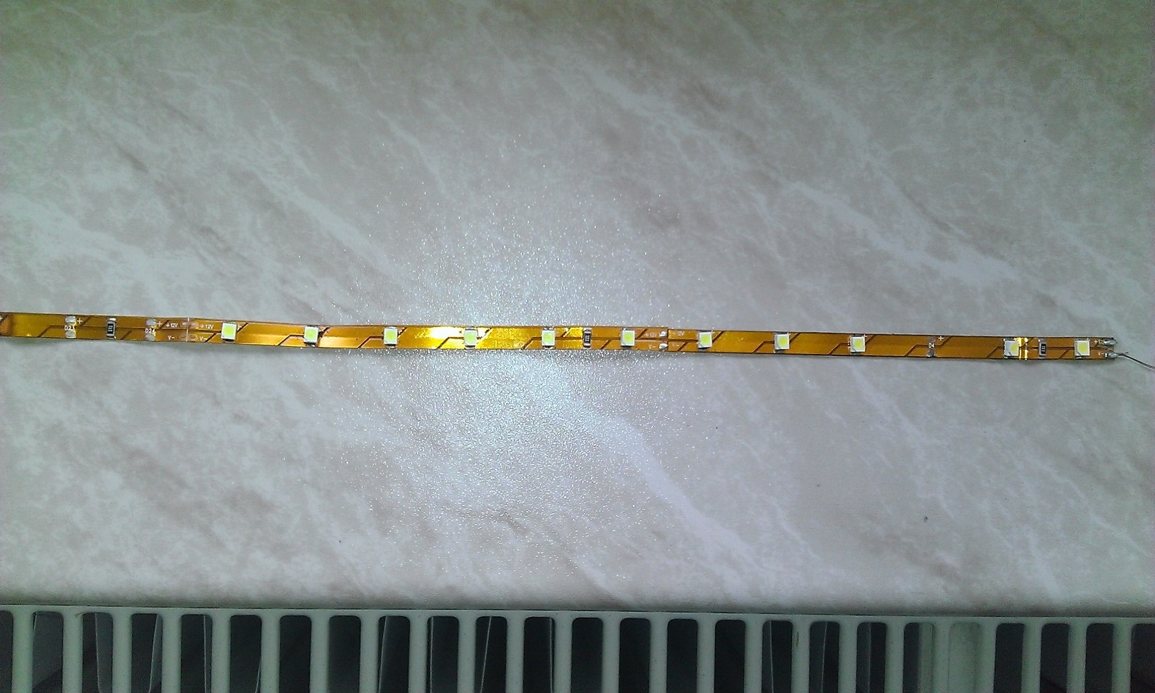

    I connected it as shown in the picture only to the 12V power supply, unfortunately it does not work, and it should, right?
  • #7 14568257
    alikatek
    Posts: 2517
    Help: 83
    Rate: 380
    Power polarity correct? It should glow, just dimly.

    Yes, correct polarity. the cable that protrudes I will give a plus and on the other tape I will give a minus

    OK, I need to get a 24V power supply and check. I thought 12V would pull it, but it will glow dimly. No resistor or regulator will be needed, because as the founder of the topic, I want to put these leds in the truck.
