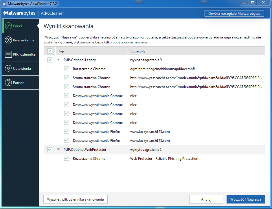

    Hi, the scan from AdwCleaner showed me 10 threats. When unfolded, it showed 9 is from PUP.Optional.Legacy and those 1 are from PUP.OptionalWebProtector. I cleaned with AdwCleaner, restarted the PC, and then shows these 10 threats. Thanks for the help in advance. Screenshots from FRST and AdwCleanera
    • PUP.Optional.Legacy and PUP.Optional.WebProtector - how to remove these threats? AdwCleaner.PNG (78.09 KB) You must be logged in to download this attachment.

    Otwórz notatnik i wklej zawartość:

    Plik zapisz pod nazwą fixlist.txt i umieść w folderze, gdzie masz FRST.exe.
    Uruchom FRST i kliknij w Fix/Napraw.

    After repairing and restarting the PC, I still get the same 10 threats as before: /
    • PUP.Optional.Legacy and PUP.Optional.WebProtector - how to remove these threats? ADW.PNG (70.25 KB) You must be logged in to download this attachment.

    Post the FRST logs again.

    Odinstaluj:
    AlphaGo
    BikaQ Rss
    McAfee Security Scan Plus
    McAfee True Key
    McAfee WebAdvisor
    Otwórz notatnik systemowy i wklej:

  • #13 17387544
    Lordo50PL
    Posts: 31
    Thanks for the help :D
    Added after 21 [minutes]:
    4 threats disappeared, 6 detected, here is a screenshot from AdwCleaner
    • PUP.Optional.Legacy and PUP.Optional.WebProtector - how to remove these threats? ADW.PNG (53.76 KB) You must be logged in to download this attachment.

    Manually remove these search engines in Chrome and Firefox and change to google.
  • #15 17387644
    Lordo50PL
    Posts: 31
    The only problem is that I do not have Chrome on my computer, and on Firefox I have Google as the default: /

    #17 17403326
    Kolobos
    IT specialist
    Posts: 85178
    Help: 17171
    Rate: 10455
    Odinstaluj AVG PC TuneUp 2015
    Usuwam profil Chrome skoro i tak go nie masz.
    W Firefox zmien AdBlock na uBlock Origin.
    Wykonaj Fixlist.txt dla FRST:

    If, after execution, adwc will still detect the search engine in FF, download bookmarks from Firefox and delete the browser profile directory.
