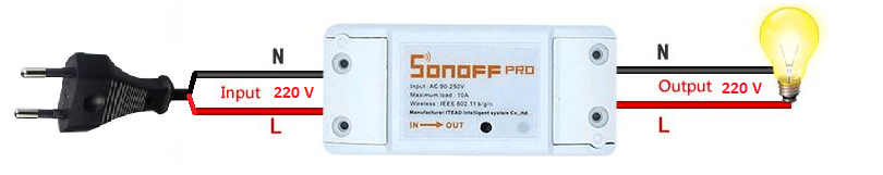

    We'll have to figure it out a bit :) Without any modifications, Sonoff Basic is used to control the 230V circuit, so you connect the input to a 230V socket, and the output to the computer power supply plug:
    Turn On Computer Remotely via Mobile Phone without Wake On LAN: Alternative Options

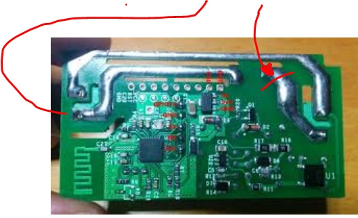

    However, we want to use the relay itself to turn on the power - so as to simulate turning on the power button on the computer housing. Therefore, we have to separate the relay contacts in Sonoff Basic from the 230v power supply. If you want to use the contacts of the power switch button (the one connected to the computer motherboard), cut the path on the board according to the marked red line and lead them to the contacts of the power switch:
    Then it will be safe to connect the controller with the computer.
