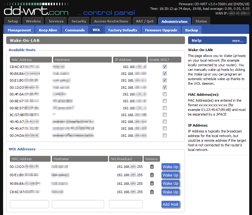

    In my experience, in this type of configurations, it only works when sending this packet from the router, because only then can it be a broadcast packet. It is not possible to send a broadcast packet addressed to the LAN over the Internet. The router will pass the unicast MagicPacket through the redirected port and direct it to the interface associated with the destination IP address (usually redirects), but as already noted, only until it has the IP address of this computer in its ARP table. In addition, a switch and its switching table are integrated into the router along the way. There, after some time, the MAC address of the turned off computer will expire.

    Not in ms, just in s... and that was the DHCP table. A static IP address reservation is not the same as a static ARP entry. The router sends the packet over the Ethernet interface, so it must wrap it with an Ethernet frame. To do this, it needs to know the destination MAC address, which corresponds to the target's IP address. For this purpose, it uses ARP - if communication with this host has already taken place, there is an appropriate entry in the ARP table, if not (or it has been inactive for a long time), then there is no entry. Thus, before sending the proper packet, an ARP request is broadcast for the MAC address of the host with the indicated IP address. Unfortunately, the computer is turned off and will not respond to such a query. Due to the lack of response, the router does not know how to address the Ethernet frame containing the Magic Packet. Does your router have the ability to remotely log in to its configuration panel (under the external IP and on the indicated port)? If so, is it possible to initiate WOL from the configuration panel? In DD-WRT it looks like this:
    Remotely turning on the computer (wake on lan) does not work after changing loca
    After thinking about the matter, the only problem may be the ARP of the router, because the MAC table of the switch will also expire, but here it will manifest itself in sending the frame through all interfaces.

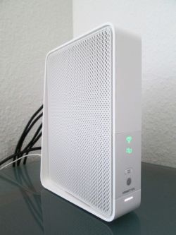

    On what equipment does UPC work there - modem and its own router or modemorouter, is there no IPv6 enabled there?

    The modem router and the computer is connected directly to it with a cable. This is a Compal router, as someone wrote above. I have now found a model on the forum that may be Compal CH7465LG-LC. In UPC it is called "Connect Box". The look is right. At the input there is a coax with a signal from them, at the output there are four ethernet ports and two telephone ports. It is possible that IPv6 is enabled. In the console after typing "ipconfig /all", if I remember correctly, there was also some address in this line. Modem settings are default, the ones I modified are described above. I found the user manual, which I put in the attachment, you can see the individual settings screens there.
    Call UPC what they would turn off if IPv6 is unnecessary.
    As such, the external IP is only there on the modem router and not on the specific client end device:
    - it is not possible to use WOL from the outside (from the Internet) - no possibility to redirect traffic from the WAN to the Broadcast address of the LAN
    - no access from the outside (from the Internet) to the router configuration page - although there is an option to enable it - a parental lock message pops up.
    Compal's bridge mode (but only IPv4) and your own router with WOL support may help here.
