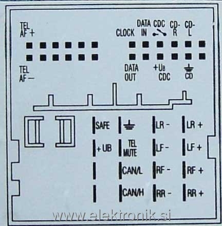

    Hello, I have a problem, I bought an aux cable for the rcd 300 radio, but after connecting it does not see my aux at all radio rcd 300 below I will give a photo of the pins Golf Mk5 RCD 300 AUX Problem: Radio not detecting AUX cable - RCD300 Photos & Pins Golf Mk5 RCD 300 AUX Problem: Radio not detecting AUX cable - RCD300 Photos & Pins
    • Golf Mk5 RCD 300 AUX Problem: Radio not detecting AUX cable - RCD300 Photos & Pins t_rcd300_pinout.jpg (60.69 KB) You must be logged in to download this attachment.

    Maybe you can write what this cable is, paste its photos.
    Here you need a changer emulator.

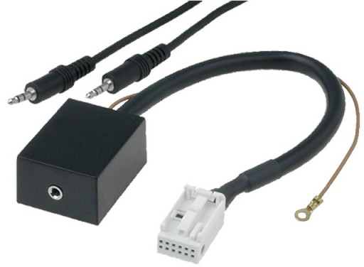

    It is a cable from aliexpress
    • Golf Mk5 RCD 300 AUX Problem: Radio not detecting AUX cable - RCD300 Photos & Pins VW-RCD510-HONGGE-RCD310-RCD300-RNS315-NOWY-Prze-cznik-AUX-Wtyk-kabel-Do-VW-Golf-Jetta.jpg_640x640.jpg (68.91 KB) You must be logged in to download this attachment.

    Do you wonder how the plug looks? How much did that "something" cost - $ 2?
    Google the graphics - RCD300 aux and RCD300 changer emulator - everything will be clear.

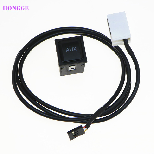

    Or something like that because I do not know if it pays to pay for such an emulator 200+ .. This one is for less than 100 PLN
    • Golf Mk5 RCD 300 AUX Problem: Radio not detecting AUX cable - RCD300 Photos & Pins cdaf48ae43cb994f6a3c27e06f09.jpeg (25.32 KB) You must be logged in to download this attachment.

    You need to activate the aux input on the radio, no cable and you won't do it. I have exactly the same in rcd500
    Nonsense.
    There is no auxiliary in this version of the RCD 300.

    Change to rcd310 and it works
