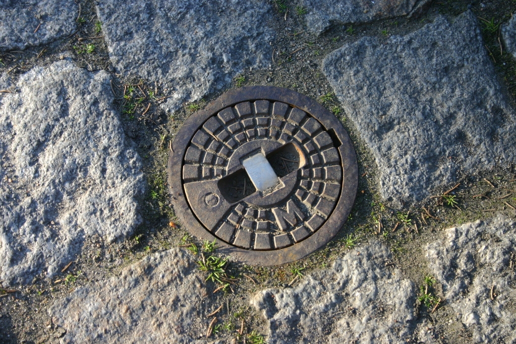

    I have to close the water for the winter on the plot.
    I have such a valve.
    Closing Water Valve Issue: Winterizing Plot, Valve Fails to Close, Ad Hoc Solutions Needed
    Unfortunately, water continues to flow after it is closed. How to deal with it ad hoc, can you tighten something?

    If it's water, you won't do anything, wait until the water is turned off on the main valve and then replace it with a ball valve.

    No tightening will work. The valve head has worn out (the gasket has broken) and needs to be replaced, but to do so, turn off the water on the connection.
    With this pipe diameter, it is impossible to do it under pressure - I tried. :)
    The visible nut is only used to replace / tighten the seals when the valve leaks.
    Look on the plot, maybe you have a sump somewhere with the main valve.

    So when they turn off the water, I have to unscrew the entire head and screw in a new one?
    How do I get rid of the water in the gazebo from the tap, toilet and boiler pipes?

    If the head is in decent condition, you can replace the gasket but it's better to put the whole head on a new one if you don't want to fix it in a moment.
    How can I get rid of the water? In the past, plumbers installed a tap on such a valve just so that the water could be drained from the installation. If someone makes an ill-considered installation, then there are such flowers.

    "Blow out" with a compressor when you are "renovating" the valve.

    Ask at the allotment garden management board and they should help in this matter, or explain when the main valve will be closed and when it will be possible to repair or modify it.
